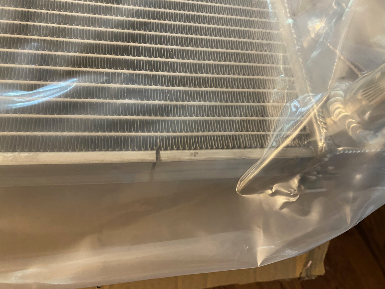

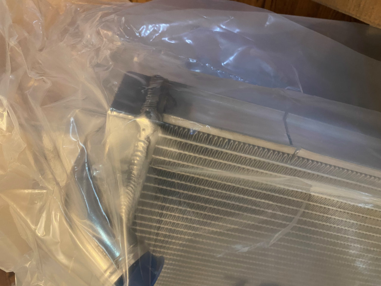

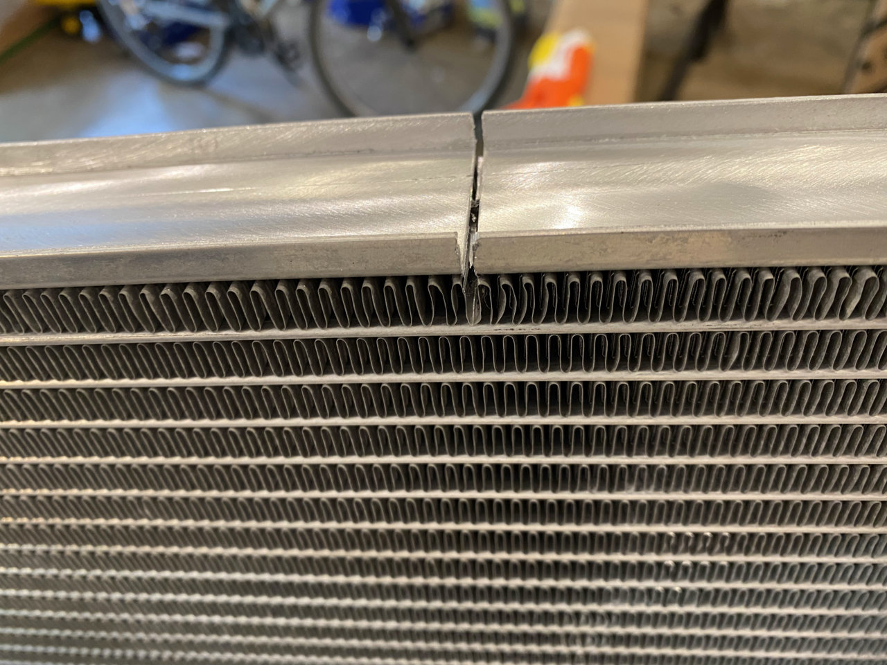

    The only full aluminum performance radiator I could find for the JL/JT is by Cold Case, which is somewhat understandable being the platform is relatively new. After the high temps wheeling, I ordered one. After I started to tear the truck apart for install, I double checked the radiator. It appeared to have the main horizontal supports cut through on both top and bottom.
    Annoyed. It appeared someone had done some hack experimenting and returned a butchered radiator and Cold Case didn't check it before reselling. @memario1214 was awesome in working with Cold Case to get a new unit sent out.
    The new unit:
    Looks like Cold Case has some serious QC issues.

    Nothing like cutting out the primary support structures of the radiator so you rely on your cooling B-tubes to hold the thing together. It will expand and flex alright, awesome for chassis flex on the trail. Great way to fastback that head gasket mod.

    Cold Case claims cutting the primary supports for the radiator is a new design improvement to prevent cracking and that there should have been documentation included with the radiator documenting the design "enhancement". :crazy:
    I'll have to check with CSF and Mishimoto on if they have JL/JT units in the pipeline. Mishimoto and CSF both have them for other Jeep Wrangler models, so it seems highly likely.

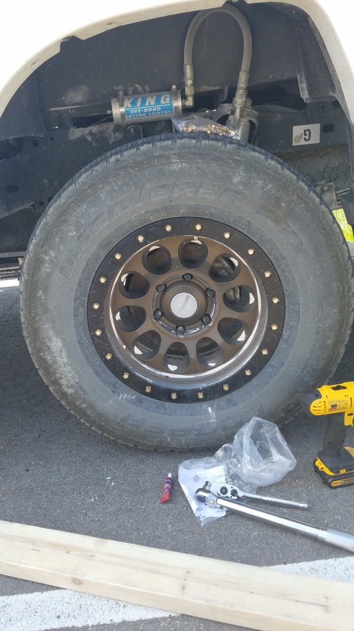

    I think those wheels look killer. Probably unlike most folks, I think the best part is that they're not black. I am so done with black wheels! Can't wait to see what they look like with tires on the Jeep!
