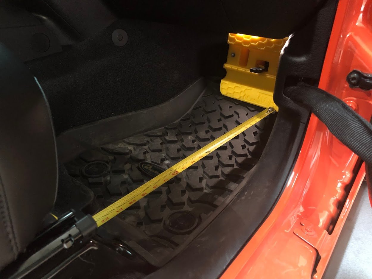

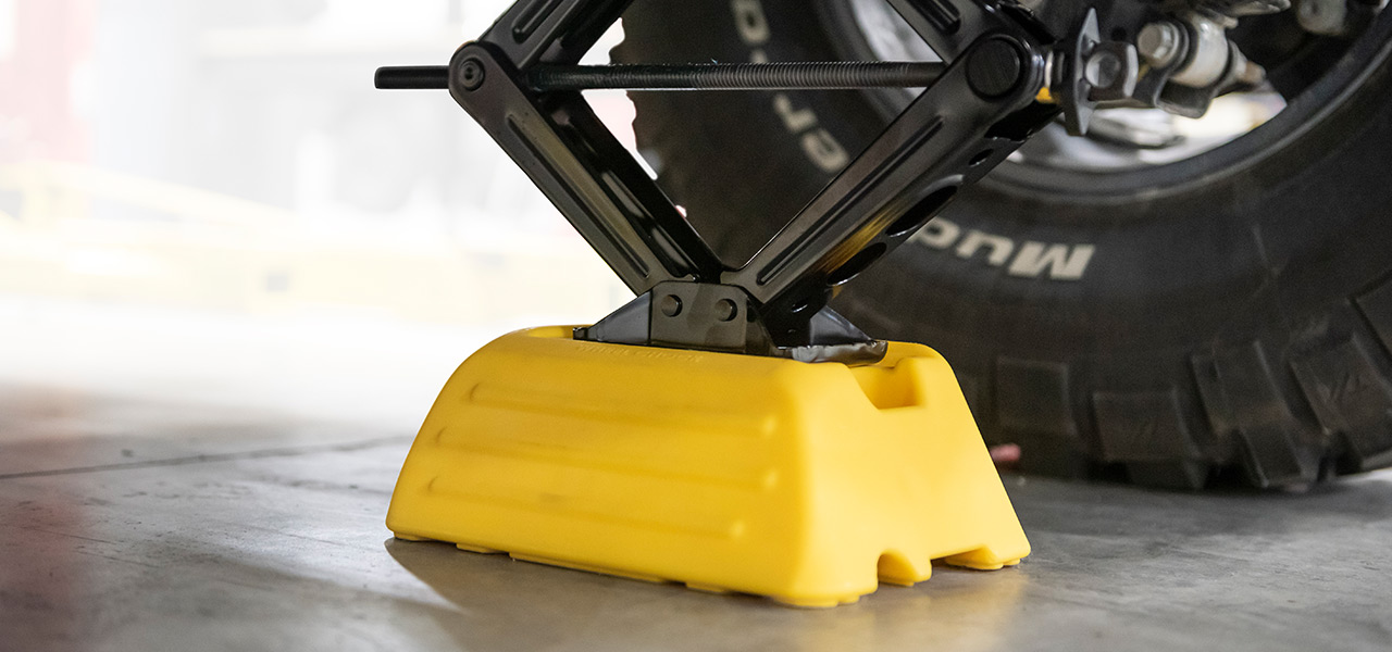

    With 37s, the OEM jack will no longer be sufficient. It barely cut it on the 35s when I punctured a tire on the trail and we had to dig out under the tire to get clearance to install the fully inflated spare, not exactly something you can do on the street. Jeep/Mopar and AEV both make scissor jack bases which seems like the ideal solution. I'm not interested in a highlift. AEV's spacer will work for up to 37s, the Jeep spacer can work for even larger tires, but is also larger in size. These bases are not small, the AEV unit measures 10.5"x7.5"x3.5", and the Jeep unit is about 1" larger in every direction. Storage is a concern, as there isn't much of it in a Jeep. Since I don't plan on larger than 37s, the smaller AEV unit seems more ideal.
    AEV base

    Would a HF jack + pro eagle extension be a solution? That looks awfully compact which is nice, but those scissor jacks always make me nervous.

    Apparently you've never used an OEM bottle jack like the one that came with my 4Runner. Changing a tire on anything other than a perfectly flat parking lot is an exercise in blind faith.

    Floor jacks are definitely nice to use, but not something I’d want to carry in the truck with me at all times. Wrangler/Gladiators have solid axles, so using the axle housing as the jack point there is no need for an extension on a floor jack unlike IFS.
    That sir is simplistic genius, if it fits.

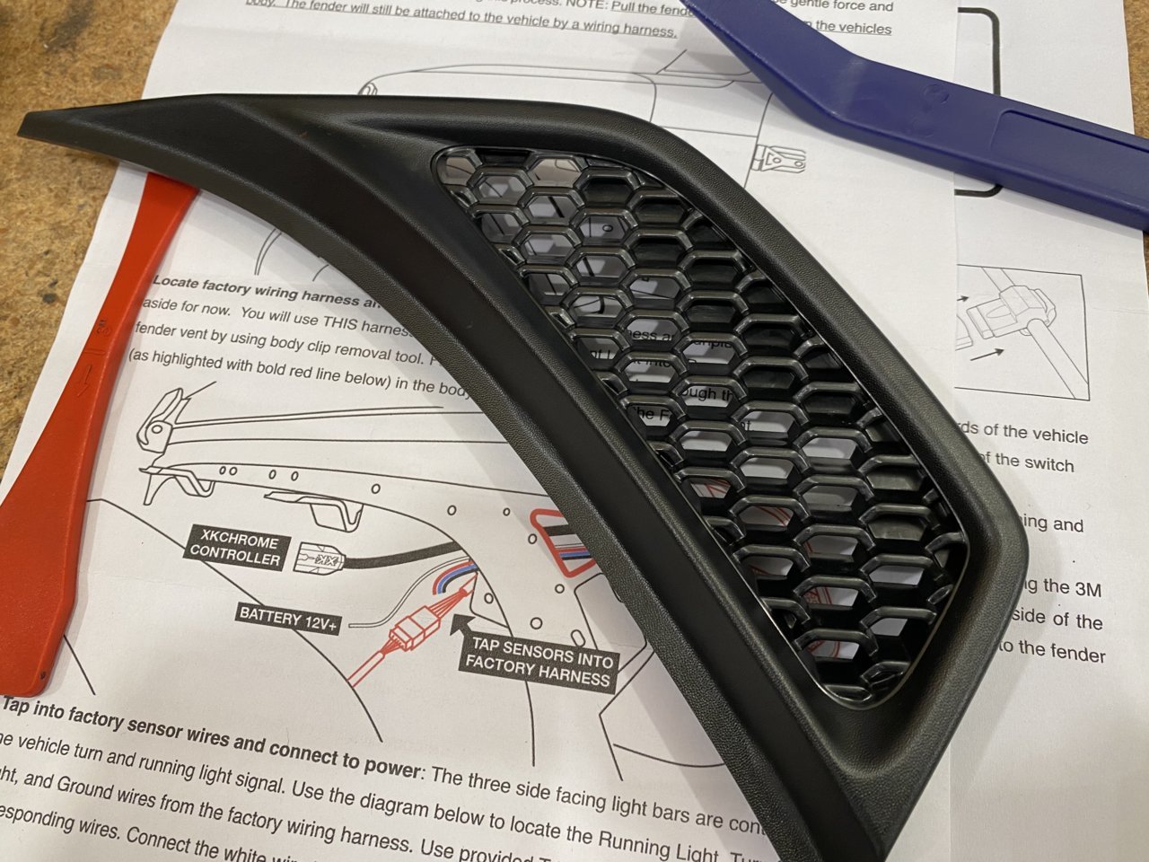

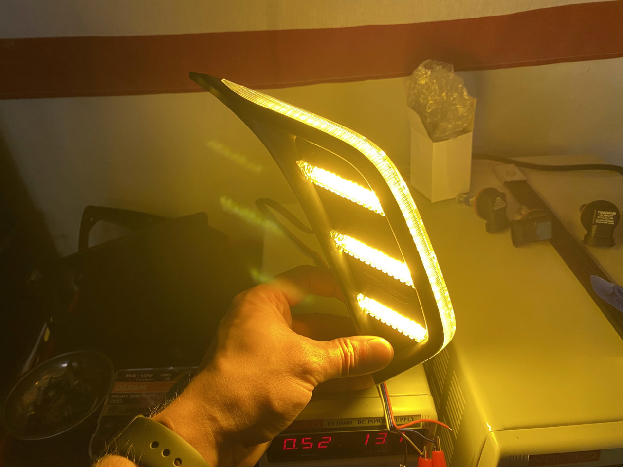

    My 3rd fender vent light tested. This XK Glow Amber unit is supposed to be "amber". It is very yellow. Sigh.
    What is also interesting is recall how the fender vent I removed was surprisingly a functional vent?
    Turns out these vents are designed to eliminate hood flutter at high speed, a problem that existed on the JKs. So by eliminating the vents with lights, I'd likely be reintroducing the hood flutter issue these are designed to fix. With 440+hp my truck sees plenty of high speed. Needless to say with the existing low quality products on the market and eliminating an OEM engineered solution to a real design problem, I am scraping this idea.

    Rip to the hours of work we did trying to get the lights to work

    And hacking up the OEM wiring. I’ve got one more possibility to explore which would retain the vent. We’ll see.
