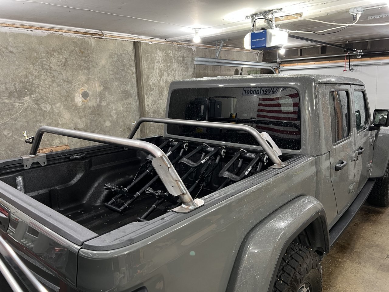

    The very first set of Gladiator Bed bars on the market from @RelentlessFab
    My thoughts on why bed bars are superior to full racks can be found below. I ran Relentless bed bars on my Tacoma as well as my preferred design.
    https://www.tacomaworld.com/threads...-upgrades-and-mounting-recomendations.680321/
    Looking forward to using my RTT again. I’ll get these to my powder coater with some other parts I have in the queue. I painted my last set and the paint was not as durable as I would have liked.

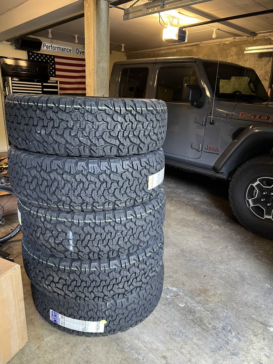

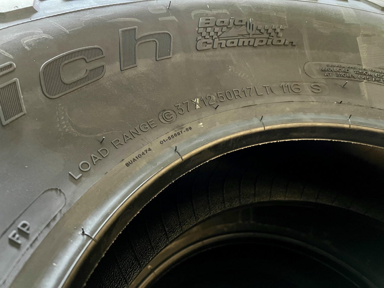

    Tires have finally arrived!
    Possibly, but cannot say for sure. The OEM wheel is under spec at 7.5" wide when the tires specify 8.5" minimum. I'm going to run them on an 8" wide wheel, with only 7.17mm less offset than the Mojave wheels (+30 vs +37.17). I suspect the first contact point will be the lower control arm at lock if they do rub. If so there are aftermarket control arms with a greater bend in the arm for greater clearance with larger tires that may solve the issue. The Vision Flow 351 wheels I chose are very reasonably priced and lighter than stock while also moving the offset and width in a slightly better direction for the tire.

    I don't mean to bring up the wheel debacle considering what you've been through to get to this point, but will 8" be alright at speed if 8.5" is the spec?

    LOL! Wheel debacle was a PITA. I wasn't even sure if I'd get refunds from some of those foreign entities, but it all worked out eventually.
    With all things engineering there is a safety factor built into the spec (from reputable companies). I wasn't thrilled about running a 7.5" wide wheel on an 8.5" wide min wheel spec for the tire as that is effectively 2 sizes off spec, but an 8" wheel is just one size off spec. The difference is 1/4" more pull in per sidewall, over the course of a 10" sidewall. There is always risk running outside of spec, but I am not concerned with this mild difference. For reference the 2022 Ford Raptor runs these tires on the min spec 17x8.5" OEM wheel.

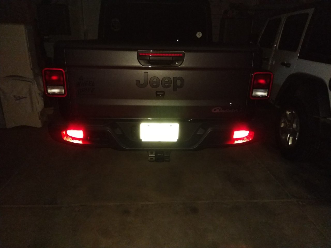

    Recently drove some windy mountain highways with horrible visibility in the 'bomb cyclone' weather event over the weekend. Couldn't see a damn thing and vehicles just ahead of me would disappear in the wall of water and mist. That was until there was a Range Rover with OEM rear fogs. Couldn't see his tail lights at all, but his rear fogs made him highly visible where others would disappear. This made me step back and reconsider, I've always been so focused on seeing, have I focused enough on being seen in those conditions? I thought I might have to invent the wheel here to add rear fogs, but turns out it is an OEM Euro spec option that can be retrofitted to USA trucks. This is now on the to-do list.
    PNs:
    68338390AA
    68338391AA
    Euro rear fogs installed on a US truck
    Lots of info here:
    https://www.jeepgladiatorforum.com/forum/threads/what-plug-would-plug-in-to-this.28684/

    That's cool the OEM euro housings fit. $40 for a plug.
    :censored:
    It'll be well worth it though for visibility.

    I always liked the rear facing fog concept. I'm seriously considering something like that for the new 4Runner. It has LED tail / stop lights that I'm very concerned will get totally snow covered in certain winter conditions that occur relatively often up here. (Blowing snow on expressways.) What I'm currently considering is some sort of red LED pod (2 of them) mounted inside the vehicle behind a portion of the rear window covered by the defroster grid. This would prevent them from falling victim to the same snow cover as the tail lights. Still working on options though.

    this is awesome. Any idea what could do the same for a Tacoma?

    The Tacoma, being a North American only product, doesn't have a nice easy bolt in solution. Newer Hilux models have the fog light integrated into the tail light assembly, so that won't help here as the lamps are different. Older Hilux models have a separate unit that mounts flush low down in the bumper... it's the old style fluted lens with a plain old 21W hot tail lamp bulb. Still far from bolt in, but I have a box of them, so eventually I'll mange to mount one on my truck.
