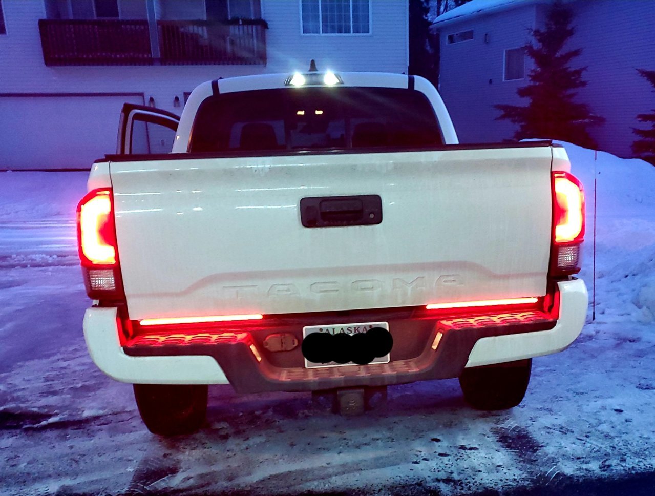

    I had thought about this at one point. I was thinking of putting parking assist bumper cap on with a red LED in the sensor hole. Only an idea, did zero research as to brightness or dimensions.
    EDIT: adding a cool rear fog pic I saw on here a while back.

    I’d think you would want something with a larger illuminated surface area for better visibility.

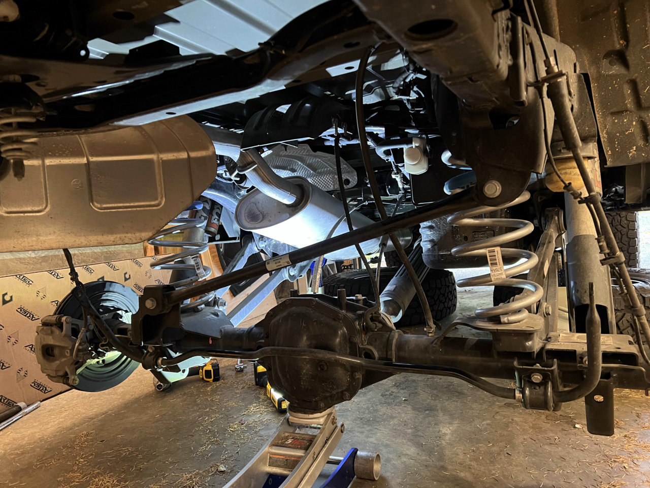

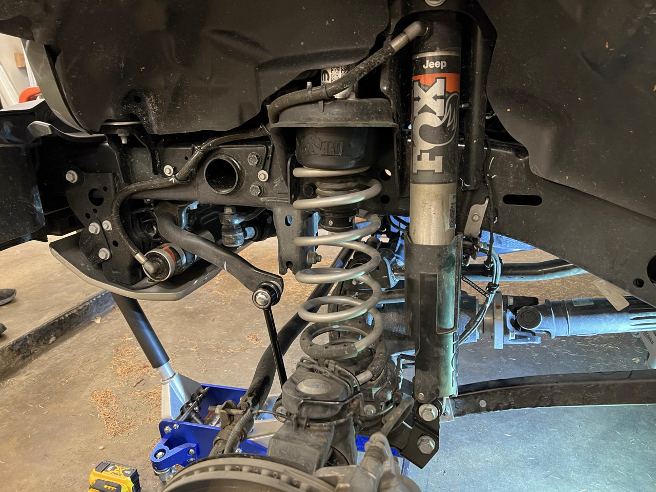

    Got most of the AEV 2" lift on Sunday afternoon and this afternoon. Instructions can be found here.

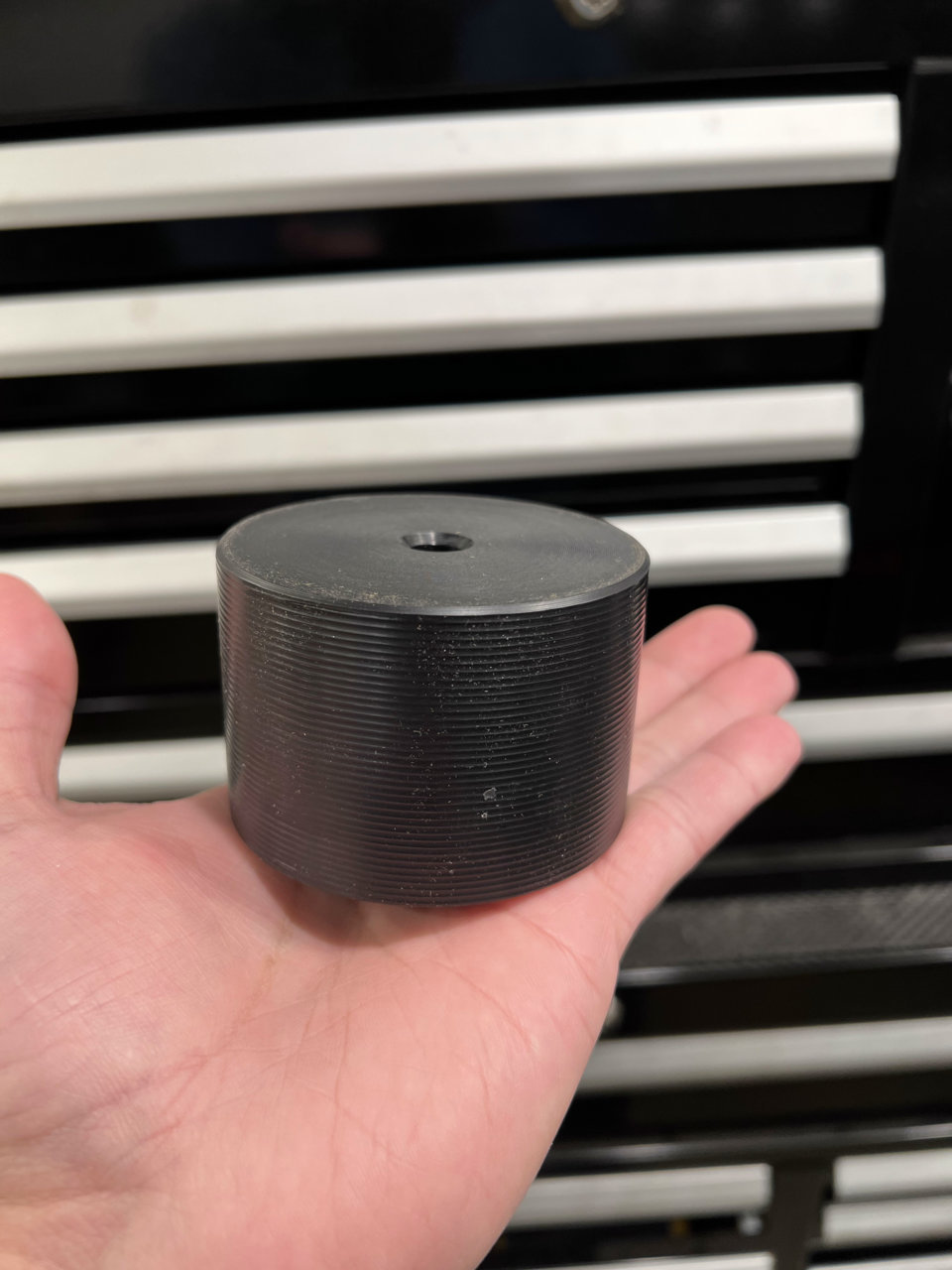

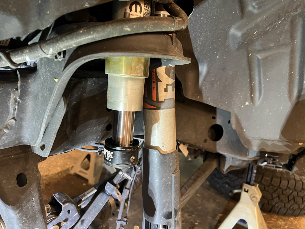

    A closer look at the OEM Fox jounce bumpers which had to have their boots removed for the spacer/isolator install. These are an industry first on a production vehicle with the Mojave. Interestingly the boots were zip tied at the bottom but not the top, and had a notable amount of water in them despite having drain holes. I added zip ties at the top to hopefully mitigate the water intrusion.
    Front end install done with the 2" spacer/isolator, the 2" extended swap bar links and 2" shock extension.
    Except... not the 2" jounce bumper extension, which I realized while falling asleep that night.
    So I get to do the front end all over again. F words. Though it isn't urgent for street use.
    Did the rear solo today, under a very fixed timeline that the truck had to be operational by. It would be really helpful on multiple parts of the install to have 2 people. Trying to push down on the axle to get the springs back in with the 2" extended spacer/isolators was a PITA to do solo, while also trying to align the alignment pins in the spacer to the frame mount.
    Rear setup complete with 2" spring spacer/isolators (behind frame rail), 2" bump stop extension plates, 2" shock extensions and 2" extended swaybar links. The front was all plug and play, the rears required minor drilling to enlarge holes for the bump stop plate mounts, and drilling a new hole for the shock extension bracket.
    35s now look a little small.
    I still need to do the adjustable trackbars and then the carrier bearing drop kit.
    New lighter weight Vision 351 17x8 wheels + the 37" light weight OEM Raptor KO2s will likely go on Thursday.
    Now that the lift is on, the high clearance full aluminum skids can be installed.
    https://www.artecindustries.com/jtskidplate-al36
    Thanks @Kidwidataco for the hand on Sunday.

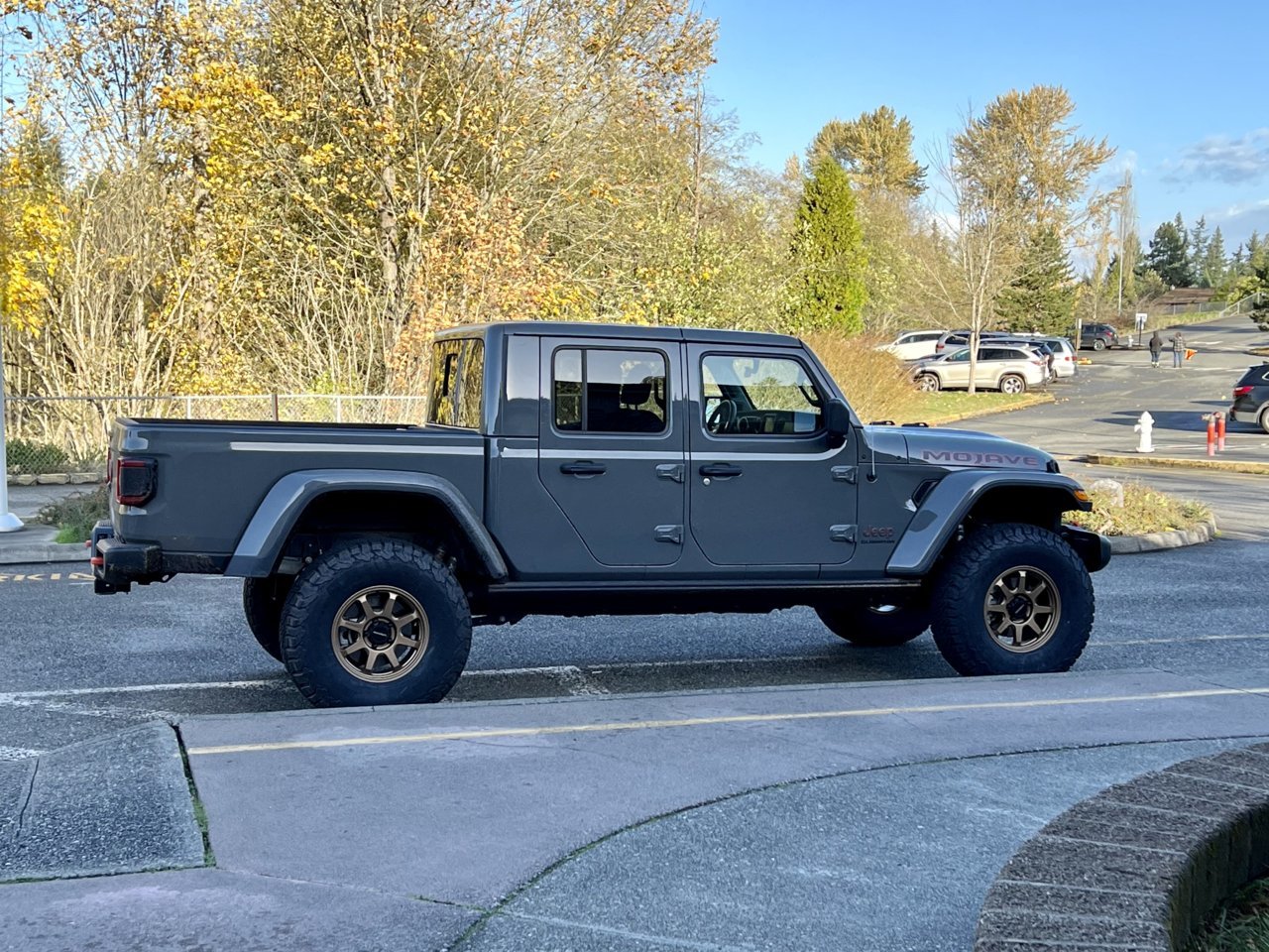

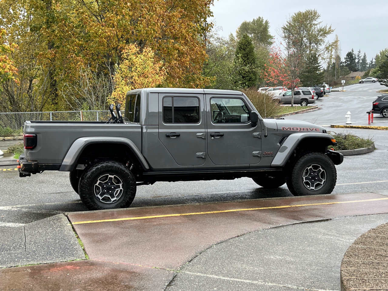

    Not the best pic, but it’s now dark.
    The new KO2 37s with the AEV 2” lift.
    No rubbing on the street with the Vision Flow 351 17x8 +30 and 37x12.5” KO2s.

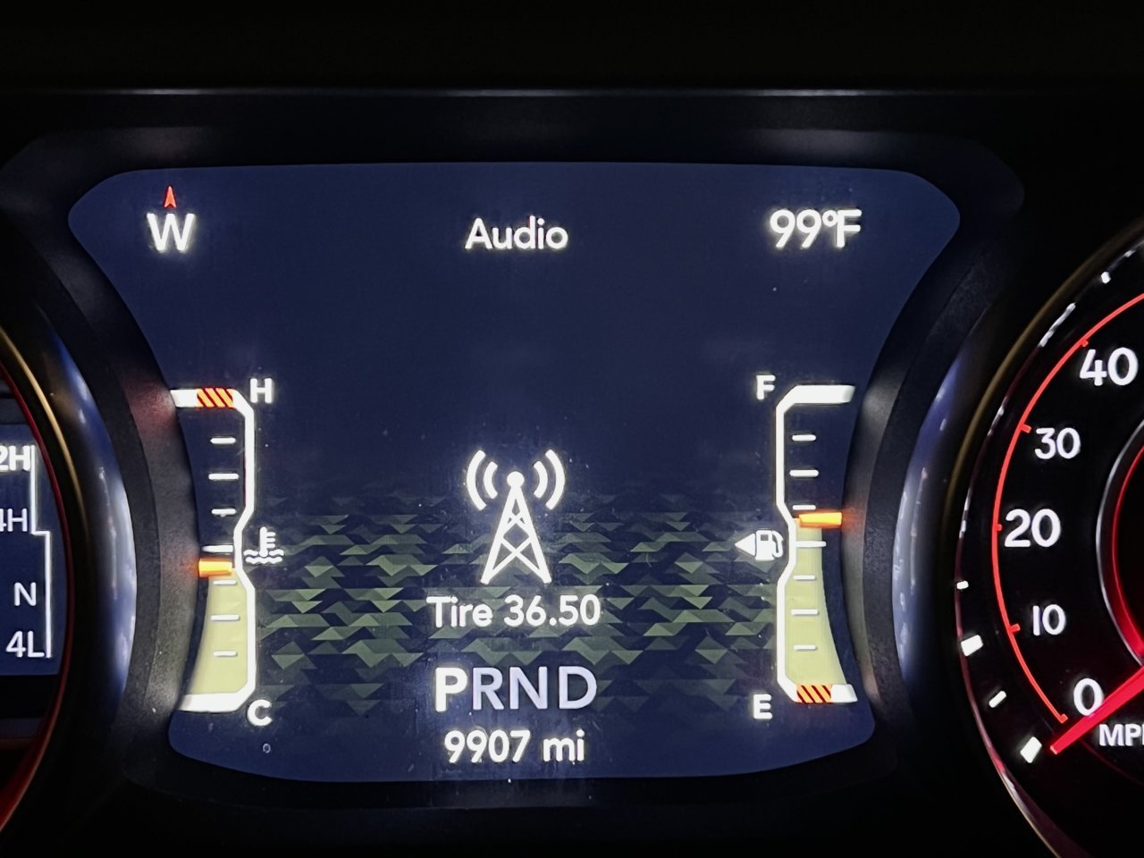

    The JL mini programmer makes changing tire size in the ECU simple, using the steering wheel controls. 37 KO2 is 36.5” actual according to BFG. So:

    Does the same thing for gear ratios, so it will be simple to correct when moving to 4.56.

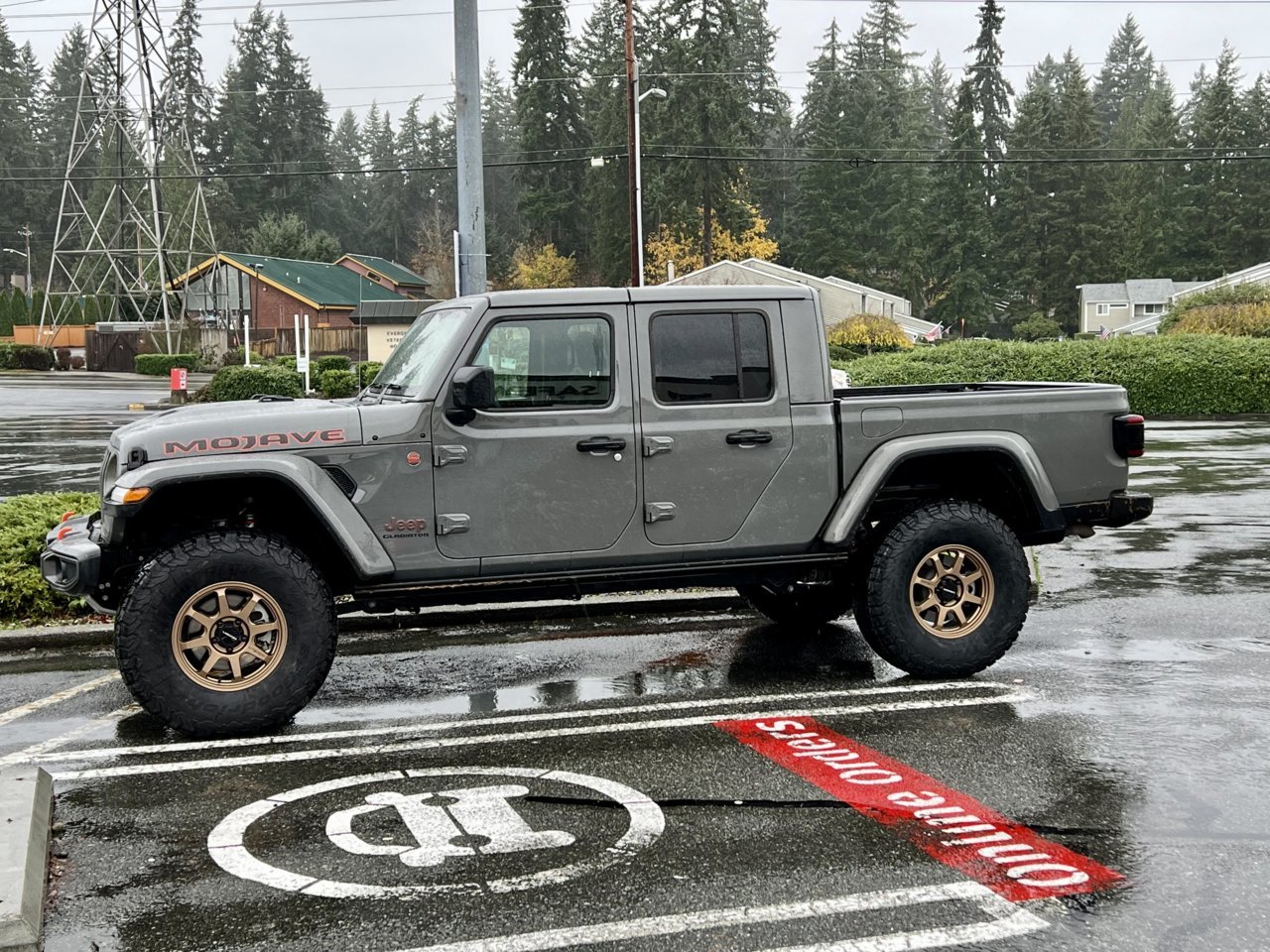

    Another pic on 37s
