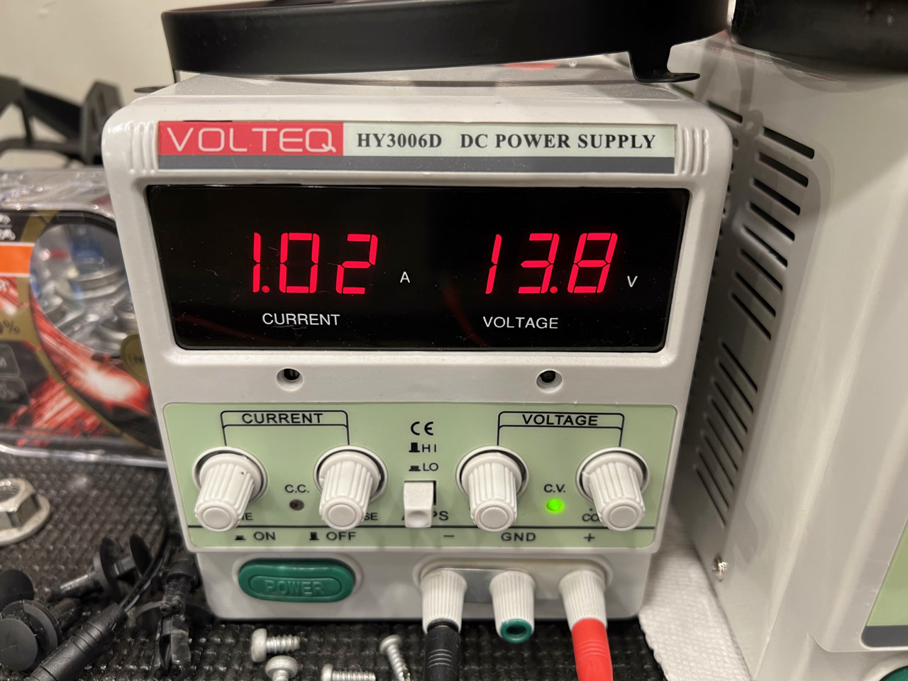

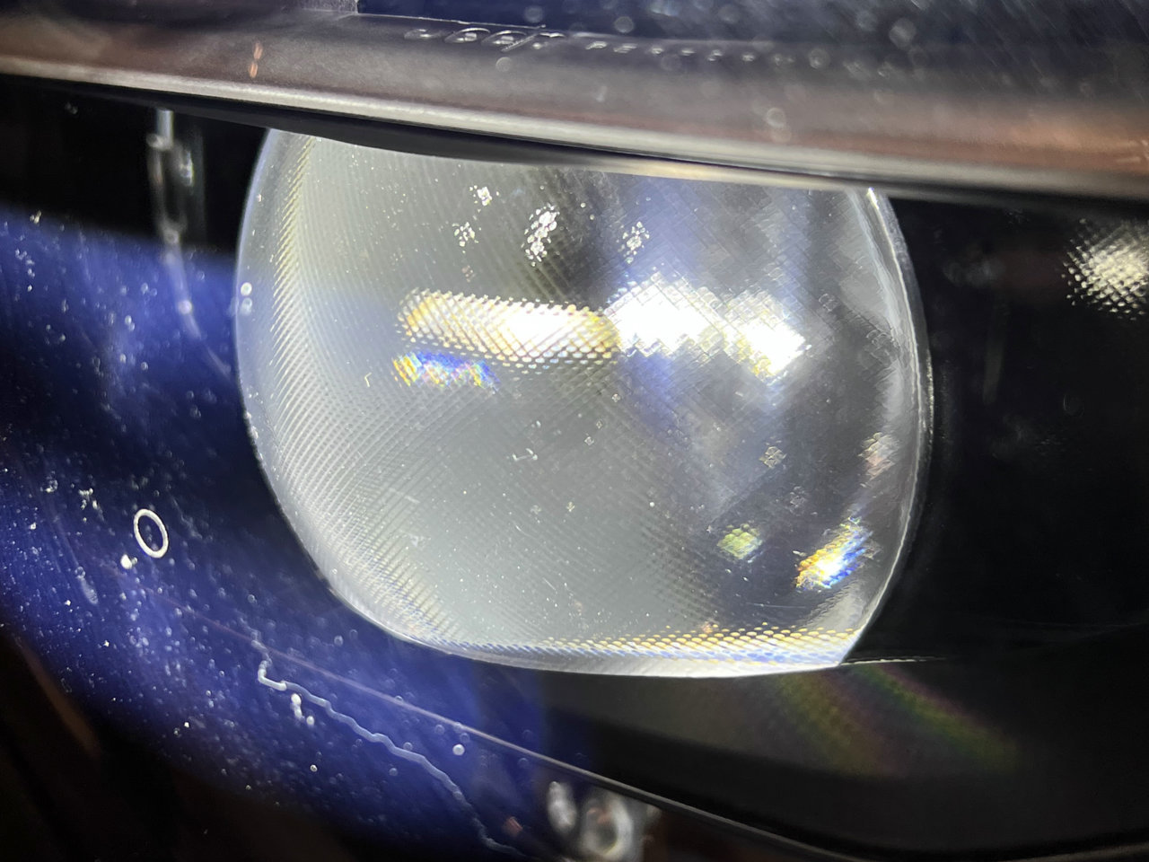

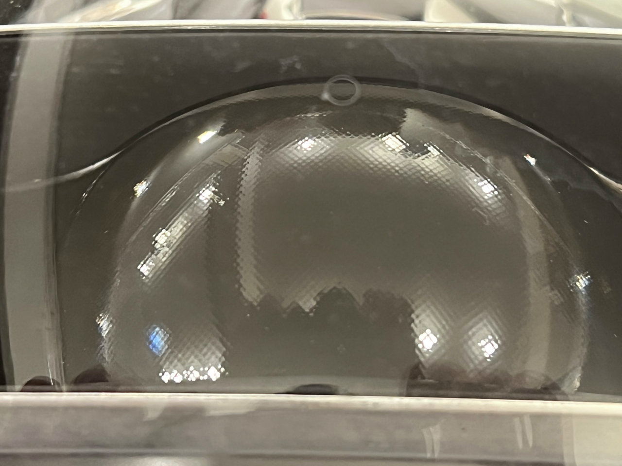

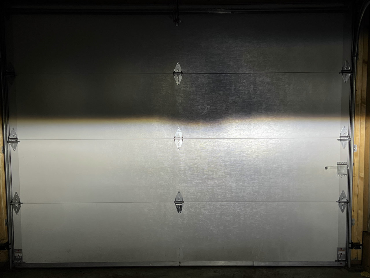

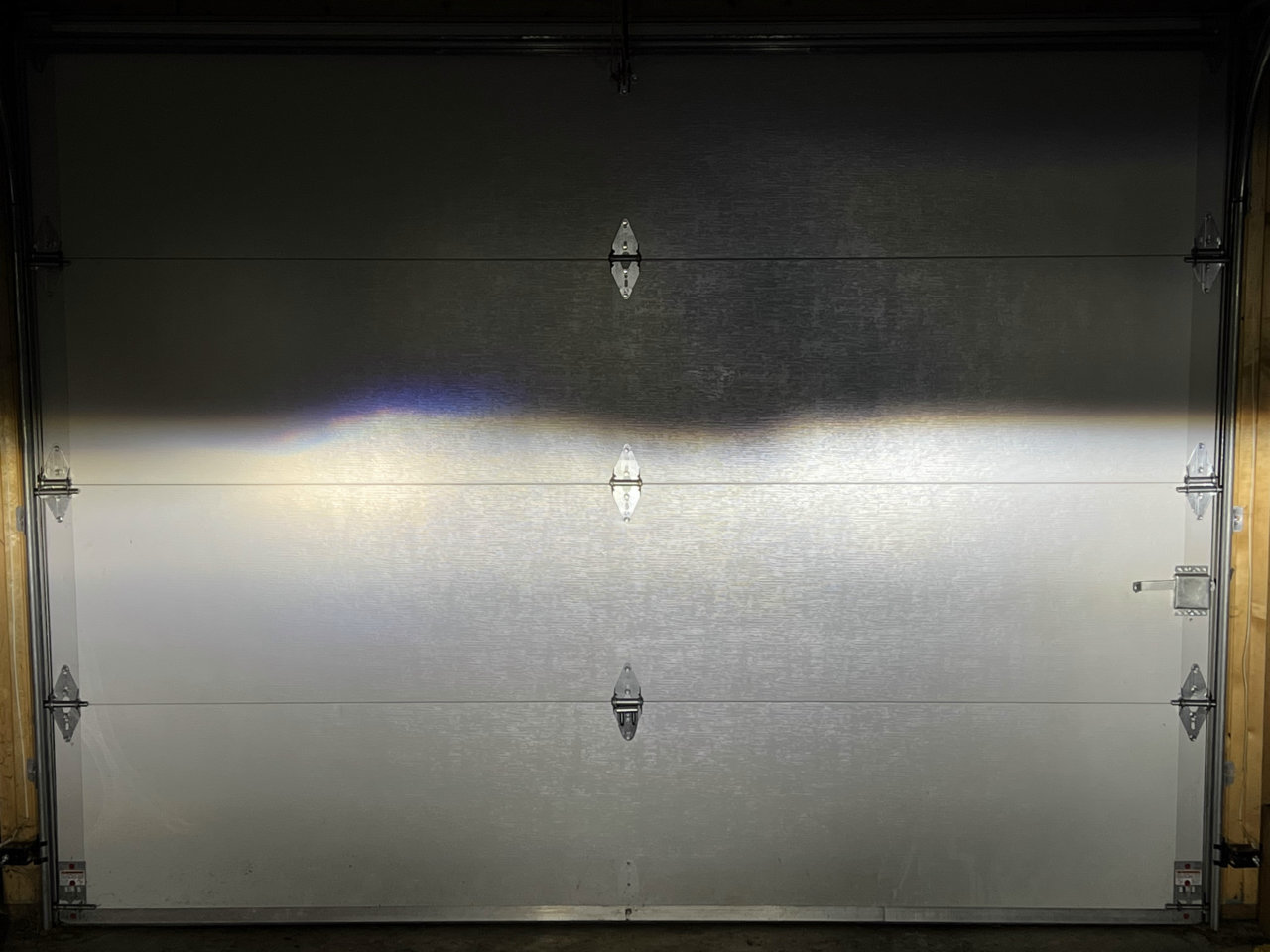

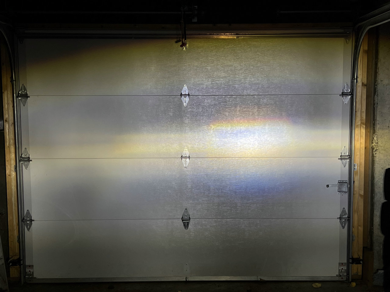

    Spent some more time tonight looking at the headlights and had some interesting realizations.
    The OEM headlights are glare offenders, this is known. But looking at why, FCA placed a diffused optic on the entire low beam projector. Facepalm. A diffused optic is certainly going to create more uplight/glare, but covering the entire optic seems like a strange design decision.
    Look how Toyota only added diffusing for uplight on the upper part of the projector on the OEM LED 4runner units and also avoided interrupting the hot spot.
    JW J2 vs OEM LED
    Side-by-side makes it look like the JW speaker product is superior. Except that diffused optic does such a wide intensity spread that much of the light shown on the left is actually the OEM LED.
    Single OEM LED only
    Vs single JW J2

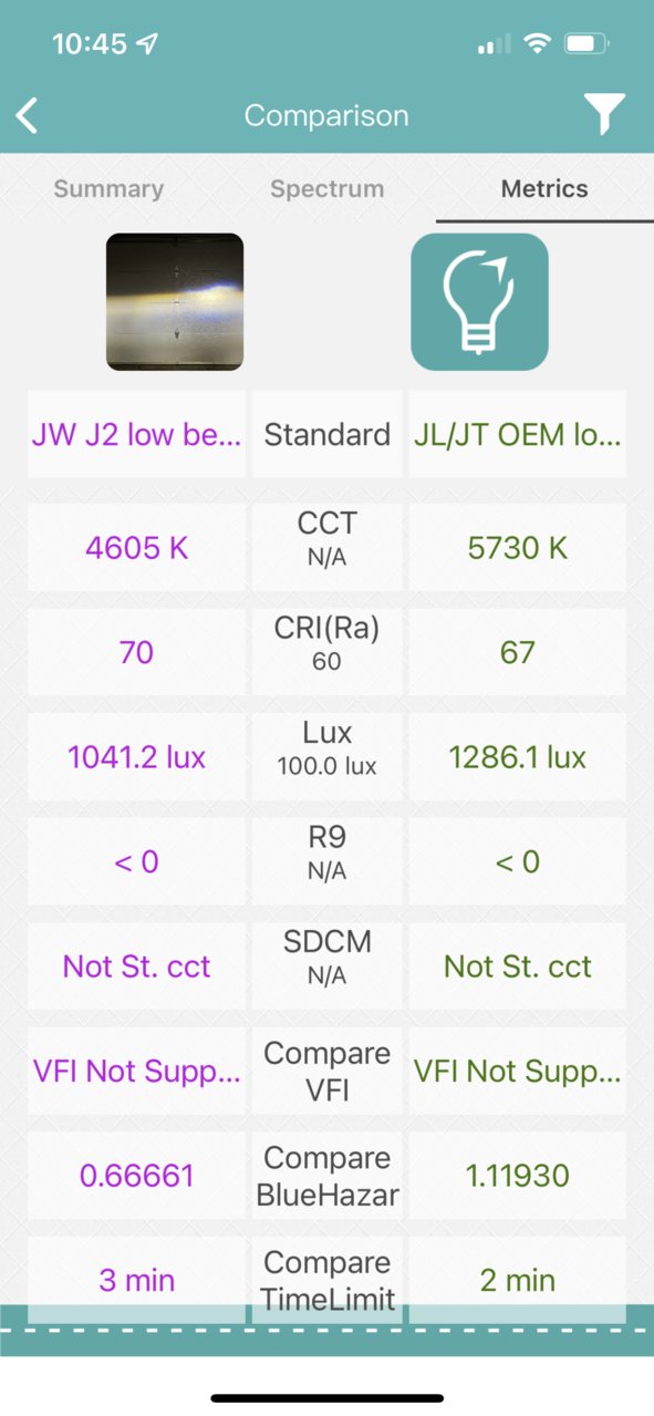

    Low beam intensity comparison
    OEM LEDs are about ~23.5% higher in peak output intensity than the JW J2s, and the J2s are significantly better than the JW J3s. While peak output intensity is critically important, it doesn't tell the whole story. The JW J2s have significantly better color temp at 4600k, while also being heated and higher CRI. However the OEM LEDs have fuller pattern coverage with far better light distribution throughout the pattern, whereas the focused J2s peak intensity somewhat masks that they don't offer nearly as much light throughout the pattern.
    Looks like I forgot the OEM high beam pic, but it has a very high intensity hot spot above the low beam cut off with a general flood light around that in the pattern Very much like the OEM Tacoma LED headlights. The J2 on the other hand has a more focused down range high beam without the wide spread flood function, more similar to Morimoto.
    JW J2 high beam
    The OEM LED high beam has about 24% higher output intensity than the JW J2s.
    OEM LED vs JW J2s
    Glare pics are always somewhat challenging. But the OEM LED was definitely painful to look at even being above the cut off, while the JW Speaker lights had a much better cut off combined with the lower color temp made them not offensive in the slightest. That diffused optic on the Jeep projector is an eye burner for oncoming traffic.

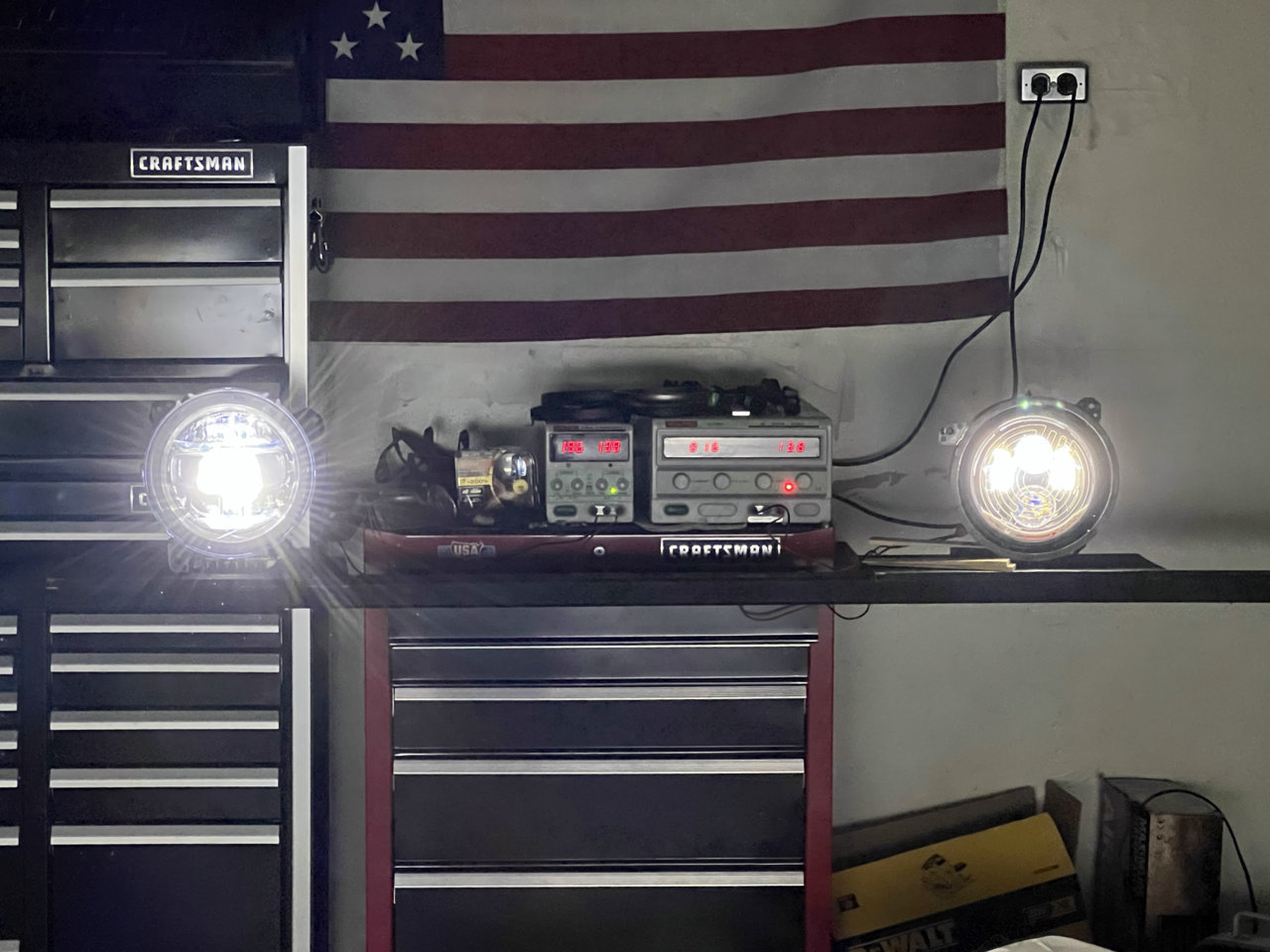

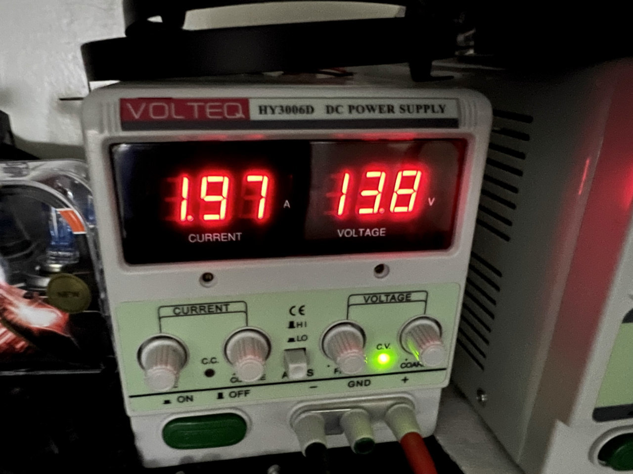

    Jeep OEM LED stable low beam, ambient temp of 64 degrees F.
    High beam draw (initial)
    The OEM headlights are great in some regards and poor in others. While JW Speaker products offer improvements in some areas, it is at the cost of compromises in others.

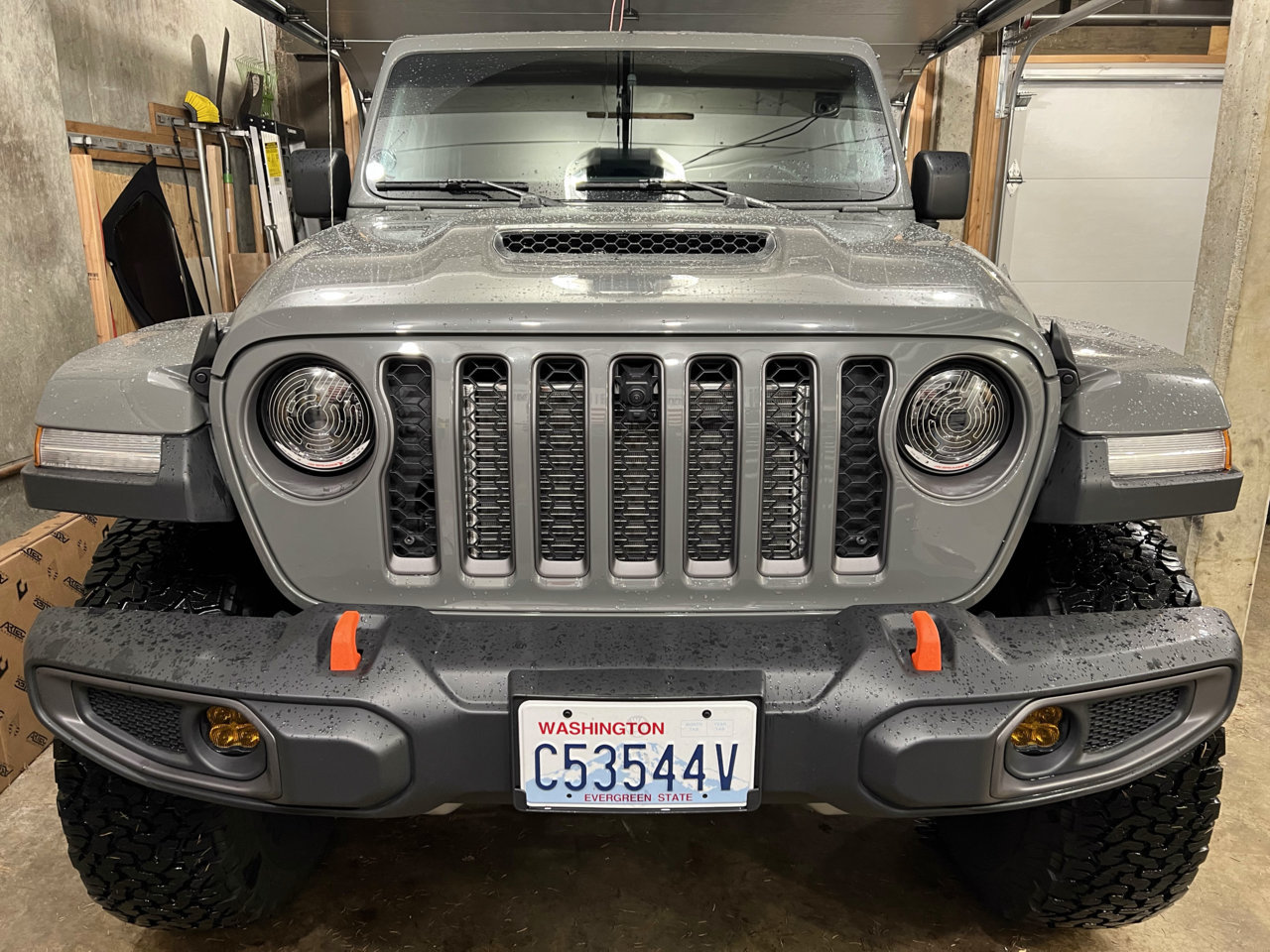

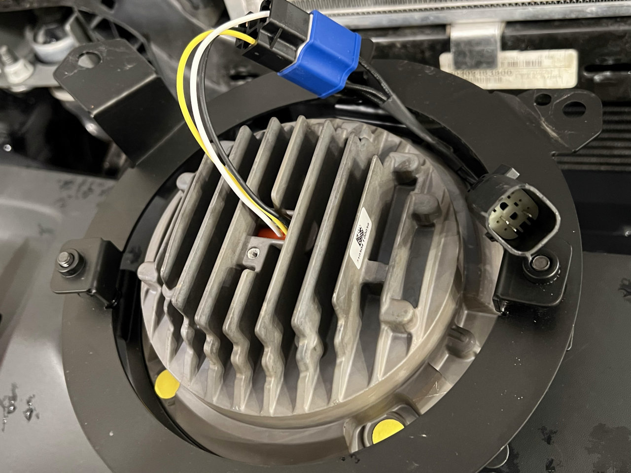

    2 weeks ago I posted about a terrifying experience losing my OEM LED headlights to heavy snow fall as they froze over and packed with snow on one of the most deadly 2 lane unlit mountain pass highways in the state at night. Only my Diode Dynamics SS3 Max fogs were able to clear the heavy snow and provide life saving limited visibility lighting.
    Never again will I put myself in that position. Never again will I run unheated LED headlights in extreme winter conditions. Freshly installed Heated JW Speaker J2s, ready for a long weekend high of 25 F and lows of 11 F. Bring it on.
    J2 H4 to JL adapters for PnP
