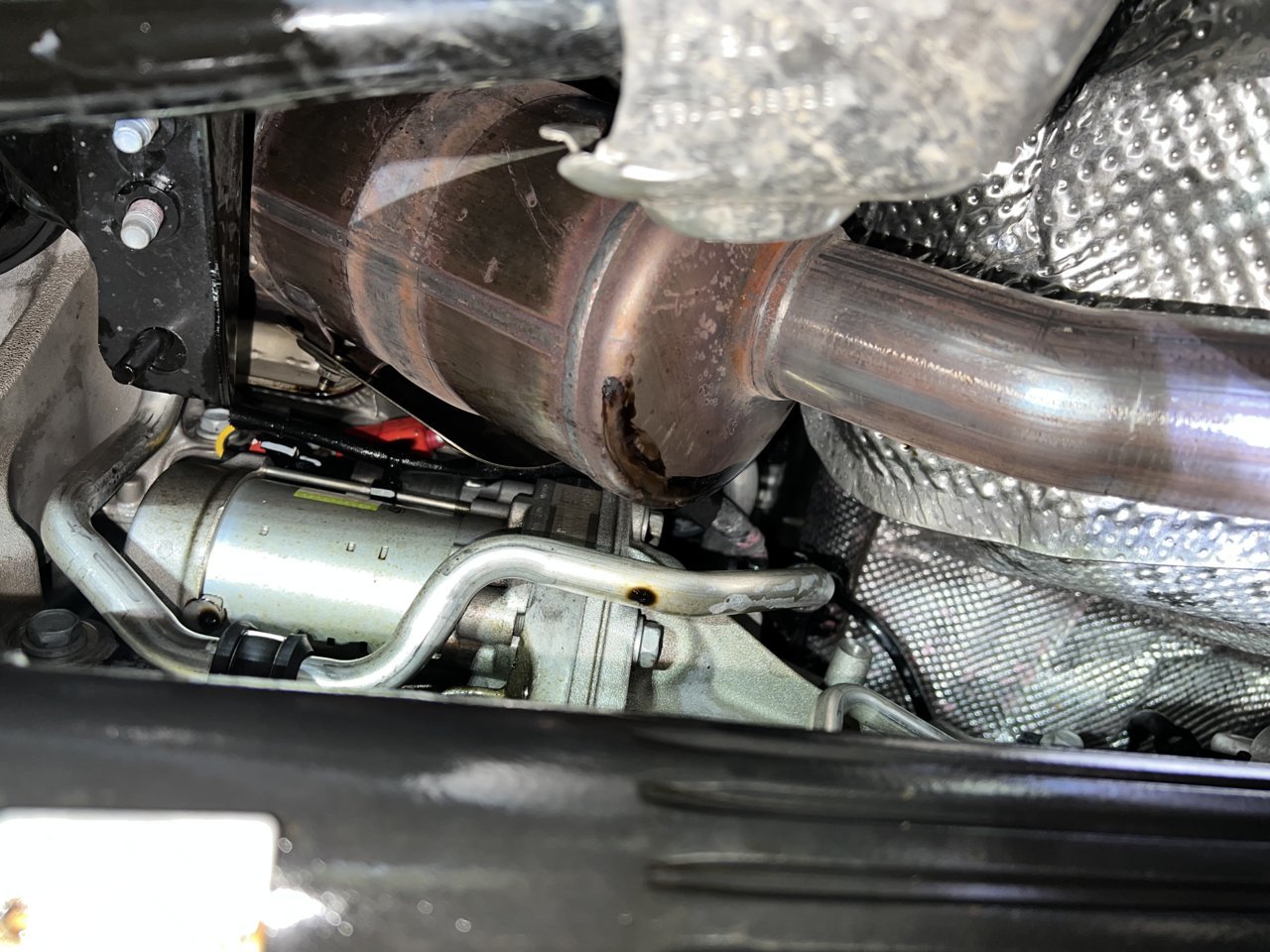

    Difficult to see, but highest point of evidence for the oil loss is on the underside of the driver exhaust manifold. Lots of oil everywhere. Looks to confirm my head gasket theory.
    What is strange though, is there were massive clouds of steam/smoke. I thought for sure the coolant level would be low, but it is unchanged.

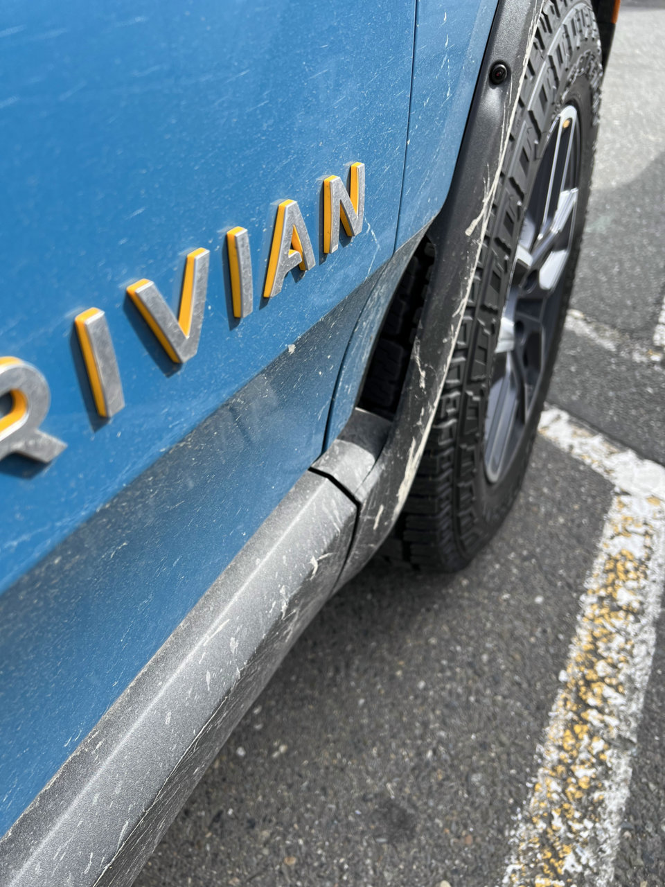

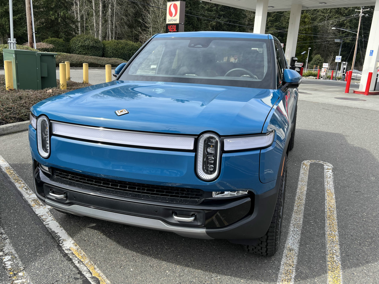

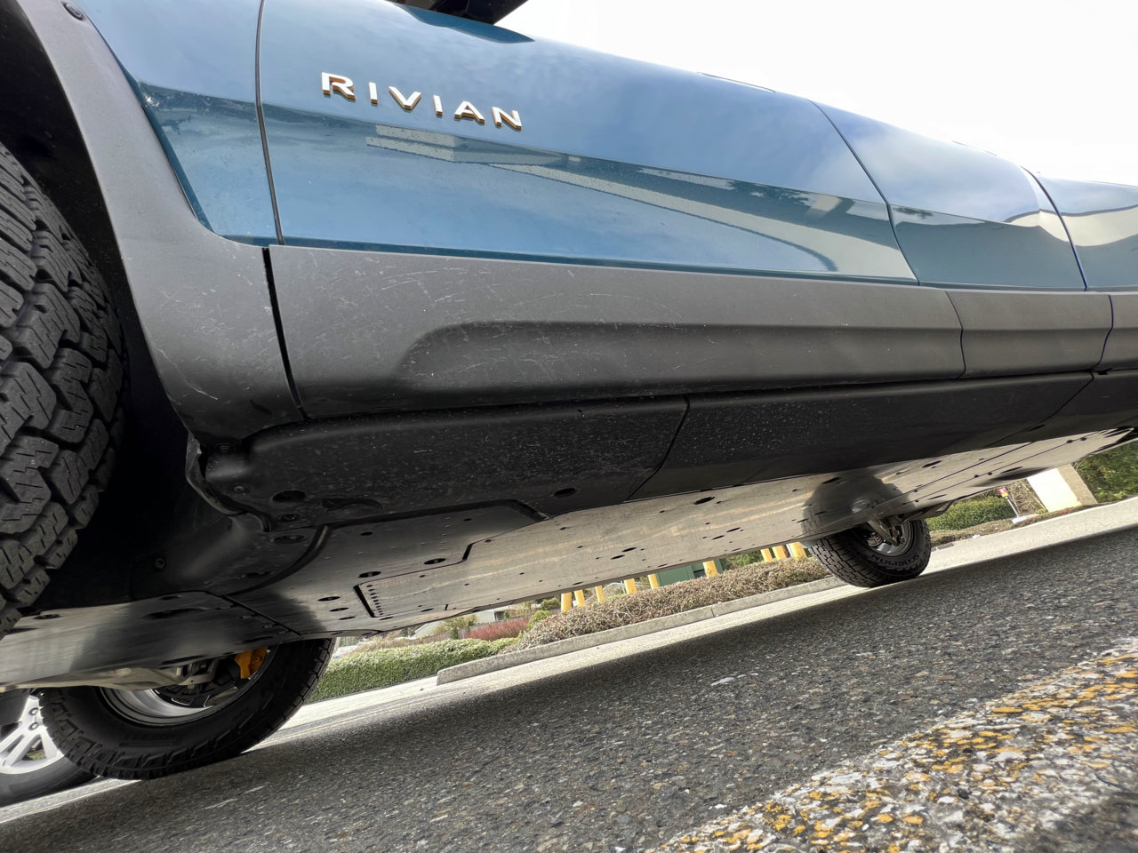

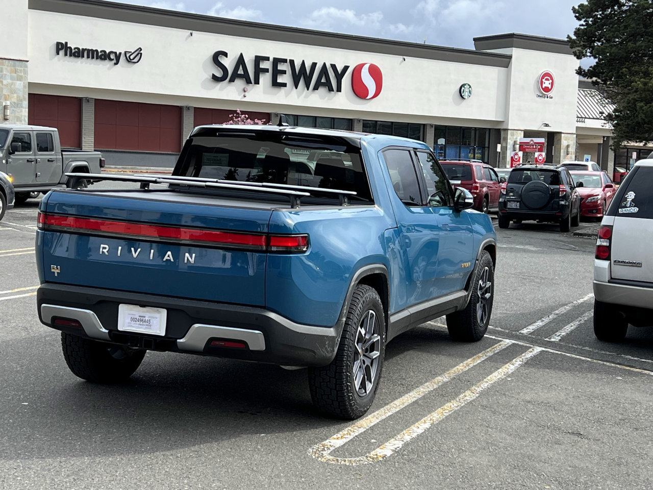

    Seen today at the local grocery store.
    Equipped with the off road package running 34s with full under armor skids. It has pneumatic suspension to increase ride height to 15" ground clearance in off road mode, aka 1.4" more clearance than my 1" lifted Gladiator on 37s.
    Interesting pass through aero feature in the front wheel well, presumably to bleed off the high pressure zone at the rear of the wheel well to reduce drag.

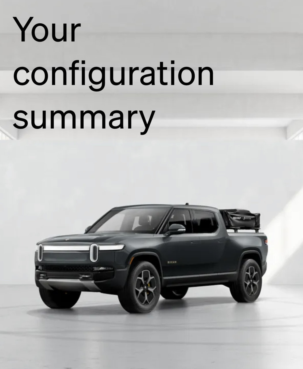

    El Cap Granite
