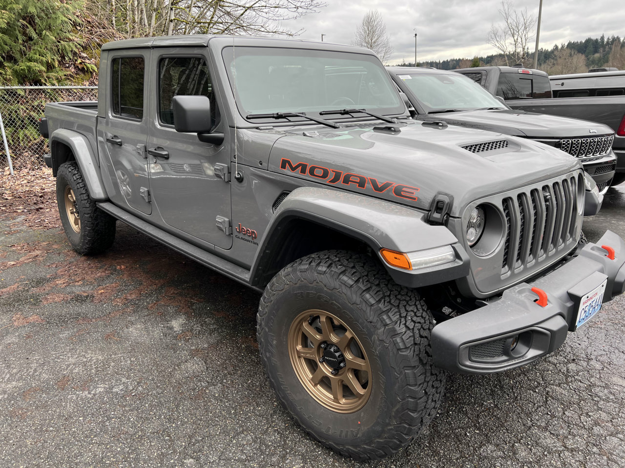

    I actually got the Gladiator dialed in a bit better too. I removed the 2" AEV, and with the 37s on the +30 Visions, it was perfectly proportional. The AEV lift made it too tall and narrow while keeping the tires under the truck, the height to track width ratio was all wrong. With the lift removed there was no rubbing in any testing I did, granted I hadn't taken it out on the trail again yet. Dropping the 2" lift did mean I wouldn't be able to run the full skid system I wanted, but my thought was to run everything but the oil pan skid (which is what requires the 2" lift to clear the front axle and also doesn't have one stock), so I'd still get the 3/4" tummy tuck and the continuous skid system, while being lighter weight.
    Unfortunately I didn't take any good pics post lift removal. Here is one of it sitting dead after being dropped off at the Jeep maintenance facility.

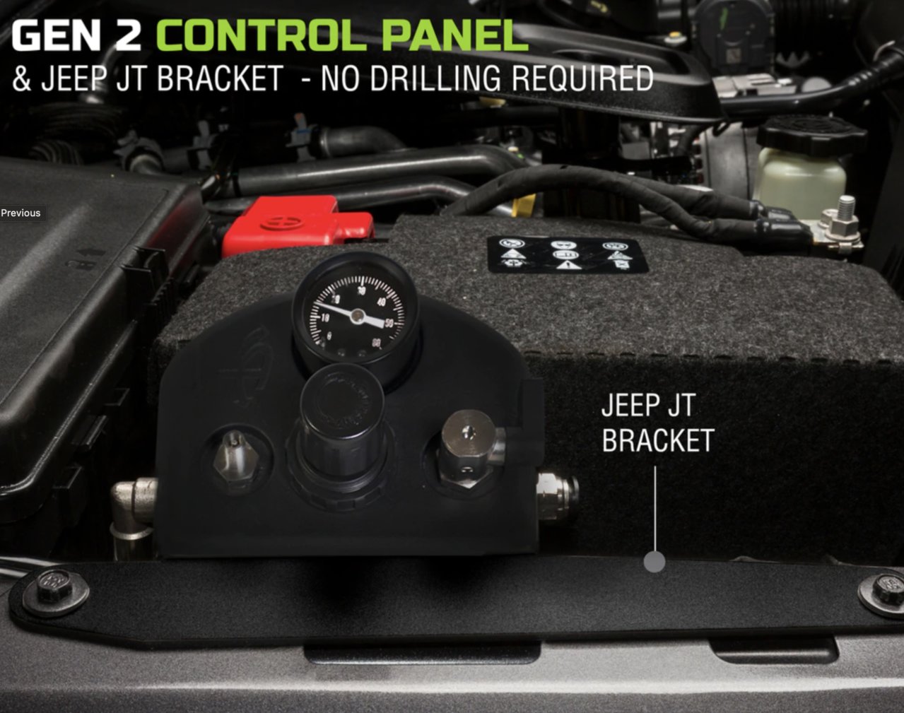

    Interesting. Care to elaborate?

    I’m curious if that tire inflation system works in a Diesel engine bay. I didn’t find any information regarding fitment regarding engine options.

    Seems like if nothing is mounted here on the diesel, it would work. The rest is just hoses.

    Doesn’t look like it will work for me…
