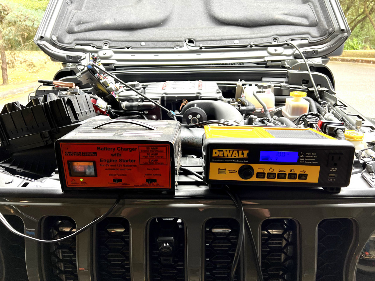

    I went and picked up my Jeep today. It didn't just die once, in the middle of an intersection on a major roadway causing traffic fiasco, it died twice. It was kind enough to throw error codes telling me it needed to charge the batteries, so some systems were going offline, but then didn't charge the batteries and just died in the roadway and wouldn't restart. This is the biggest piece of shit vehicle I have ever owned and the engineering is absolutely pathetic. The truck runs a dual battery system, the primary is the traditional starter, the secondary is a smaller battery to run all the truck systems. While the primary AGM was fine, the secondary failed and despite failing 2 months ago and getting replaced with a new OEM battery, it still failed again, disabling the truck even though the main battery had full power. What's worse, to access that secondary battery requires removal of the main fuse box, the main system sub harnesses, the main battery and a sub-panel under the fusebox and battery.
    Charging both batteries after disassembly

    The best battery charger is CTEK ($50).
    Dealers have sophisticated testers better at finding out for sure if a battery is faulty or not. I imagine they could run that test and if found to be faulty, replace it under warranty for free (or cover whatever else the issue may be)

    No, I refused to get it towed. Since Jeep "covers towing" under warranty, but then denied my towing claim sticking me with yet another bill they had promised to cover (sense a theme yet?). I pumped the gas to get it restarted (which should never be needed on an electronic throttle vehicle) then once it started mashed the gas till the electronic throttle limit held it at 3k RPMs and I held it there for ~5+ minutes (the first time) in park trying to get the alternator to give the battery enough juice. But the instant I put it in gear it would die. So I just repeated this process for longer and longer periods of time. Even with a dead battery, a running vehicle should be able to run on alternator power. Vehicle failure due to insufficient battery charge on a running vehicle shouldn't be a thing on a modern vehicle. After multiple failures and much embarrassment I was able to limp it home by making sure I never came to a stop/slow enough speed where it would die. Its pretty cool to sit in a 1 year old $70k truck blocking traffic in an intersection and have it just simply not be able to start, and if it does start put it in gear and have it die again.
    Yes, in theory the battery should be replaced under warranty. How many 1 year old trucks do you know that are on their 3rd OEM battery? However, I'm never going back to a Jeep dealer again, for anything.

    Checked the voltage on the Jeep’s OEM AGM starter battery this morning and it was low. Sigh. It was at 12.8v on Friday and by Monday it had dropped to 12.2v. An AGM should have no problem bouncing back from a low charge state and holding a charge again. Meaning either the battery is failing or there is a drain in the truck. The truck is in completely stock configuration other than the supercharger, so it shouldn’t have a drain, but I have negative faith in this POS now. Once again put the truck back on the charger to recharge the battery. I didn’t check the smaller secondary battery that runs the primary vehicle systems because of how buried it is in the truck. And the fact Jeep mixed battery chemistry with a lead acid battery and AGM is just asinine.
    Once recharged I drove it straight to a dealer and sold it for a substantial loss. I don’t even care anymore, I am so relieved this POS is gone and the nightmare can finally end.
