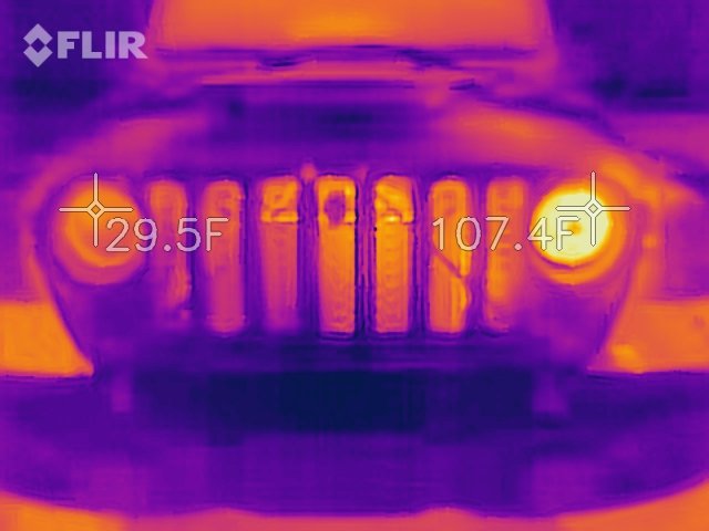

    28 degrees out. Driver headlight at 107.4 degrees, defective passenger side at 29.5 degrees. A 77.9 degree difference.

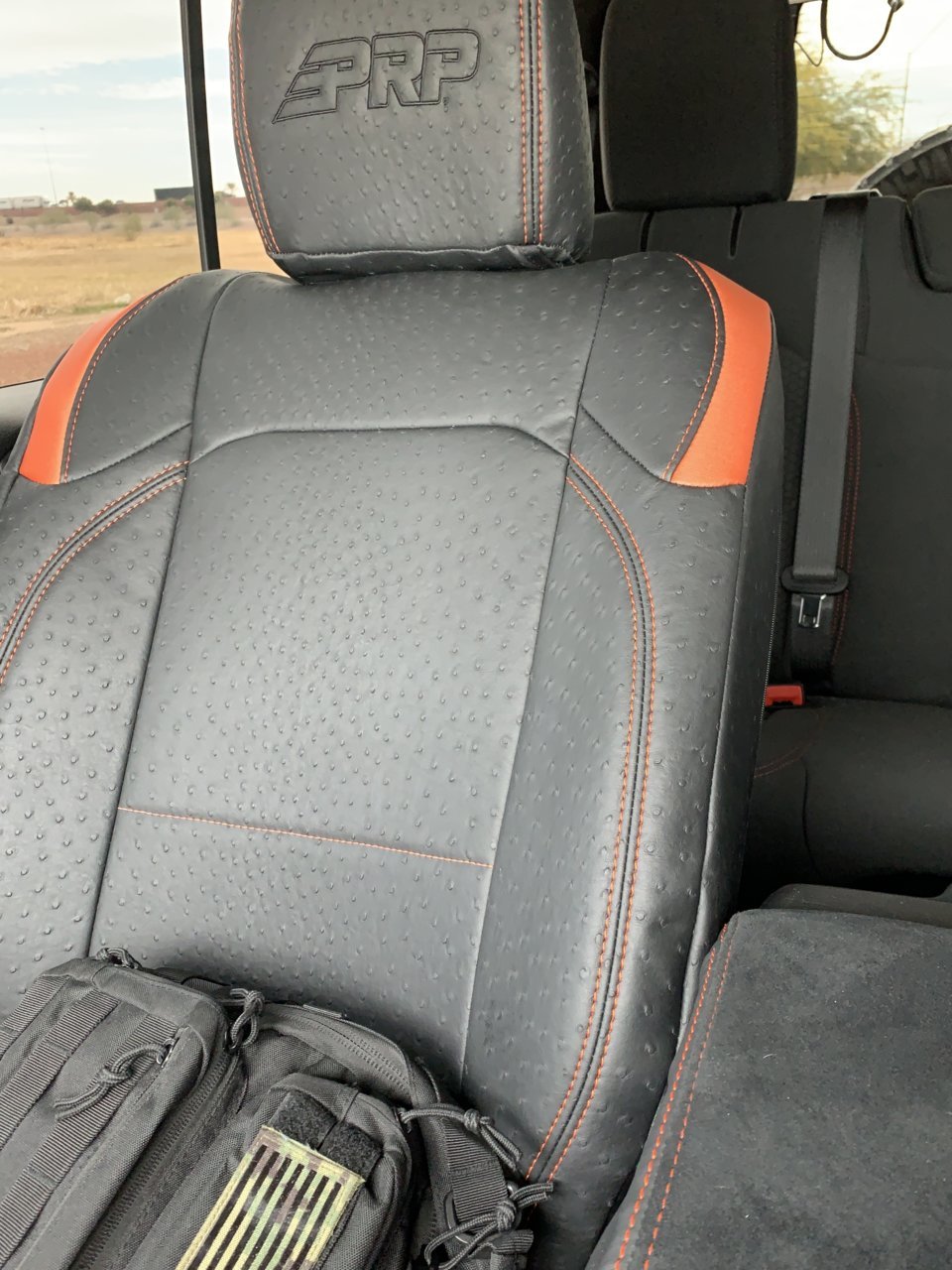

    Also, another favorite mod is PRP seat covers. They’re not fun to install but it’s a good option if you want certain colors inside. Still need to do the rears this weekend.
    The Mojave is standard leather right? I just have a JLUR.
