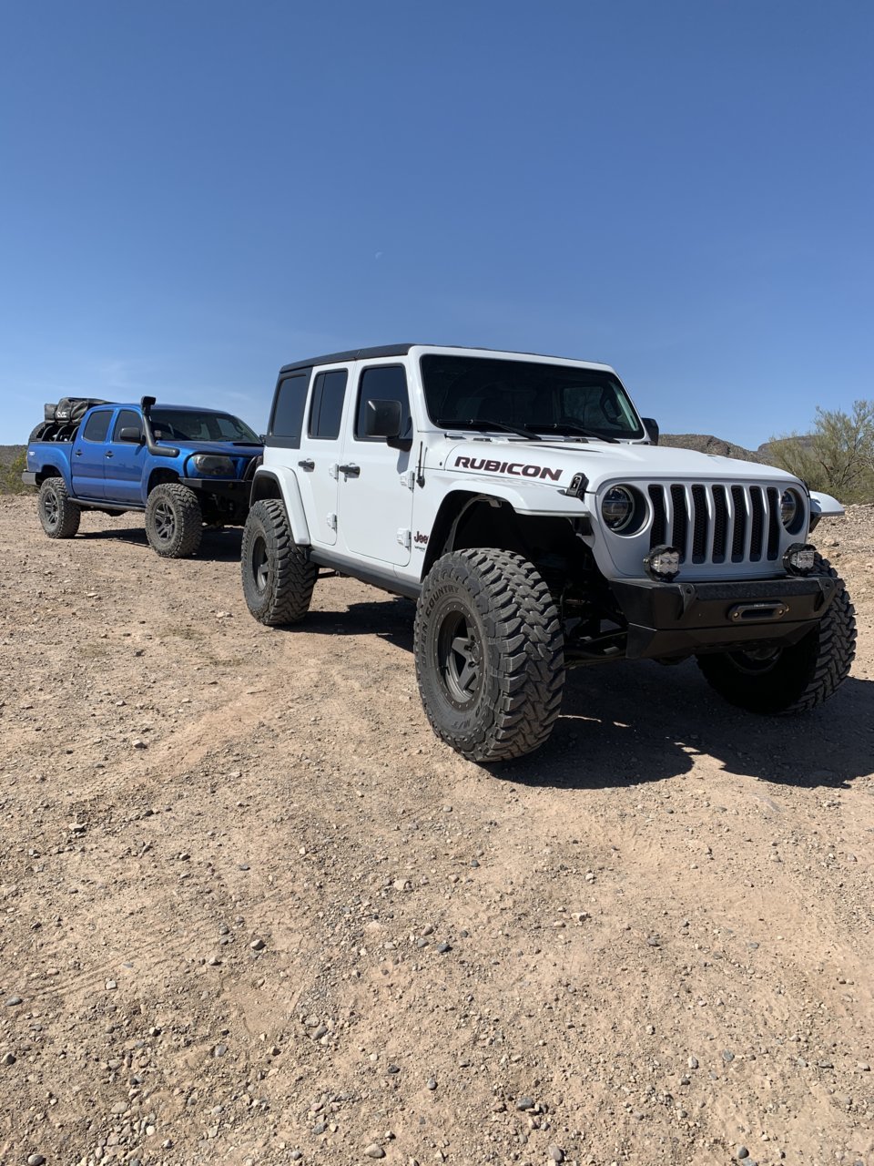

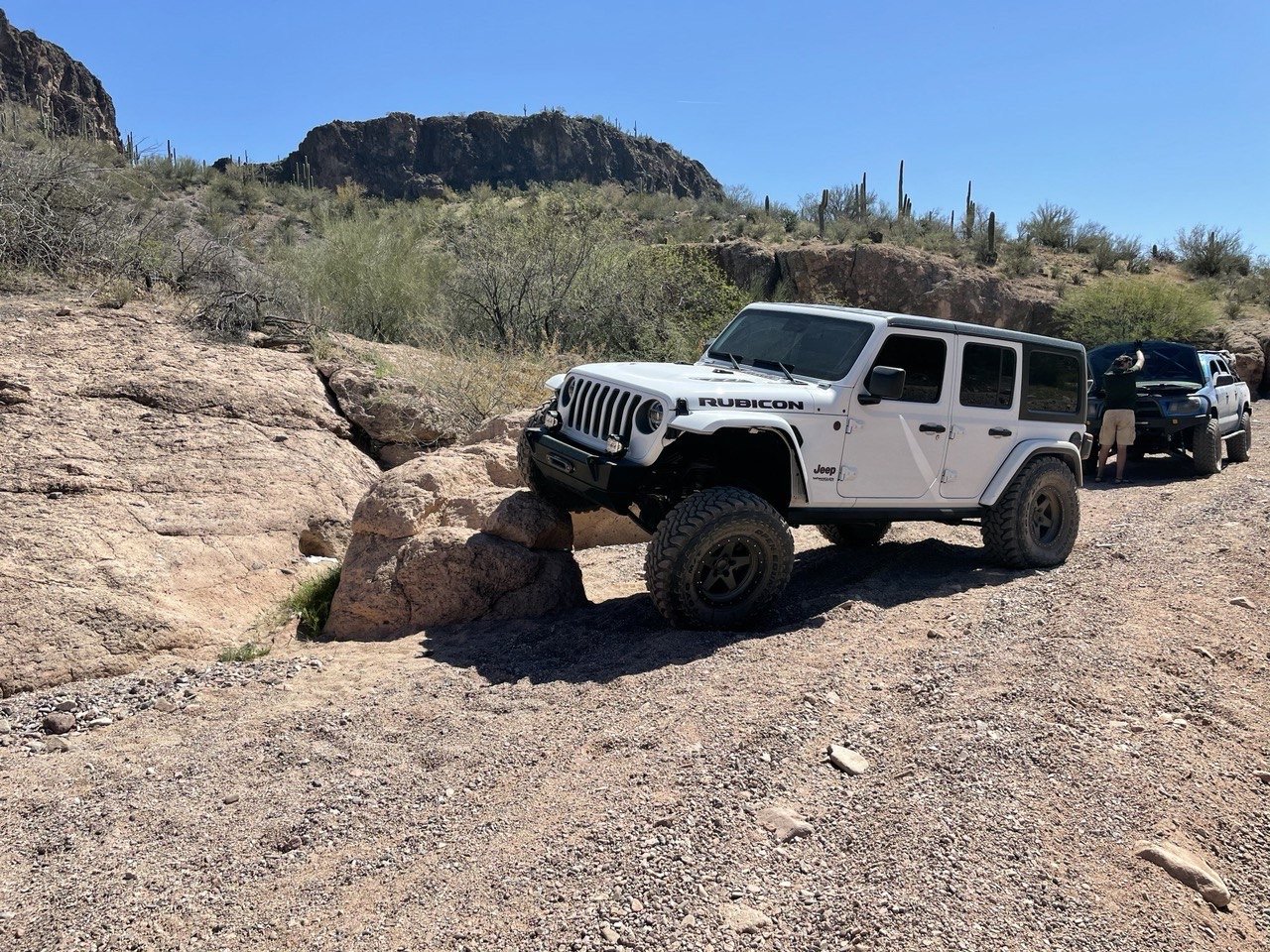

    Makes 37s look small. :(

    Tiny Toyo MTs. I need to install my winch and regear this year.

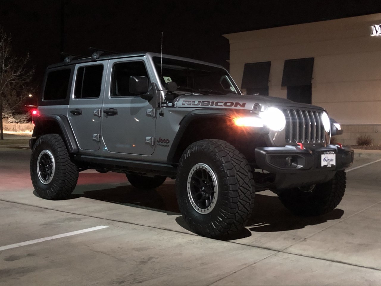

    Heavy ass 37’s...I know it’s a parking lot. Just finished the first mods and needed a pic.

    The poke isn’t too bad. I hate poke but I liked the SCS option. Vin hooked me up.
    Need to redo my rear fender PPF. Desert life is rough on these things.
