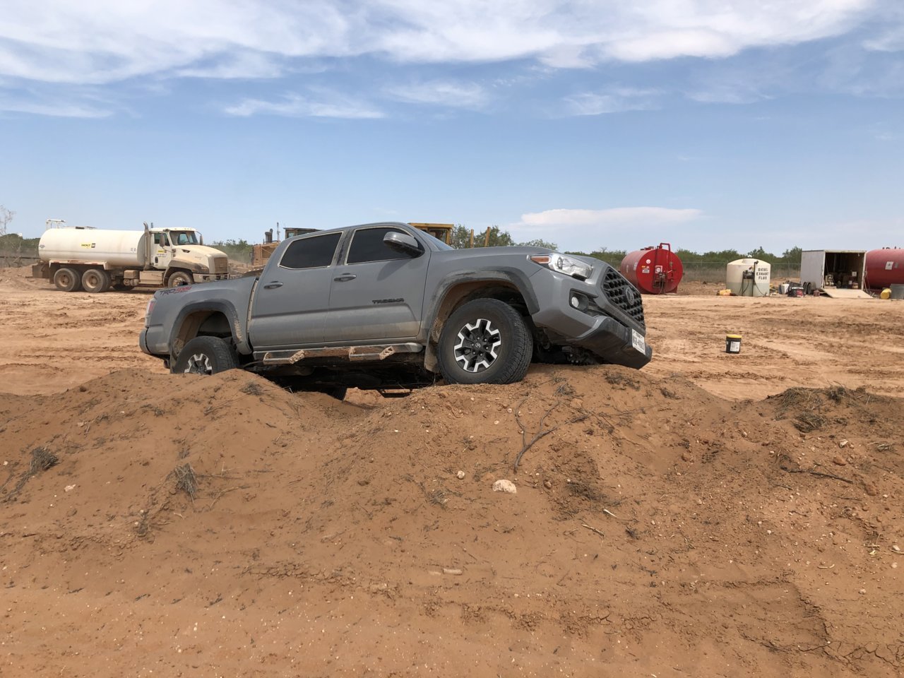

  20. Sep 25, 2020 at 11:19 AM
    #380
    Rachett979
    Rachett979 Working Taco
    Dec 23, 2019
    #314037
    13
    William
    Texas
    2020 TRD Off Road DCSB cement
    Led interior
    30B97FE1-A264-4E78-89BD-6C6F9C2F4B6B.jpg I have been driving Tacoma’s since 2016. Started with a 13 sport, someone rear ended me. Hot a 17 or dclb. Loved it. Traded it in in April 20 for a 2020 or dcsb with premium audio and leather seats. Yes there is a problem with the cc. I’m taking it in on Monday morning. I called the 800 number you guys provided and they actually called the dealership and scheduled the appointment. I know for a fact it isn’t working properly and even knew about all the shit they give us at the dealership about it has to learn your driving habits. I’m in my truck all day long from 6am till 7pm. My 17 had no issues whatsoever. This truck will not function properly. I chose Tacoma or because of the crawl feature. It literally can go just about everywhere I need it too. 5’ deep sand, loose rock, mud even up and down 3/1 slopes and yes 2/1 slopes. This truck won’t crawl over a 6” curb unless I give it some gas. I’ve even put gotten out of my truck and walked beside it while it was crawling up a slope. Hopefully we can get this resolved soon. 30B97FE1-A264-4E78-89BD-6C6F9C2F4B6B.jpg
    trevnologies likes this.
