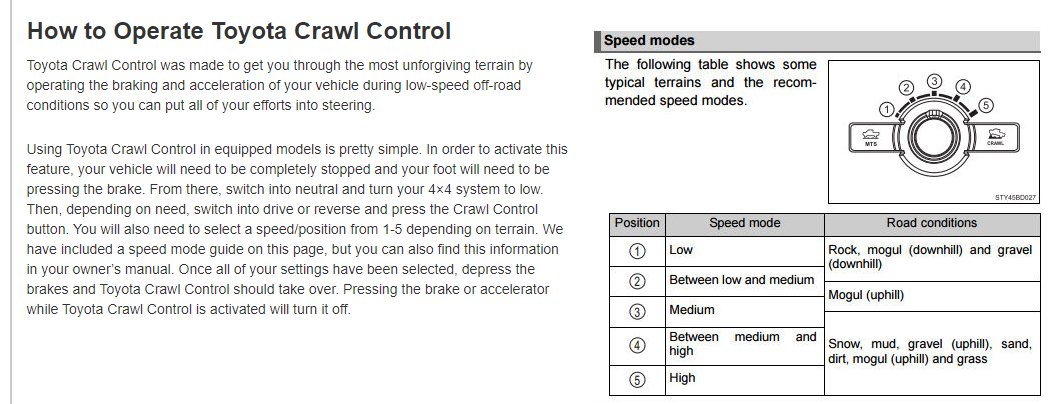

    Ran into this thread, I saw this online that might be helpful here. I haven't tried my 2021 yet but I will soon and will report back if it work so not.
    TOMRR likes this.
