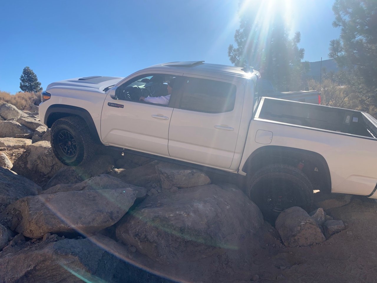

    Tested the CC couple times off road to see how it works and it was fine up and down a mountain. Been doing fine without it and the truck is able to handle most obstacles. I've been using the CC more often now since it helps out a lot and I can use the throttle and it won't disengage the CC CC.jpg
