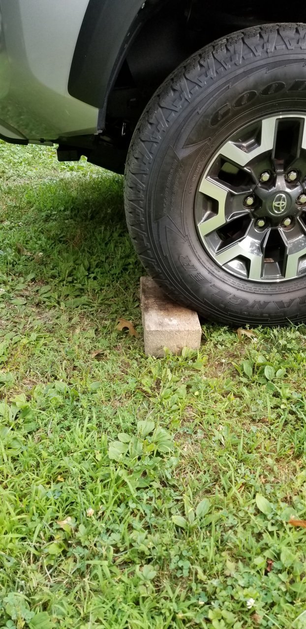

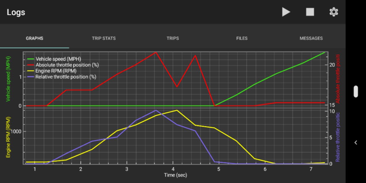

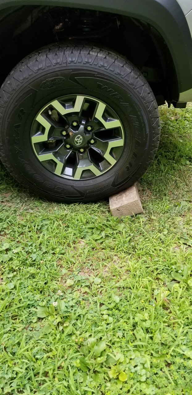

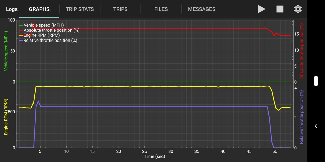

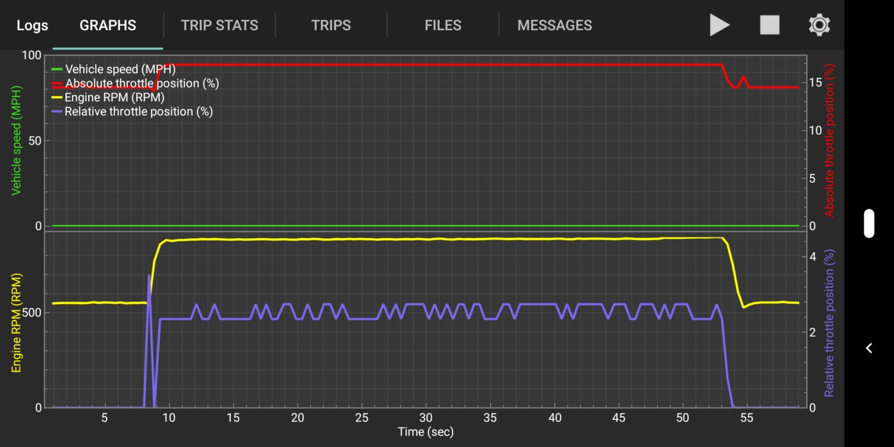

    Here is the confirming data after the update to 04B82, prior test data below as well. Exact same setup in all tests - chocked with 4x4 lumber on both front, 2x4 on both rear. No run up, it was chocked and then idling in drive up against them. No hesitation with 04B82, actually quite aggressive using more throttle than needed.
    CRAWL Control - 04B82 (Successful)
    Prior test data below with both manual throttle control as well as 04B80 and 04B81 on CRAWL control.
    Manual / Foot - 04B80 (Successful) - Note minimum throttle position % needed for the obstacle
    CRAWL Control - 04B80 (Fail) - Crawl throttle % appears capped and unable to reach % needed for the obstacle
    CRAWL Control - 04B81 (Fail) - Crawl throttle % appears capped and unable to reach % needed for the obstacle

    Excellent work! Loving some good graphs here. That looks like the CC controls are more efficient at crawling now than just gassing it till she rolls.

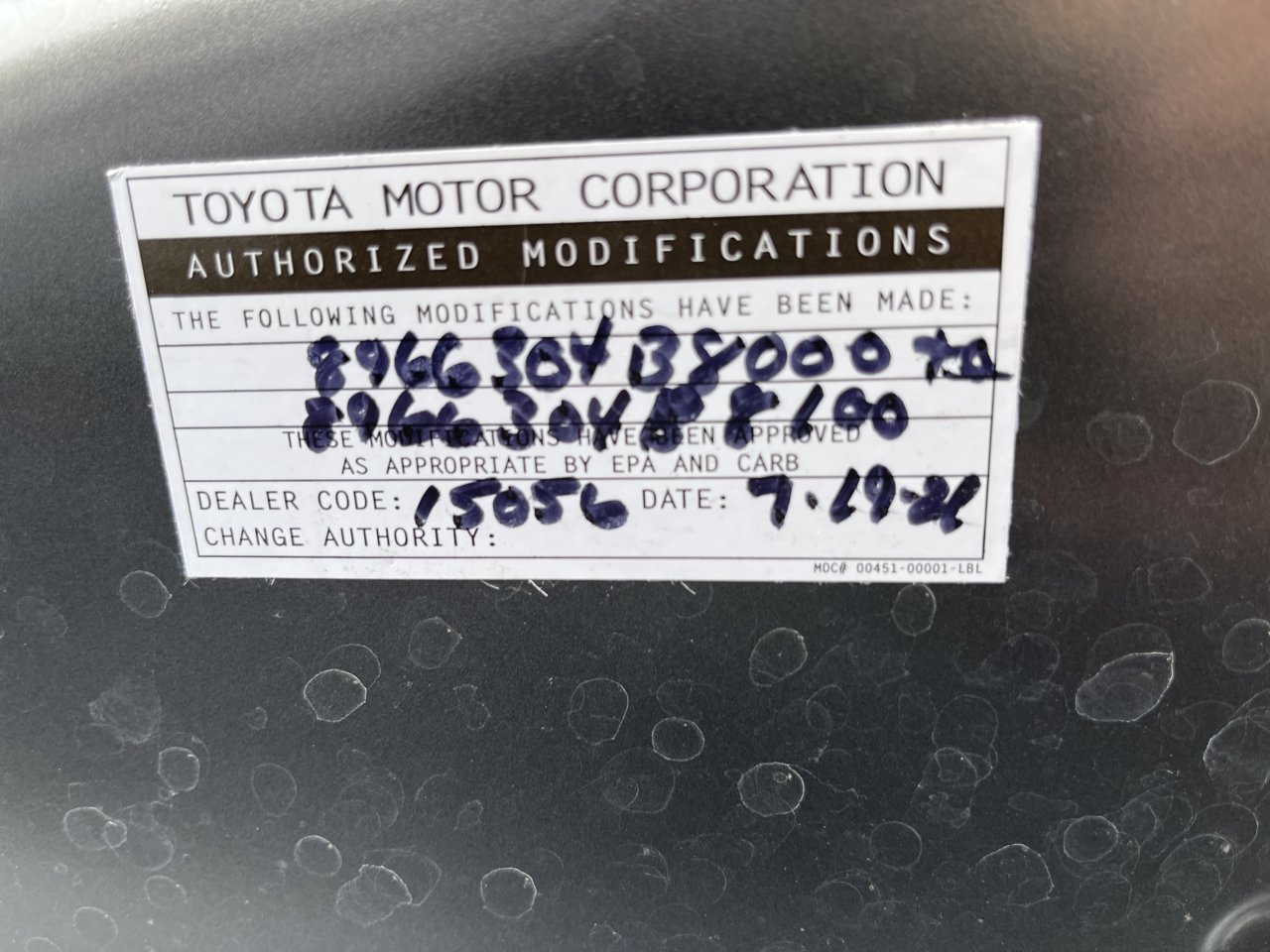

    I had my dealer do TSB 0092-20 today on my 2020 TRD Pro
    No problems asking for it and getting it done, but I did provide a copy of the TSB.
    Here is the new sticker that was placed under the hood.
    Just confirming this is the latest and greatest for the 2020 Pro and also would this have corrected the possible crawl control issue as well?

    The next ECU ID 04B82 on TSB-0045-21 is noted to correct the CC issue.
    See @mattleg 's posts above.
