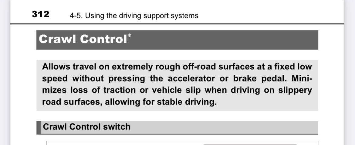

    That defeats the purpose of the 4x4/2x4 and curb test…

    The point of crawl control is not needing to use the throttle manually.

    Agreed, but point still stands.

    I think you’re partially correct, yes while you’re using crawl control you can use the accelerator, but the function is overridden until you lift your foot off the gas.
