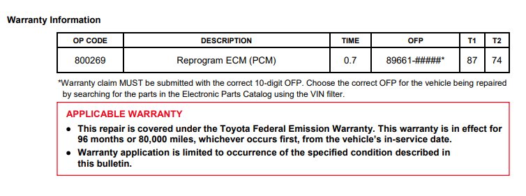

    I’m scheduled for tomorrow morning to get the TSB -0045-21 update done. Service advisor (that I trusted) asked if I had an extended warranty? He said that they would have to charge me a fee if I didn’t. Never heard of charging for a TSB on a truck with 14,000 miles. Thought that was really odd. But I have a 10yr extended warranty, so I’m covered either way. I always thought all TSB’s are covered under the bumper to bumper warranty?:confused:

    It’s supposed to be covered under emissions warranty I thought I saw when I read the TSB. Thought is was weird but then thought it was to give people a little more time. I was not charged.

    Ive never had an issue getting a TSB applied if the issue was able to be replicated by the dealer. Ive had my old Wranglers in a dozen times for TSBs and my truck once for transmission shifting TSB. Sounds like they were trying to sell you an extended warranty in my opinion. Id call corporate and submit a complaint about that as thats some shady business practices.

    Your advisor doesn’t know what he’s talking about. You don’t need an extended warranty for a TSB on a 2 year old truck with 14K.

    From TSB-0045-21
    TheIncredibleTaco and Jyruiz like this.

    Is there a link to print out the TSB? I would like to show up to the dealer with it.

    I believe it’s post #474 on page 24 of this thread. I printed it out and took it to the dealer as well.
