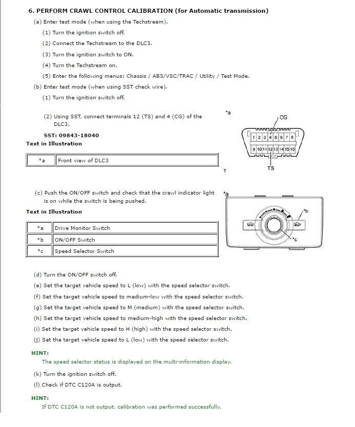

    I could see that as a possibility. Do you know if there are any updated calibration docs for the 2020's as pin 12 in the ODB connector is no longer there? I found this out while trying to follow the trans temp /fluid level check.

    Were they looking for stored DTCs?
    A lot of the involved DTCs require being in "Test Mode" to be output; checking each of the following:
    Acceleration sensor, master cylinder pressure sensor, speed sensor, 4wd detection, ABS, MTS switch, crawl switch, VSC switch and VSC sensor.
