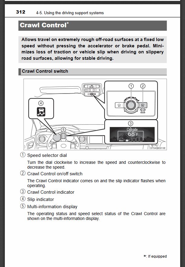

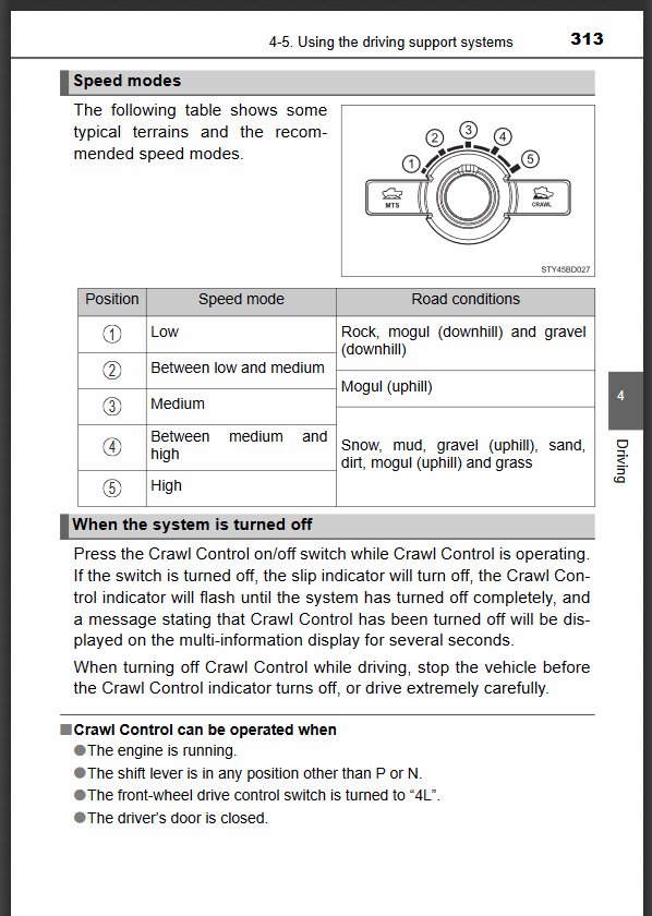

    Can someone tell me what the four separate sections on the crawl control switch are for on a 2020 Pro? Speed? Thanks!

    The speed of your "crawl". Its like having cruise control for offroading. Thats my best explanation. :rolleyes:

    OP....were just bustin' on you some. No harm intended. :boink:
    Every single day there are posts with people asking, "what's this button do", "how much oil does my truck hold", etc., etc.
    Take some time and thumb through the owner's manual. There truly is a wealth of information in there. :thumbsup:

    Thanks for the replies everyone! Next question....I just went out and tried entering Crawl mode. I went into "4Low" then shifted from Park to Drive. I got the message, "Crawl not available. Shift into 4L then D or R." I did this and it still didn't go into Crawl mode. I keep getting the same message each time I went through this sequence. Any advice? Thanks all!

    I read the manual as many suggested but couldn't find anything for, "I went into "4Low" then shifted from Park to Drive. I got the message, "Crawl not available. Shift into 4L then D or R." I just assume at this point that this is normal.

    You can only engage CC while in 4L. You can only engage 4L while in neutral. Once 4L light is solid, you can engage CC.
