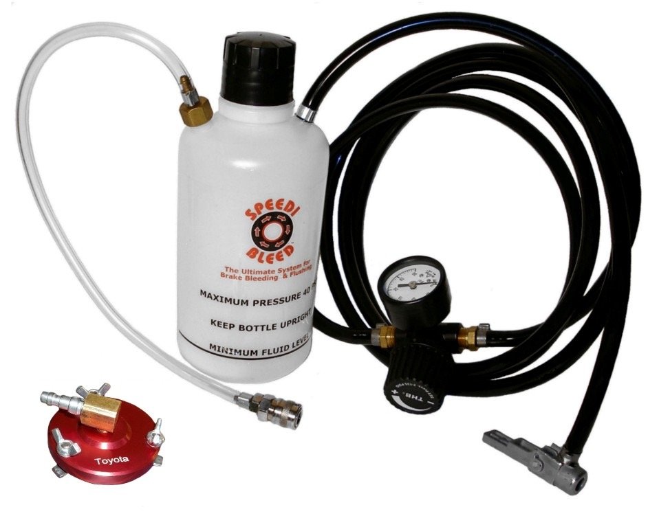

    Without a pressure bleed tool which bleeding method would suggest, I have a vacuum pump.

    I modified my brakes a lot but I read threads where TW members had trouble bleeding the brakes because of the ABS so I limped it to a shop to bleed the brakes for me. Some sort of computer/program that cycles the brakes at certain time intervals. It worked fantastic after that.
