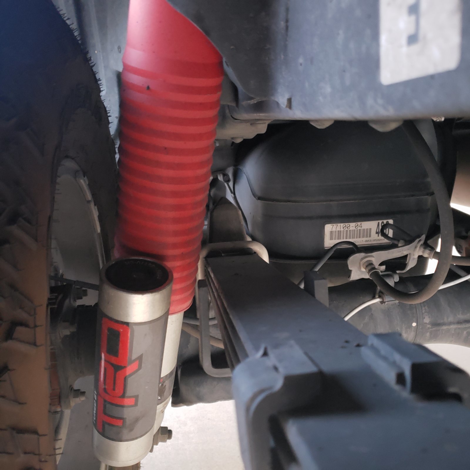

    From that last video I think that is the issue too.
    To the OP you have aftermarket leafsprings. Stock leafsprings do not use that style of leaf clamps you have. Stock is either very wide or has molded plastic pads where they do touch the leaves.
    Before you just hose down and lube everything try lubing just certain areas to pin point the trouble area. I would start with the long spring clamp in the video.
    This is a stock spring for reference.
