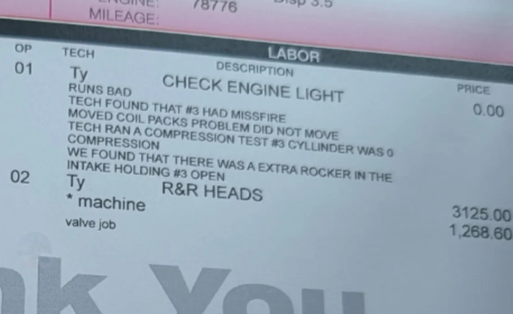

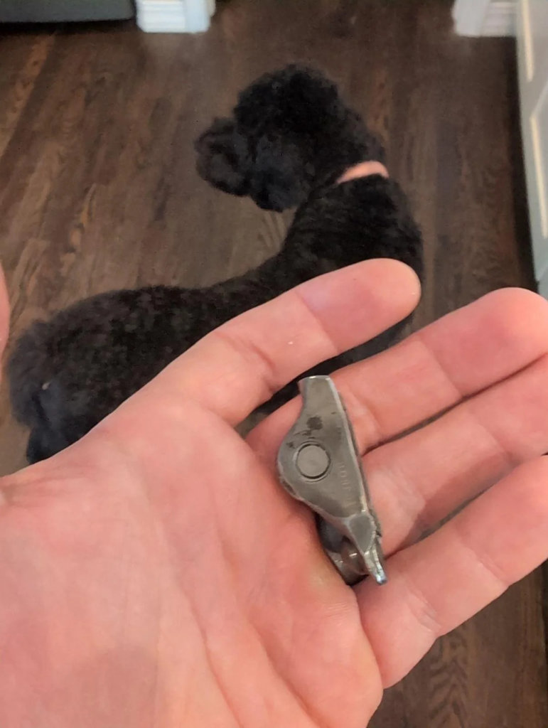

    Long time Toyota truck guy but first time posting here. The engine on my 2017 Taco with 78K miles started running really rough - brought it in and they found zero compression in cylinder 3. Mechanic removed the head and found an extra rocker arm (all twelve of the others were in place) had been left in the engine and was holding the #3 intake valve open. I had the mechanic repeat that because it sounded so bizarre.
    The truck was purchased new, no major work had ever been done on it - so it left the factory with this extra rocker arm rattling around somewhere and took 8 years and 78,000 miles for it to get into a position to cause a problem.
    The bill to remove and replace heads, remove the extra part that was left in the factory and repair the damage it caused ended up costing $5655. I was over the powertrain warranty, but reached out to Toyota corporate to explain the situation - hoping they would at least cover part of the repair since it was obviously negligence on their part to let an engine leave the factory like that. Phone calls and email gave the same response from Toyota corporate: Sorry - you're past warranty.
    Disappointed but not unexpected. I was surprised, though, that they had no interest in seeing the part or reading the mechanics documentation. It seems there is a fundamental flaw in the engine manufacturing process and Toyota has no interest in determining how it happened or taking steps to ensure it doesn't happen again.

    Thanks for the replies. Yes, part of me wants to keep pushing for resolution but so many calls and emails getting the same canned corporate response, you just run out of bandwidth in your life to keep at it.
    Also, point taken, I'm just another VIN with a pretty implausible story as far as Toyota is concerned. I'm surprised they wouldn't want to see the rocker arm. It's tumbled around like it spent 8 years in a rock tumbler but with none of the ordinary wear pattern you'd see in a rocker arm.
    Hell, if I was trying to scam them I would've come up with something more believable than this. Anyway I'll keep you posted. If anyone has contact info for someone that might actually care, I'd appreciate it

    definitely hold onto the spare :) rocker but your ace is the report from the dealer.
