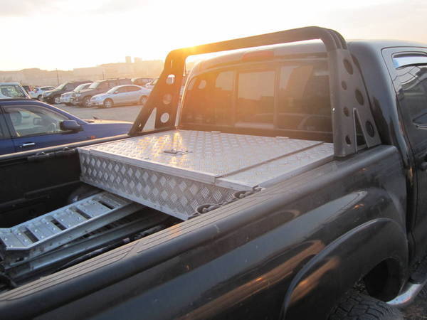

    - black front grill;

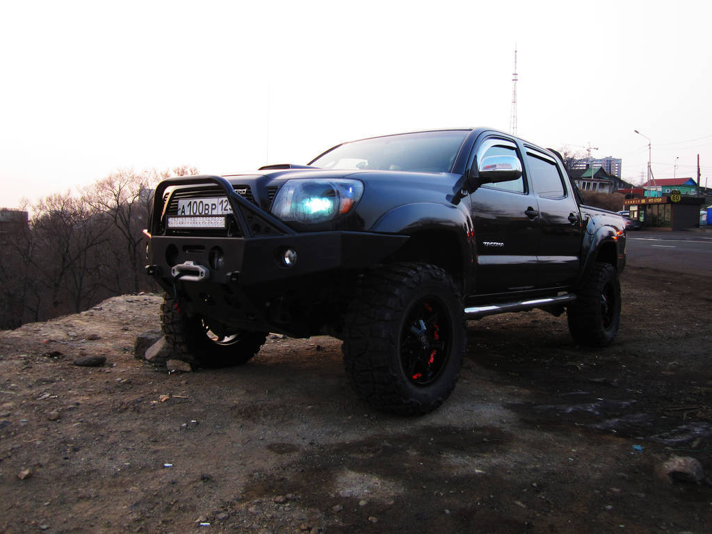

    I started to make the front bumper
  14. Nov 6, 2013 at 2:05 PM
    TPM
    TPM [OP] crazy russian
    Aug 23, 2013
    #111026
    48
    Paul
    07 Tacoma OFF-Road TRD
    coils rear suspension, rear disc brakes
    the half is done, looks "heavy"...
    this supposed look like this
    so, will see...

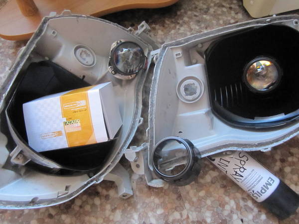

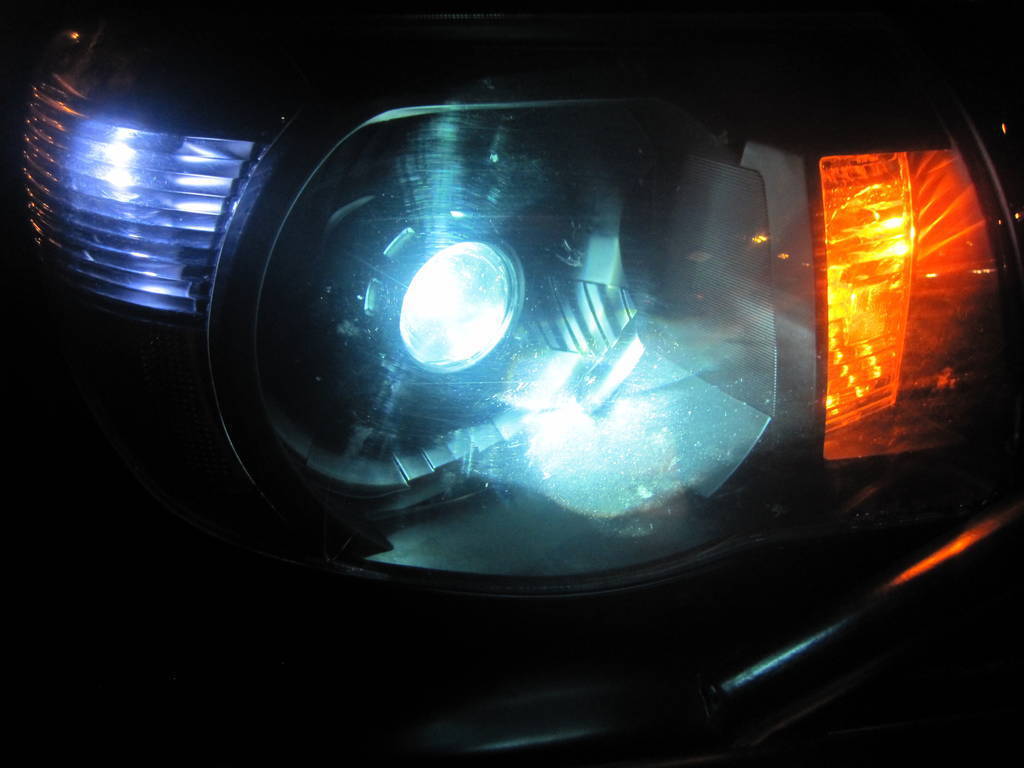

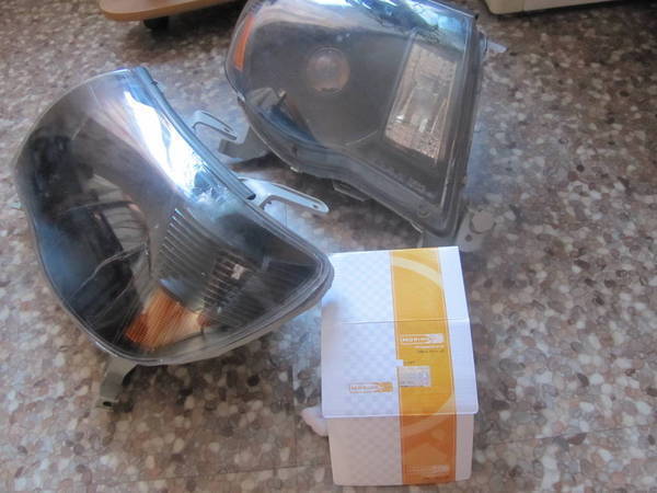

    My Morimoto Retrofit lights are complete!
    so, it was easy :)
    p.s. front armor bumper already done, rear armor bumper almost done - photos coming soon :)

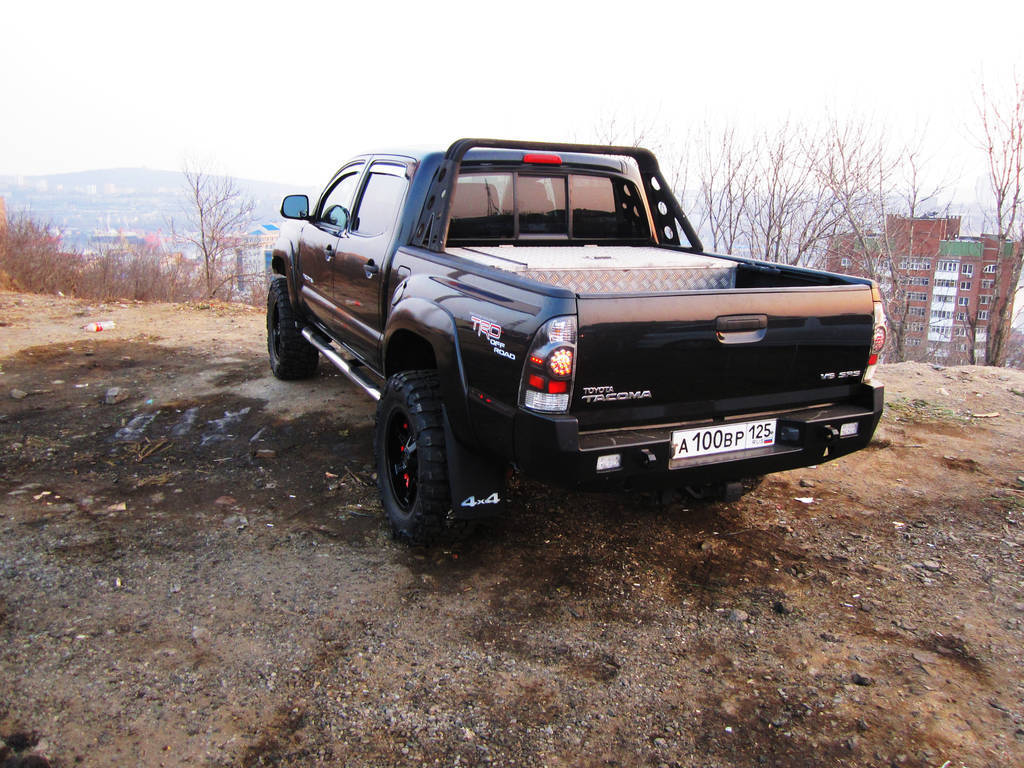

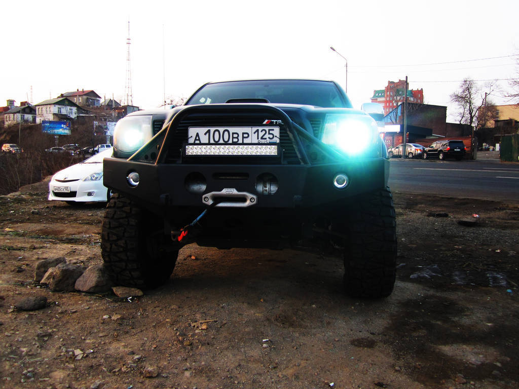

    more pictures :)

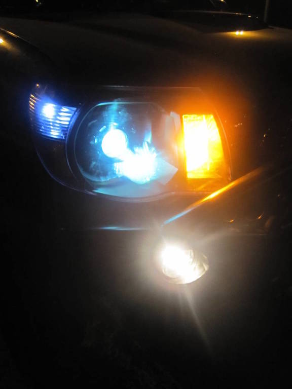

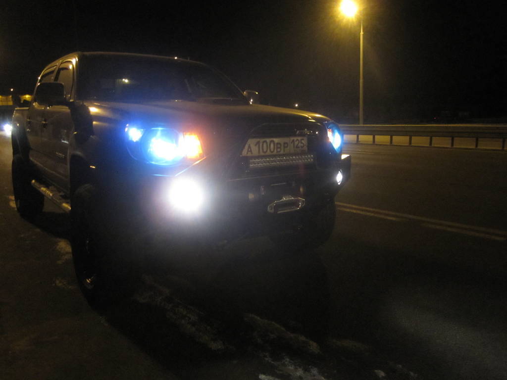

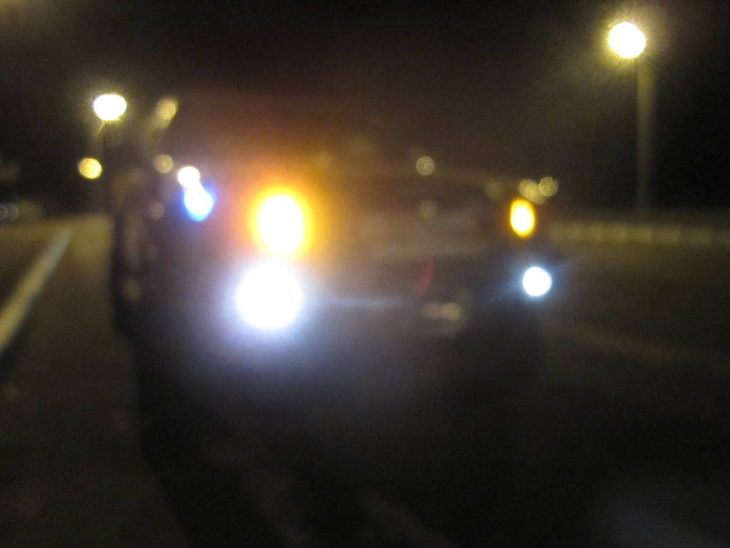

    Front armor bumper, custom build :) also I change a "factory" fog lights to the 90mm HELLA Classic - the HELLA lights looks good but I'm not impressed with the "price/perfomance".
    And yesterday night I "check" the lights. I was impressed and I still impressed :)
    only Hella "fog" lights ("all-time fog lights mod" was easy to implementation)
    with Morimoto Retrofit
    and 180W LED bar :eek:

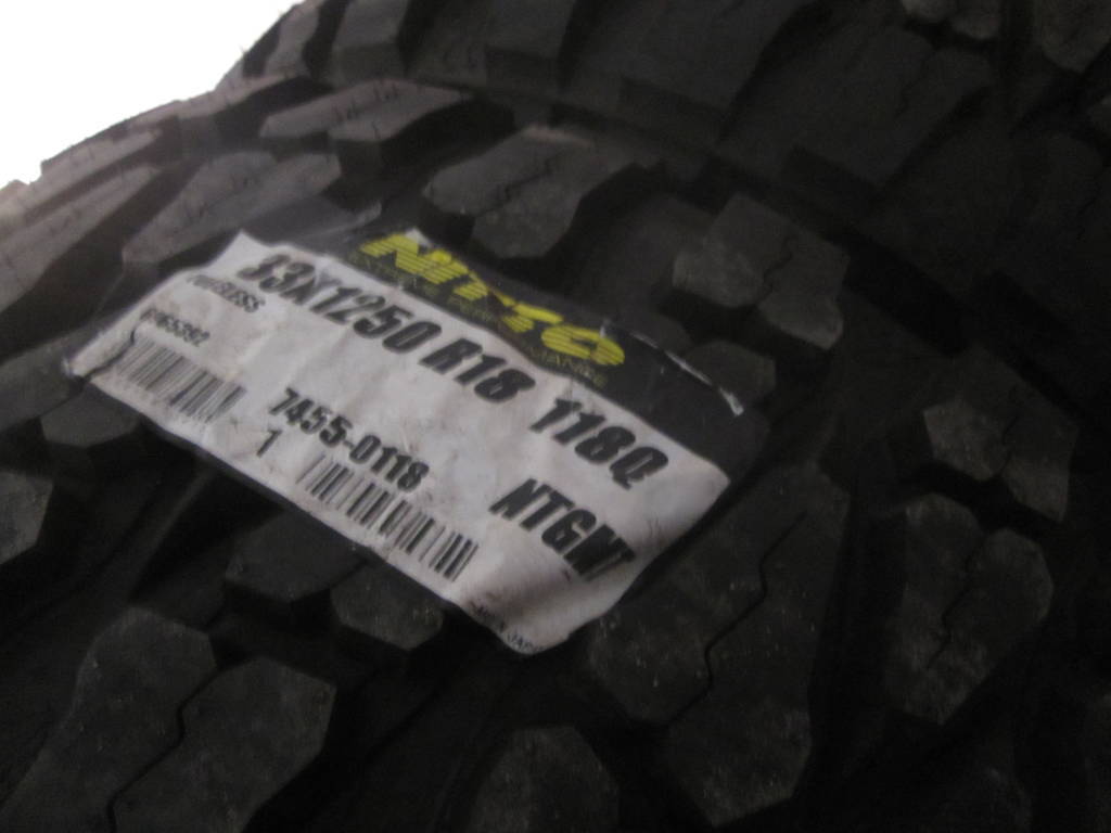

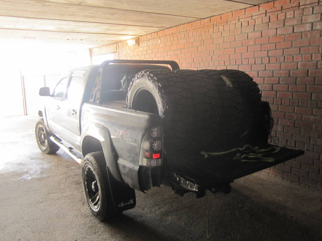

    And for the dessert today - My wife presented me with new Nitto 33/12.5/18 tyres :)
