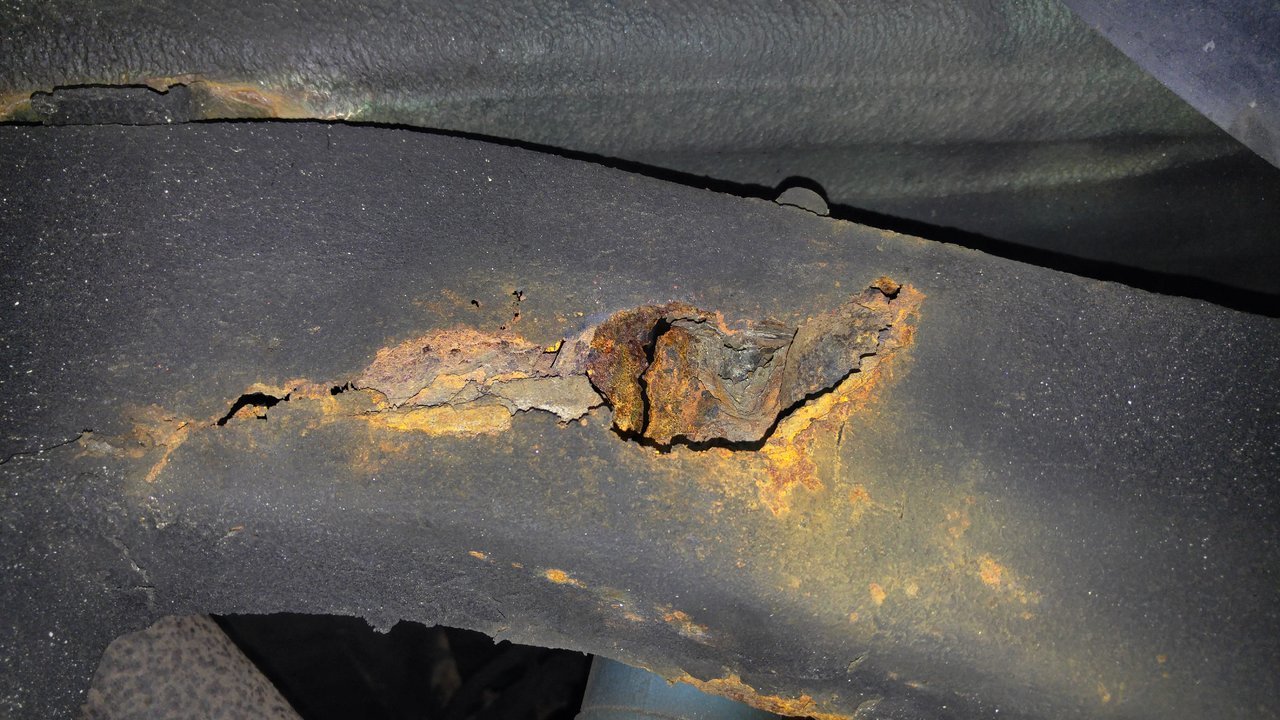

    This happened to my 02, frame was inspected and coated in 2010, when i took a good look at it a few months back i had a 6x2" hole below the rear shock mount and it was all the way through. Surprisingly though toyota is going to replace the frame but its going to take a while (6+months) and the vehicle was deemed unsafe to drive. Now it sits on the dealer lot awaiting the frame. So i have an 05 trd now and will figure out what im gonna do when the 02 is back.

    15 year extended warranty is Canada-only this time around. For a US truck, once the frame is sprayed, that's the end of Toyota's action.

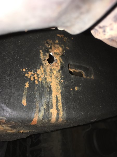

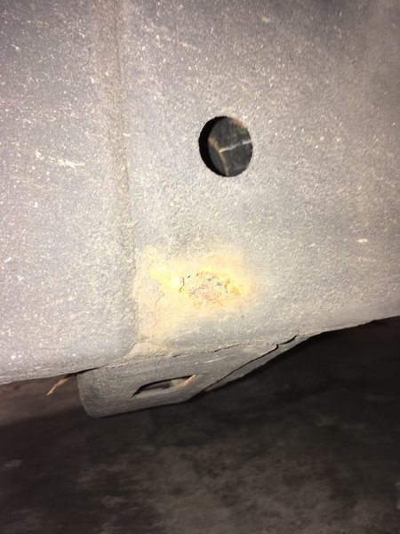

    IMG_0637.jpg IMG_0635.jpg @Markcal ask for some photos.
    The first one is on the inside frame rail by the left catalytic converter. The second one is on the outside frame rail by the transmission/transfer cross member. I can put my finger through both.

    3,115
    Thanks, that first photo is kind of scary, because I have those same streaks of rust running down (not as much as you do) and I didn't know where it's coming from. I wonder if I have or I'm developing the same hole next to my catalytic converter that you have. Just my luck, after the 12 year inspection is over the hole there will appear.

    #136147
    3,115
    Question: In the first photo, Where is the rust streaks coming from? Would those rust streaks be coming from inside to the outside of the frame, because mine is in the exact spot?

    5100's and 883 OME Coils TRD Exhaust Deaver 1.5" AAL Rear Differential Breather Extension, 4WD Light, Tailgate Pipe clamp, Fog lights on while High Beams on, Carrier Bearing flip
    I'd assume it's coming from the metal under the flaking paint. Tap tap with a ball peen and any weakness would be obvious quickly.
