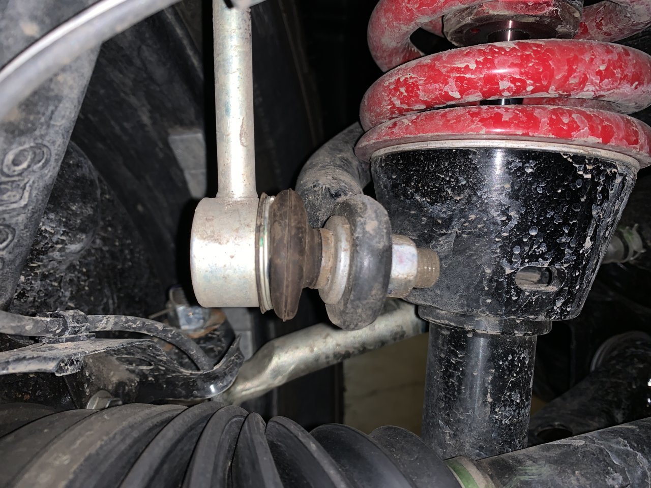

    Long time listener first time caller.
    I recently started having this/ similar sounds as well. 600 miles in on a new taco with ToyTec Boss. The sound at the beginning of the thread sounds dead on. I mostly hear creaking from driver’s side anytime the driver’s side suspension articulates forward or revers. Kills me. Haven’t have this issue with lifted 2nd Gen taco.
    Sounds like a couple different areas to check. One thing I found for sure is the sway bar is hitting the driver’s side coilover. I can see the red marks. And the sway bar, even with relocation brackets is TIGHT against the coilovers on both sides.
    Working theory is something with the sway bar and/or mounts. Taking back to the dealer and off road shop to evaluate. Will definitely check the body mounts as well

    Are your sway bar relocation brackets on backwards? They should move the sway bar forward

    Solid question.
    So far as I can tell, they’re installed the right way... obviously the sway bar tells a different story. I do need to take them off and double check. My thought was Toyota did this, I kinda want them to see their boff.
    Challenge here is in some improvises home testing I covered the shock body to have a barrier between sway bar and coilover - same sound still persisted even over slow bumps, road imperfections, manhole covers, backing into the garage etc.

    get under the front bumper and check the sway bar mounting location. You will see the spacer bracket below it. If the spacer has space behind it, it’s correct. If the spacer has space in front of it, it’s incorrect.
