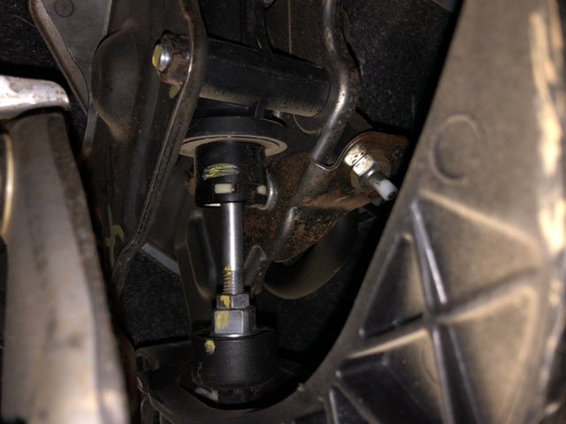

    76D0DA49-A049-4FA8-AC47-D7592A9AF2C1.jpg Mine does this too. There is something about this part and the paint marking. There’s a thread somewhere about it. I’ll see if I can’t find it. I followed the directions in that thread and it worked for a good while. I’ve just been too busy and lazy the last few months to look it back up and adjust it again. I just took this pic and rotated the shaft so the paint markings are where they are now. I’m about to head out and I’ll see if that had any affect on the squeak and report back later
    this is in the cab under the dash

    Just got done with my 3rd trip since I rotated that piston/shaft. Doesn’t make a sound. Now to get that TOB fixed.....
