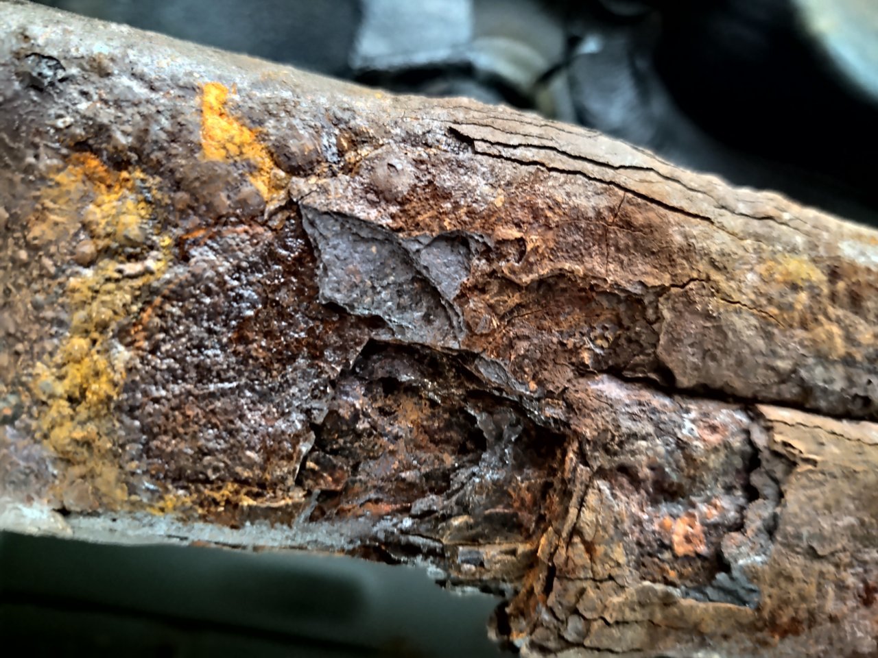

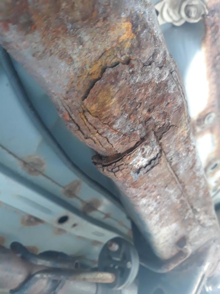

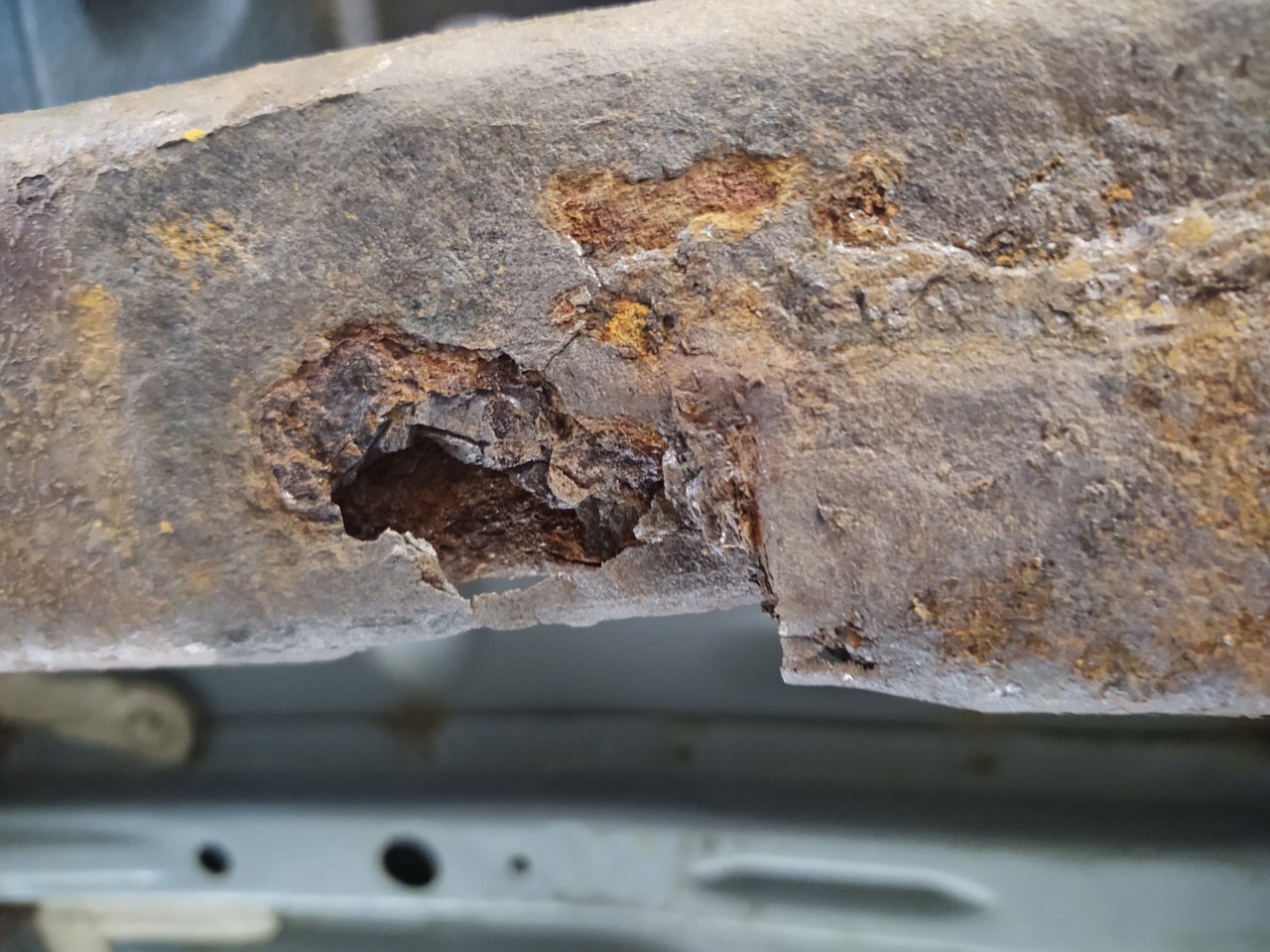

    Okay. Pictures before inspection, after inspection, and after scraping off the loose rust.
    CygnusX191 likes this.

    Cream puff with crap frame
    Oops error.last pic

    Oahu
    I would avoid saying that you scraped the rust off and then the hole appeared.
    Claiming the hammer test would be better.
    I have more pics of the front cab mount with a large hole in the mount and two in the frame where it's attached.
    So what is the hammer test? Someone else said that is only for out of warranty frames.

    Oahu
    It should be done for all frame inspections. It is what it sounds like. Strike the frame with a hammer while inspecting it. It's how the dealer is supposed to inspect them.
