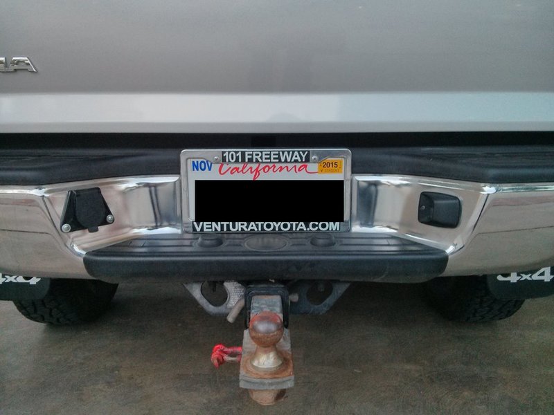

    Need to move my trailer harness, that thing is going to get ripped off down there. Saw some that were turned upside down, don't want to do that. Saw some that went through the license plate light or drilled next to it. Going this route unless I see something better. Ideas/Tips/Advice please!

    i put mine just to the right of the licence plate after the gravel ate the plug, i've seen a post where someone used a flip up licence plate holder ot hide the plug il try to find it

    How do you like it by the plate? Any issues? Pretty simple job?

    yes it reasonably flat there and easy to drill through tuck the wires up as high as you can and the spare protects the plug from trhe rocks

    The one I got? Bullala or bukaki something is beautiful and does. Perfect job. Cnc aluminum.
    60$?
    One thing I noticed was it caught a bit of water during the car wash.

    I put mine next to the plate. Used the hole saw from my door knob install set. Easy day, once you get past putting a hole saw to a 30k truck :)

    just pull out the driver side license plate light. with literally 2 minor cus to the plastic on the 7 pin plug it fits in the spot like a glove. 2 small holes for some nuts n bolts, boom done!

    Is one light instead of two less noticeable? I'm not a fan of being pulled over, last thing i want to do is give cops a legitimate reason to pull me over lol. U got a pic of the plate lit up?

    Its not bad at all, plate is lit up perfectly fine.
