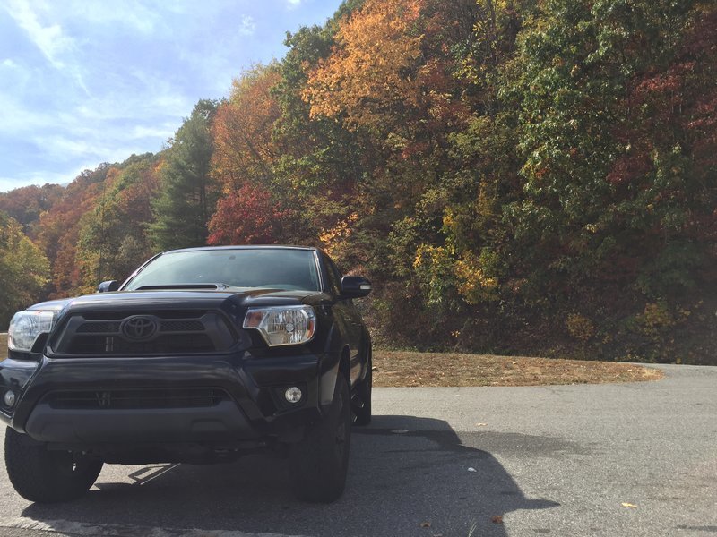

    While on my quest to "murder out" my Taco with my very rookie knowledge of parts and companies, I was wondering if there are any suggestions on certain companies and certain specifications for lighting assemblies? I'd obviously like to have a dark/smoke housing.
