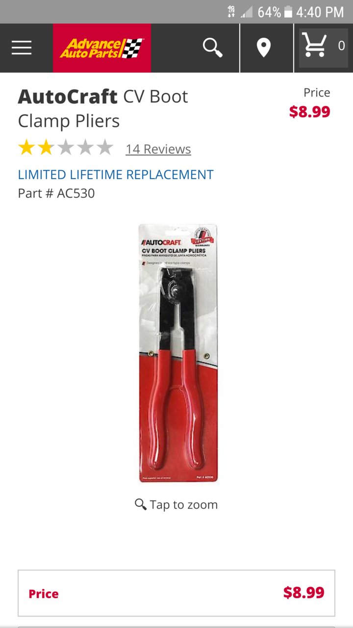

    Done it before with dull pair of Screenshot_20180625-164039.jpg dikes. The tool is only 9 bux.

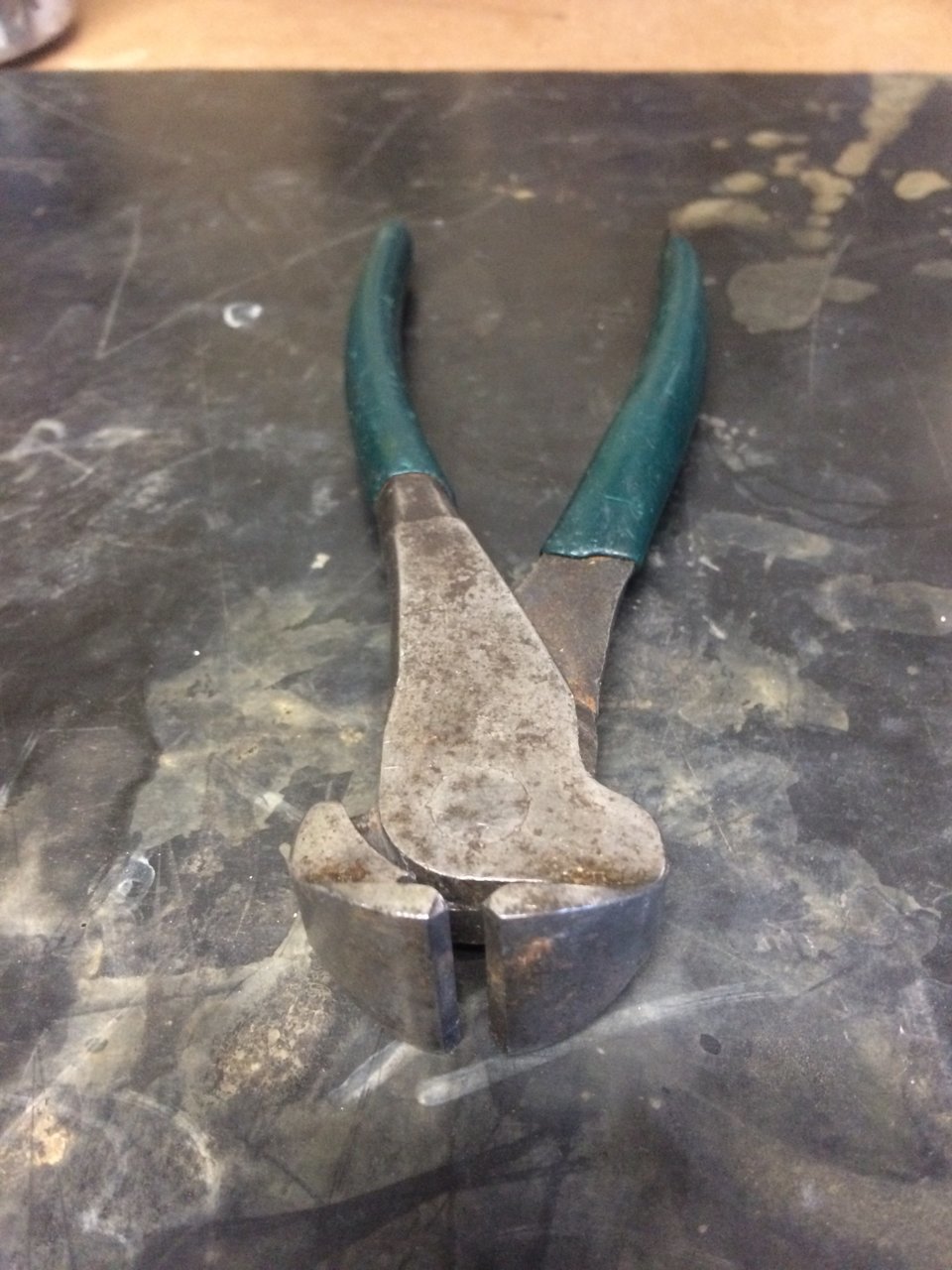

    10 Taco 4x4
    A bunch a cool stickers, a bada ass MetalMiller Tx Longhorns grill emblem painted Hemi Orange, JBA long tube headers with o2 sims, Diff breather mod, Red LED interior lights, Fancy head unit that plays ipod n movies, Also DIY install factory stuff like, factory cruise control, factory intermittent wipers, OME nitro struts with 886x springs and toy tec top plate, JBA high caster UCA's for better alignmnet and dey beefier too, Old Man Emu Dakar leaf springs in da rear with the gear, U bolt flipper, Ivan Stewart TRD rims with 33" K Bro 2's, some bad ass weather tech floor liners so I don't muck up my interior, an ATO shackle flipper for mo travel in da rear wit the gear, also super shiny Fox 2.0 shocks back there too, all sorts of steal armor for bouncing off of the rocks like demello sliders, AP front skid, trans skid, n transfer skid, demello gas tank skid, and a tough as nails ARB bumper with warn 8k winch, I'm sure there's more
    I bought these and broke em on the first crimp, and didn't even crimp. Whipped out my set of end dykes, did the job 100% better.

    $30, 20 years ago lol.
    I ordered one on Amazon. Will see how good it is.

    Ha. Two star review! No surprise. That’s why I asked: either buy a quality tool that I’ll likely use for a single job for $$$, or improvise.
    anyway I ordered a $17 version from Amazon. I’ll see how useful it is.

    A pair of end nippers, like you use to cut the nails to length on horse shoes works fine. If they can cut horse shoe nails, they will crimp those band clamps with ease.

    +1 on this I’ve been using these on a half dozen cv’s at least they work great. I put the handles in a vice for max power!
