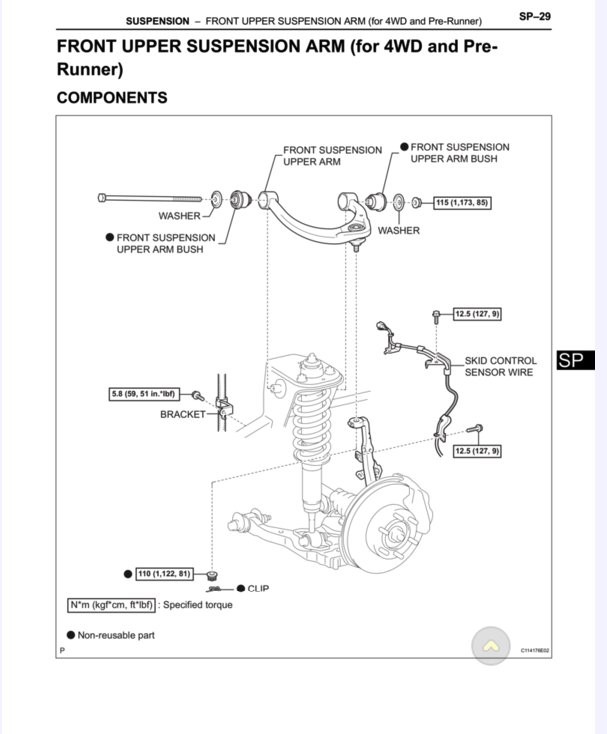

    I don't think so, there are also two bushings involved - see diagram below -
    In the diagram of the UCA expanded, it looks like there is the ball joint and then there are two bushings at either end of the UCA - on the diagram, these bushings are marked "non/reusable part" so they need to be replaced, probably more than the BJ [still feels weird to type that and not mean something else] since Toyota even thinks they are not reusable = taking it all out
    [i put a link to the thread with the rest of these diagrams earlier in this conversation]

    For those bushings, if you buy a new UCA it comes with those installed. So I think if you buy a UCA with BJs installed, you can do it all with simple tools, no press required.

    But go thru those diagrams and look at what is marked non/reusable - make sure you got it all - the goal is to do this once, and not have to sweat it for another 72K

    The OEM replacement UCA will come with the bushings and ball joint installed.

    Any aftermarket UCA will have the ball joint pressed as well.
    If the current ball joints and bushings are not shot just start saving to replace them later. It isn't really much more work so don't feel like you're better off doing it now, especially if you're doing the work yourself.

    you are Barely lifting your truck, so there is no reason to get aftermarket uca. If you want to, great. If not, no need.
    your stock uca are still fine. Lot of people go 200k with stock uca and their ball joints are fine and so are the bushings.
    pressing in new ball joint and bushings is not worth it at all on the stock uca. You can get like new take off from 3rd gen Tacoma’s uca that have like 5k miles for about $50 if you really do want to “refresh” your suspension.

    I plan to take the front wheels off once it warms up and inspect the ball joints. If all good, I’m leaving them (and the UCAs). Only reason to replace the UCAs was if I was going to replace the ball joints anyway.
