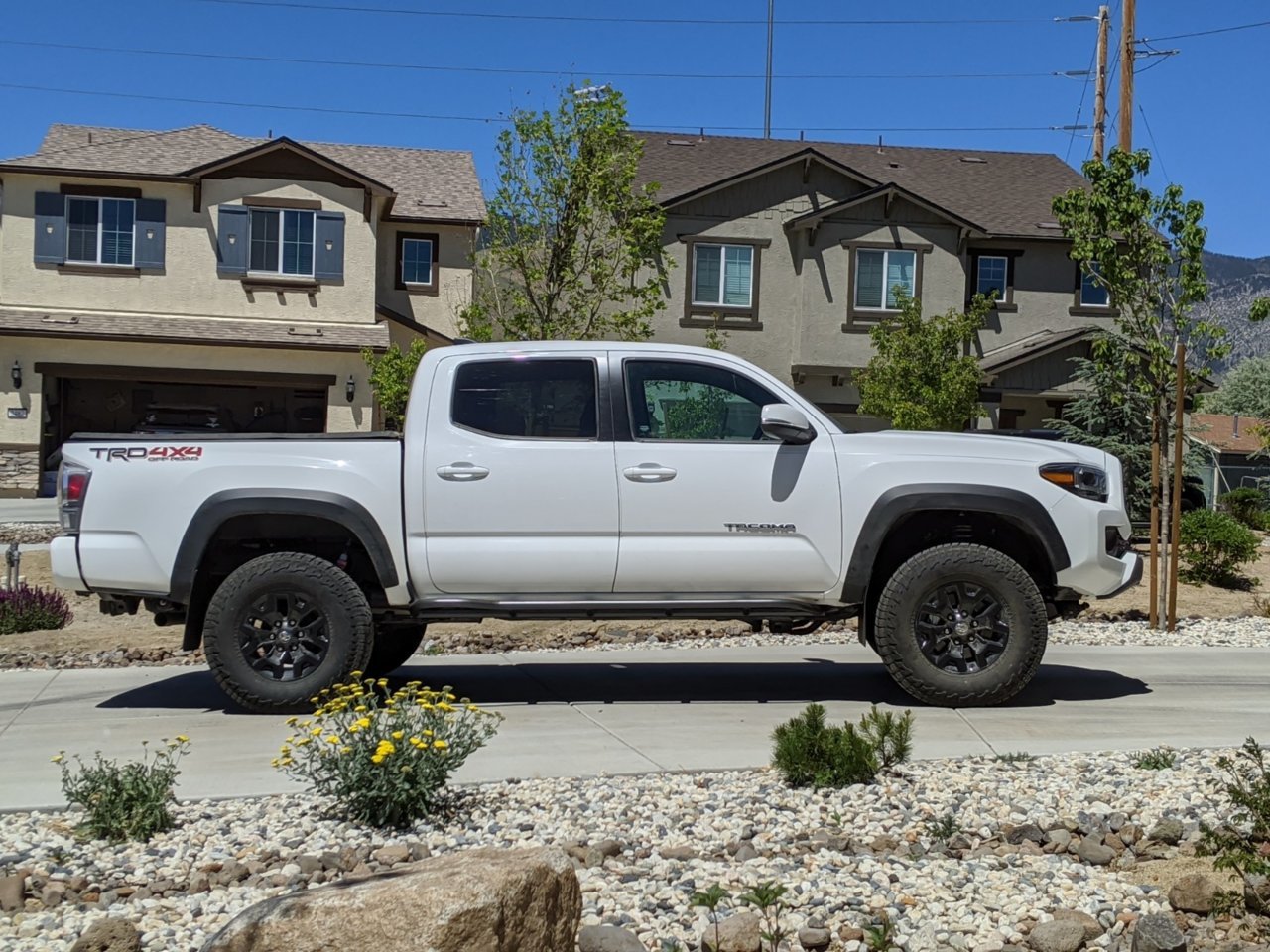

    End result. Not the greatest photo but at least it's a decent side shot - I think.
    Got the Eibach Pro Kit, Headstrong 3 leaf, 4xInnovation sliders welded on somewhere around 20 degree, Rek Gen mud guards and covered up the shiny stuff on the wheels with vinyl because I like. Didn't get the Taco lean fix because I don't care.
    Falkon Wildpeaks 265/75 R16 SL. I am not quite sure yet that it was the better choice over LT but I'm going to have that judgement made for me by the time it takes to pop the first tire.
    The guy who welded the sliders and installed the suspension kit test drove the truck and said he was pretty satisfied with the combo I chose for what I want to do and how he thinks it performs. Hes' been doing this forever and is a bit of a local celebrity. He does the work on the local Search and Rescue vehicles, so I am sure he didn't take any shortcuts.
    I am glad this is done. It really was pretty stressful having to make all these decisions coming fro a zero knowledge background. I am getting repetitive here but I can't help but repeat: Thank you so much for steering me into the right direction. This forum is awesome!
    I am thinking about adding a light weight skid plate sometime in the future but that can wait. Dude told me that the stock thingy is actually a lot more useful than it looks because of the support bars underneath.
