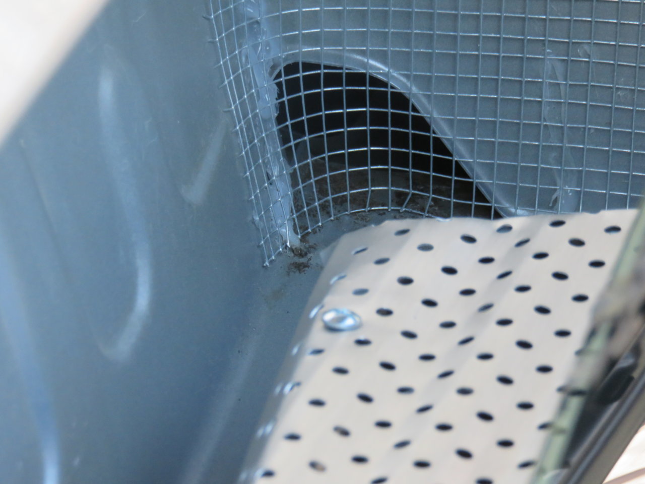

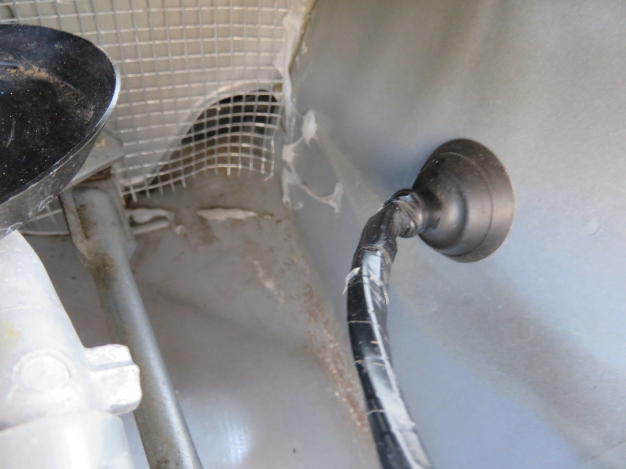

    First I apologize for the long post.......Several have posted issues with mice, rats, squirrels in our Tacomas. As some of you know I am fortunate to live on 28 acres in West Virginia, however this is inevitable for mice. My shop/ garage has mice living under the floor and in the roof and I am sure they have been there for years. We bought the property in 2019. I am doing what I can to control this. They is no trash or any type of food or water in the shop. I keep the truck in the garage and leave the hood up and have had good luck with cotton balls soaked in peppermint. I do not drive it as much due to working from home but I check it daily and ensure it has no signs of critters. The other day I looked in the passenger side front and immediately saw shredded foam on my floor mat. First time any signs of them inside, I was pissed and stressed out. I HATE mice! Now one got inside. Opened up the cabin filter door and one had been chewing and I think I caught it before any real activity. I checked everything else and no other sign. Replaced the filter, Cleaned it out and vacuumed everything. I bought some gutter guard to cover the fresh air opening in the cowl. Many have done this and I took their advice. I covered it and checked my air filter box as well. Acorns under my air filter. I think these were from before I started using peppermint because they were whole and nothing else was in there.
    A few things I noticed is the hole in the fender directly into the airbox, obviously the point of entry. Also in the cowl area an entry point on both ends. I put guard over this but before buttoning everything up, I decided to remove those due to thinking water will not be able to escape and possibly cause issues.
    With the 3rd gen they did a half ass job of a screen that was not on previous generations. However as you will see it was chewed through and that is how it got to the cabin filter.
    As stated I know people have posted, so nothing new but hopefully this is seen by someone not aware of this issue and helps them out. Due to current conditions people are driving their trucks less and if you catch it early you can save yourself from some major damage like others have posted with wiring.

    I don't recommend screening off the side holes in the cowl at each fender, eventually you'll have debris buildup and water drainage issues.
    The air intake at the fender and cabin vent should be screened off imo.

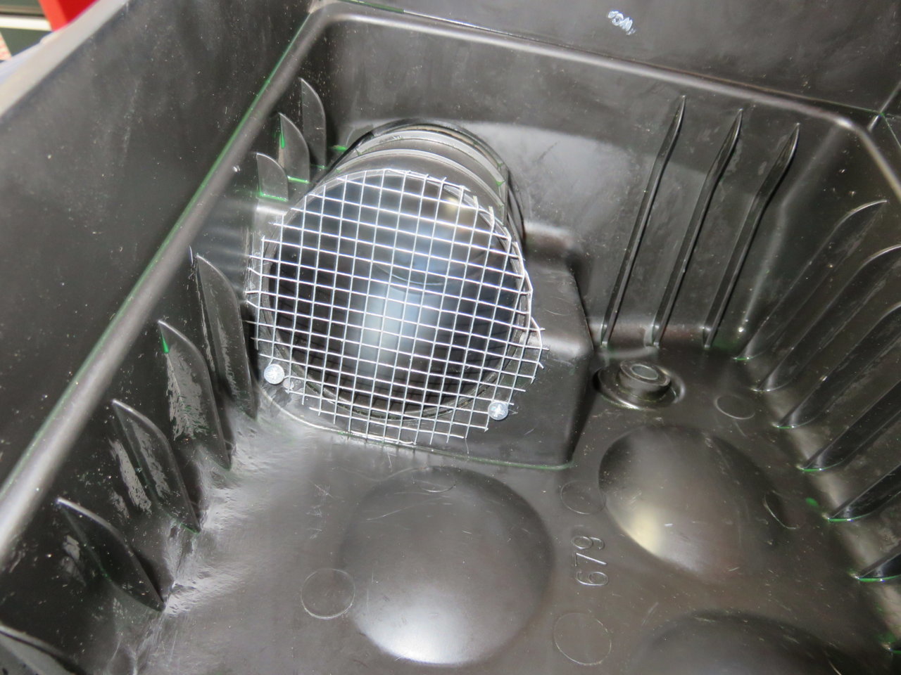

    For the engine air intake you can do this to keep critters out of the air cleaner housing:

    I've done the same for my 15 year old polaris snowmobile. Use steel wool in the exhaust also.

    Thanks for the write up and the links, Scott. This gives me the motivation to get mine done. Question: The fourth picture looks like the passenger side cowl area (with the plastic removed). That vertical piece of metal is covering a big gaping hole? Is that how you think they got in to the plastic mesh installed by Toyota? Curious to know before I start dismantling and head to the hardware store to get some supplies.
    Thanks again!
