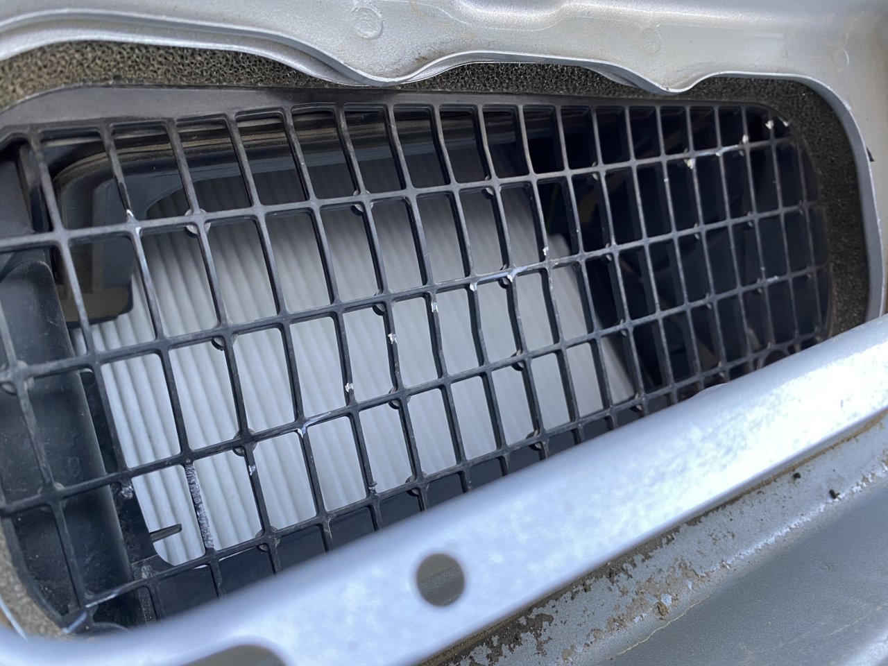

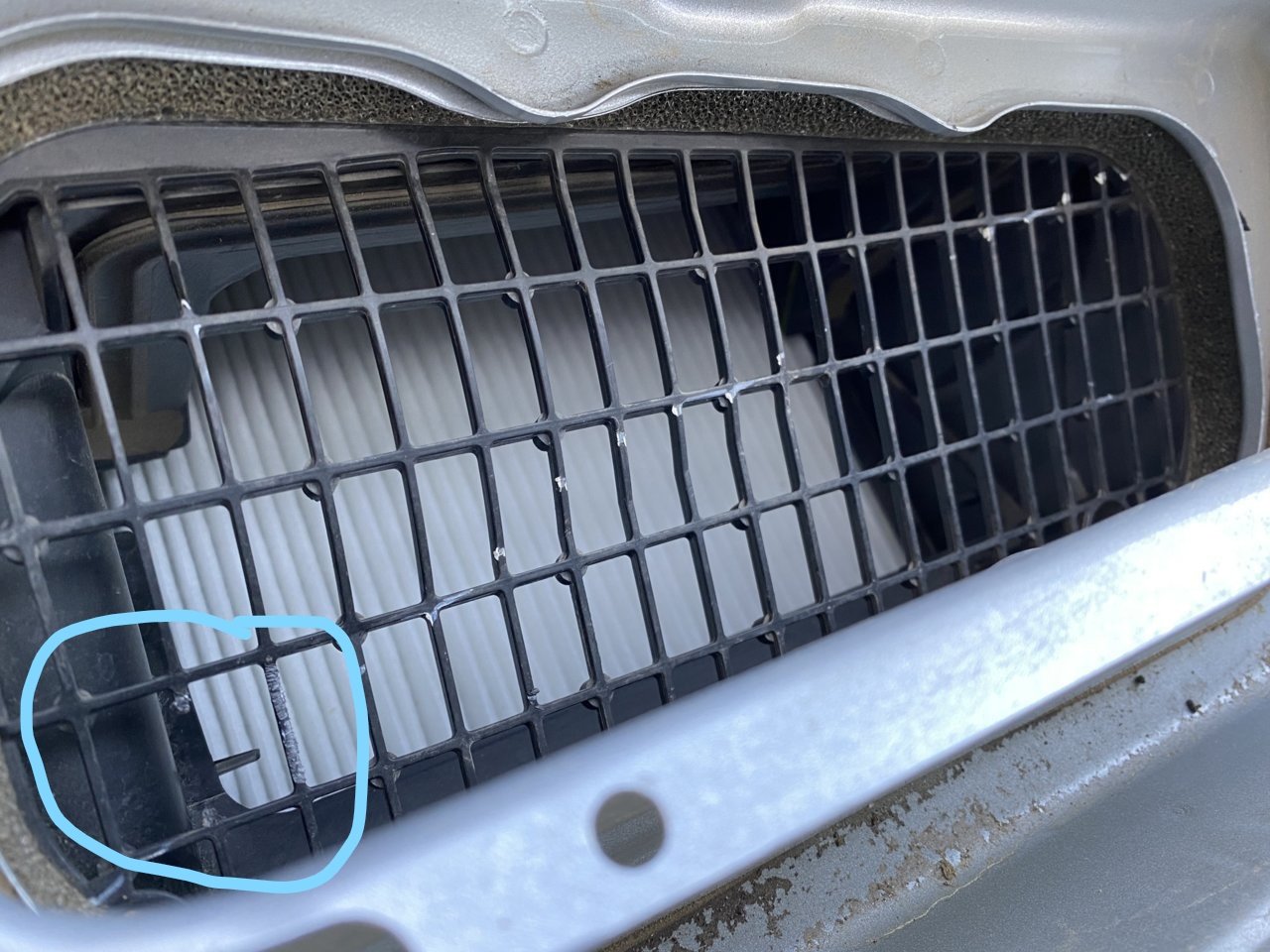

    Yes, once you take the cowl off look in both the driver and passenger far corners of the cowl area. There is a large hole with direct access from the fender, same access where the air filter box is cut farther down the fender well. I put that vertical piece on but the removed it due to any water will not be able to exit the cowl, you will see once the cowl is off. I am going to put fine mesh there instead so water can still flow out if it gets in there, rain/snow. They are entering the cowl area there, then have access to the large hole for your fresh air intake and cabin filter/blower motor. You will see in the pic where I circled in blue. That is where it chewed the plastic mesh and entered. Also that mesh is not very small and small mice should be able to just scoot right through it.

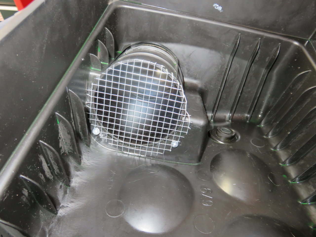

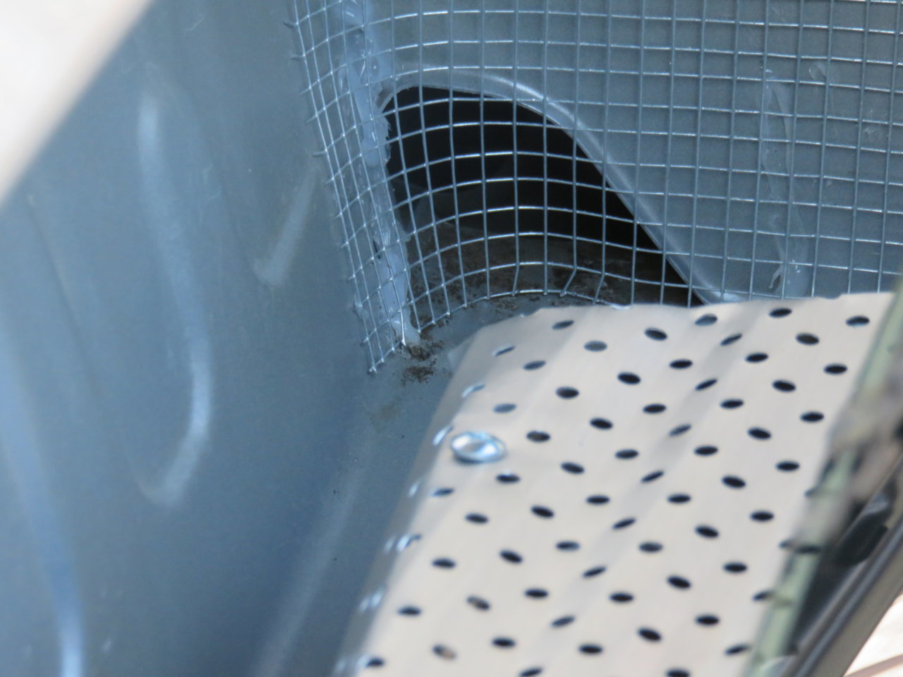

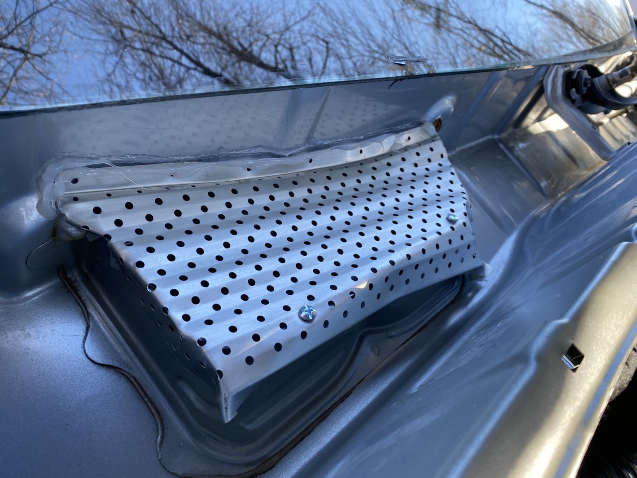

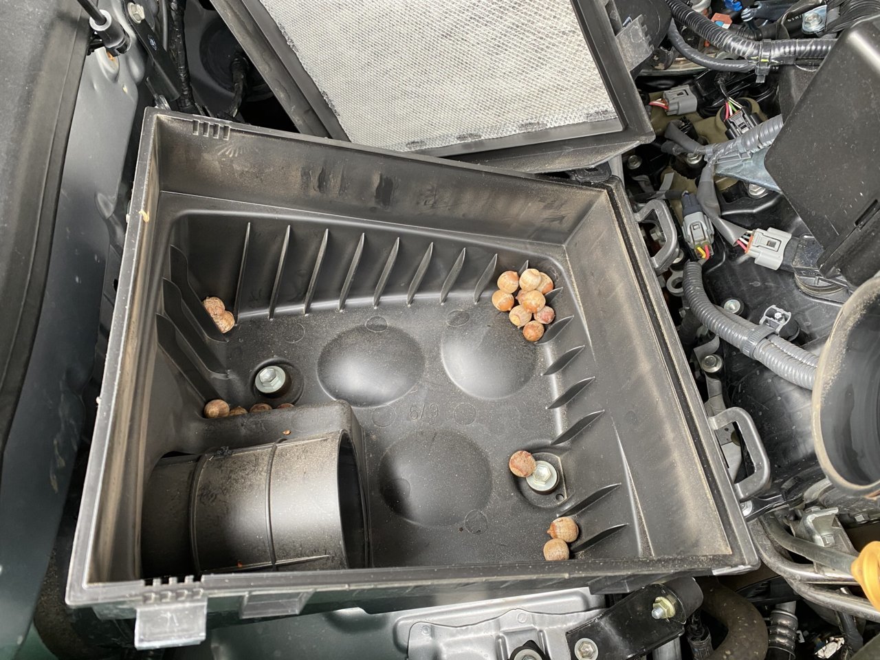

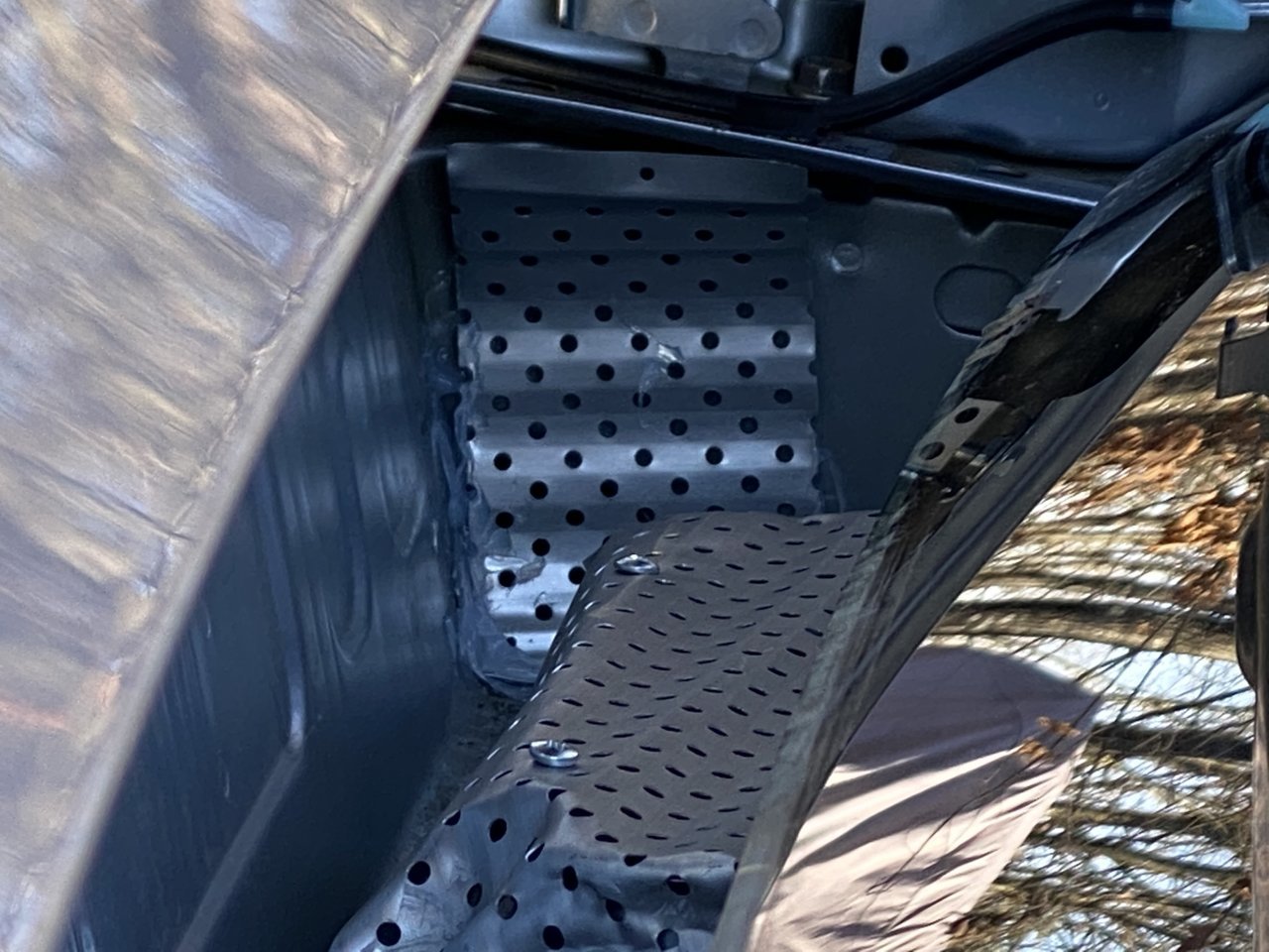

    More work today, took care of the holes in the cowel and the Airbox...............

    Awesome! Stellar job. The pictures are especially helpful for someone like myself who is new to this.
