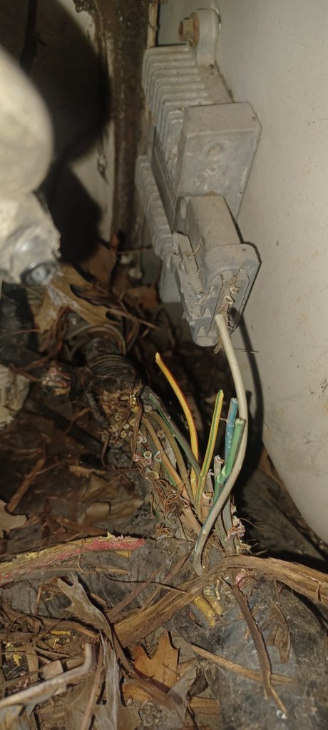

    92 f250 ruined, was worth something but it's going to scrap yard now. No harnesses to be had. Sad Has a 351 and a manual trans. Vermin

    Rodents will eat anything & everything....
    Its a 2004, theyre not lying to you, or trying to cover-up anything that the manufacturer would have to pay for....
    Theres no conspericies going on here.....
    Get your rodent situation under control, or it will just happen again, & again, & again....
    Ive had to replace the same NOX sensors on an f150 eco boost 3 times for a customer a week apart each time, which required remove intake manifold assy, coolant distribution time that isnt fun to get to, all the DI fuel injectors & fuel rails to access the NOX sensors....
    & reassemble...

    That connector can still be purchased....
    & the wiring harness can easily be repaired...
    But appears you just let it go at this point & they probably overtaken the entire vehicle....

    Yeah it had been sitting for awhile, and it was a dawg with other fleas and that harness pushed it over the "its getting to be a big hassle" limit. It's going away sold are junked.
