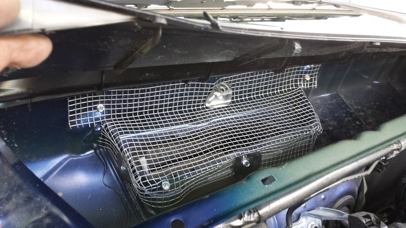

    Yep happened to me as well. I covered the air intake with a course screen.

    Here's a pic of my screen work. If you open the hood this inlet is in the vicinity immediately above the glove compartment. You have to remove one tab that holds the plastic covering the inlet ( generally below the passenger windshield wiper).
