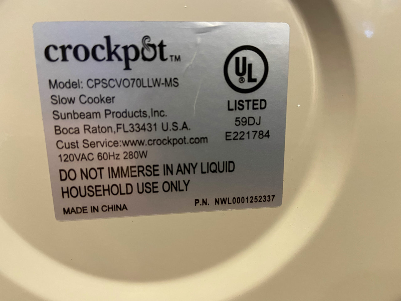

    The crockpot should have a UL sticker on it that shows the power consumption. Without knowing that your question cannot be answered.

    SO...280 Watts? Is that the max with the crockpot on high? I am cooking the chili at home in a roaster, the crock pot will be just to keep it warm for 1.5-2 hours.
    Also, what happens if it draws too much? Is there a "GFCI" style breaker in the system, or will I need a new fuse?

    The UL rating will be set on the maximum power draw.
    Cook your chili at home.
    Set the crockpot on LOW, the Taco should keep it warm.

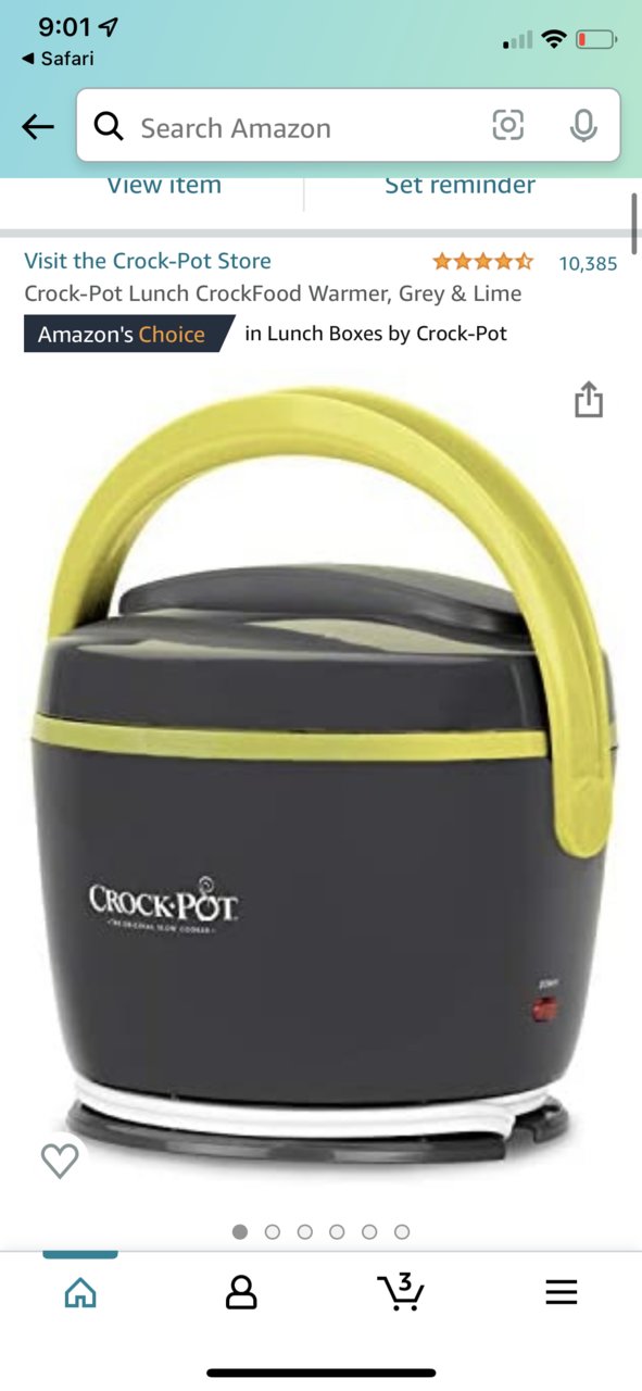

    I’ve used this little 20oz crock pot while out camping and off-roading. It draws 50watts so you can’t go much higher than this if you plan on using it while driving unless you have the 400w anytime mod.
