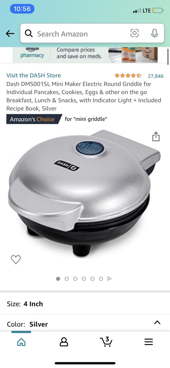

    I like this little one!
    I can connect a 3 outlet surge protector cord and have the mini going with some nacho cheese while my crockpot has the chili.
