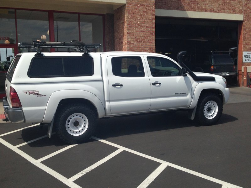

    Right when I first got her.

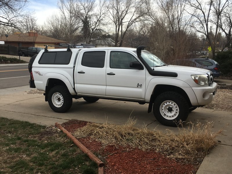

    Picked up a topper for her
    Snorkel time

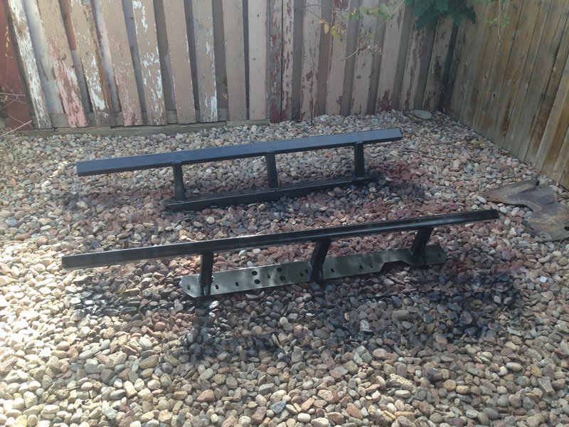

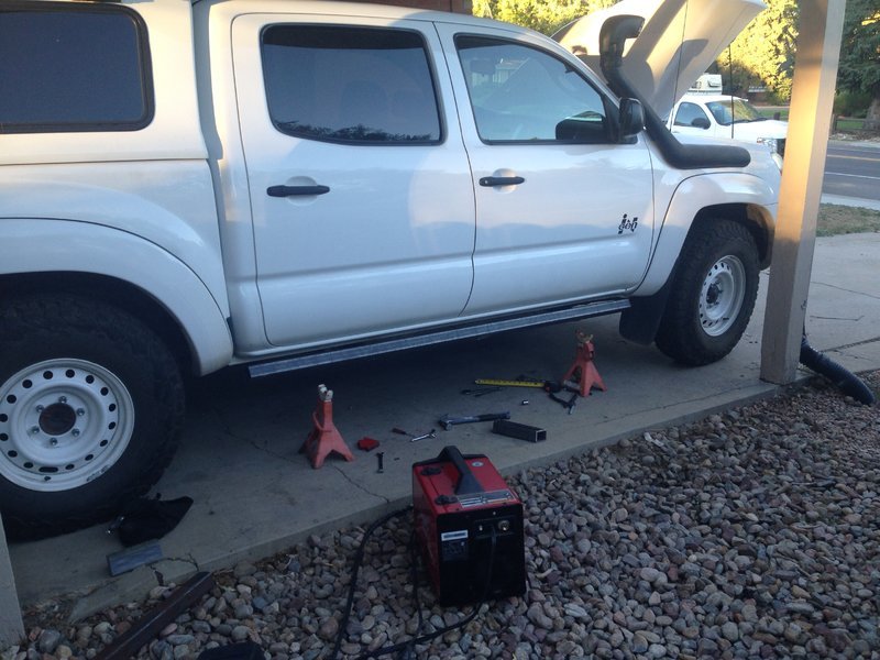

    Built some 2x3 rectangular bolt on slider.

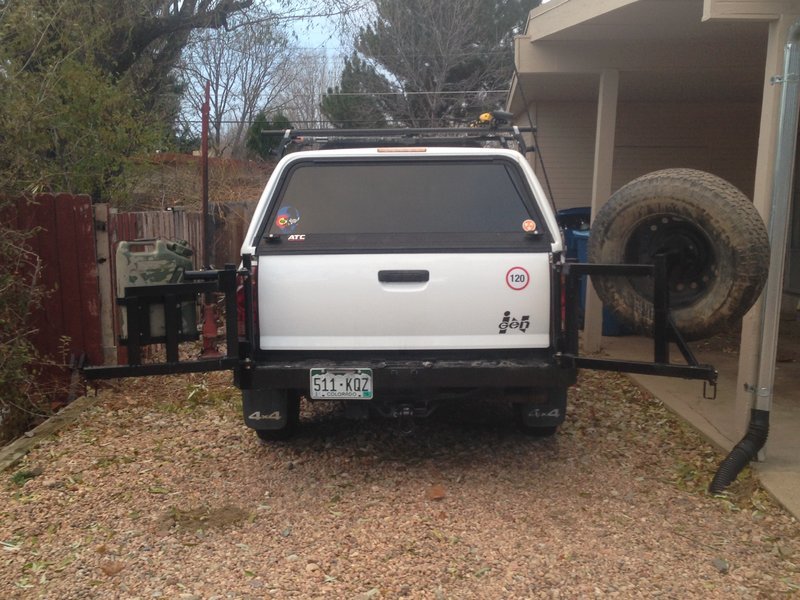

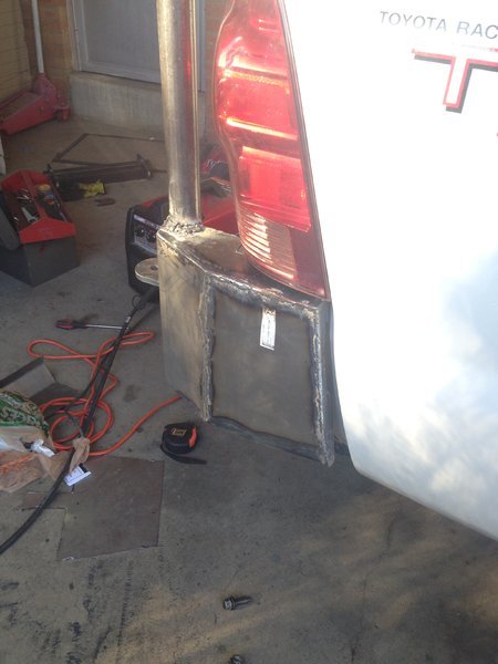

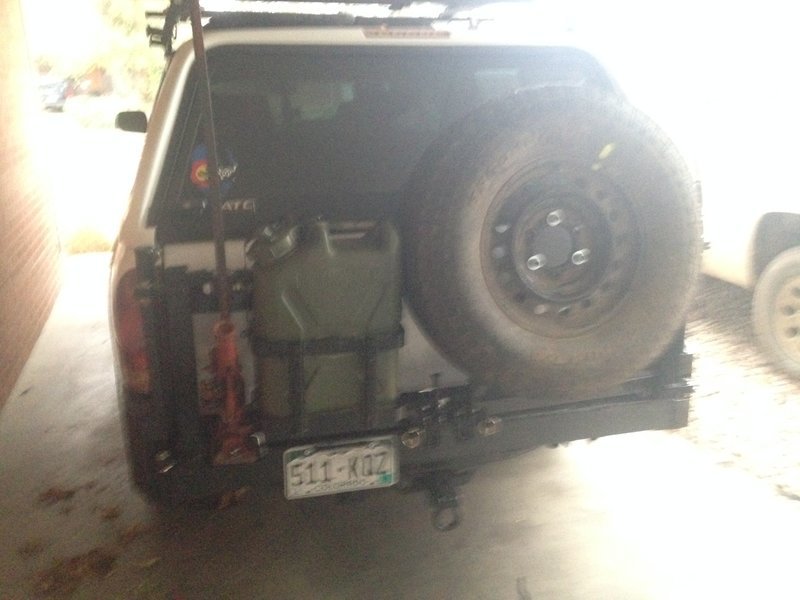

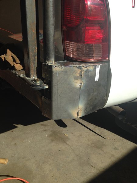

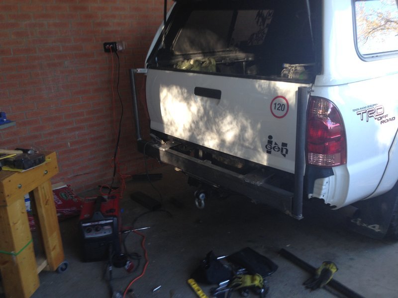

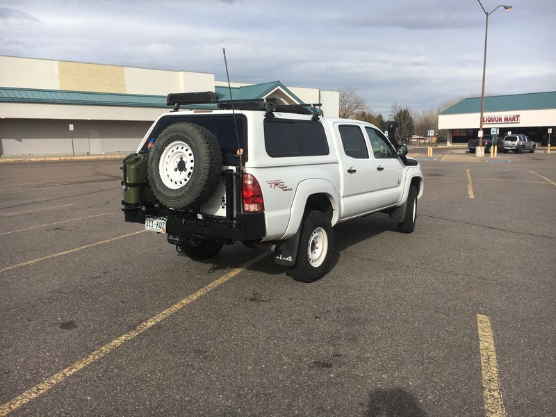

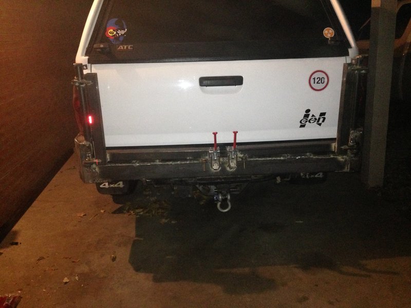

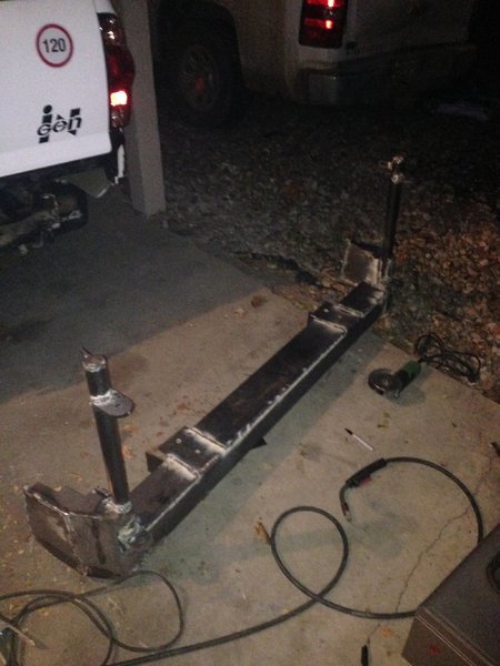

    Built a dual rear swing out bumper:
    Main tube is 2x4 rectangular tube
    ramonortiz55 and DrFunker like this.

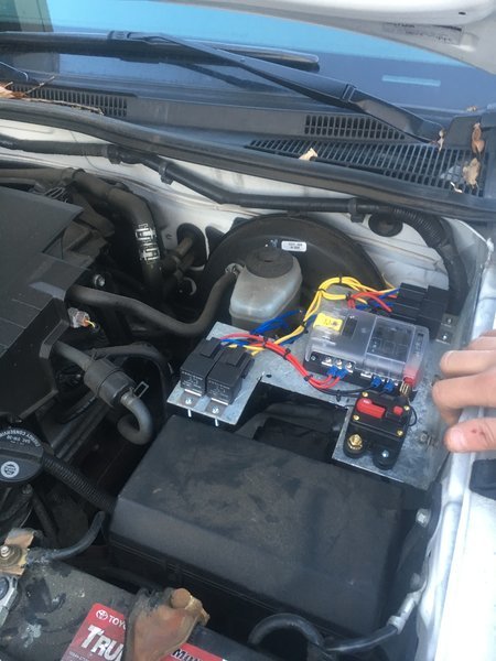

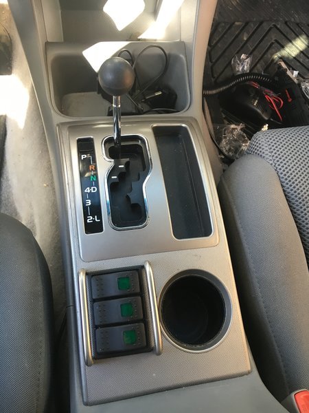

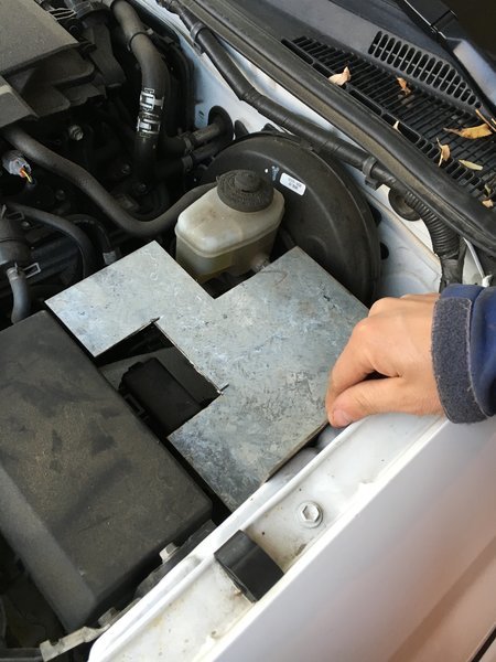

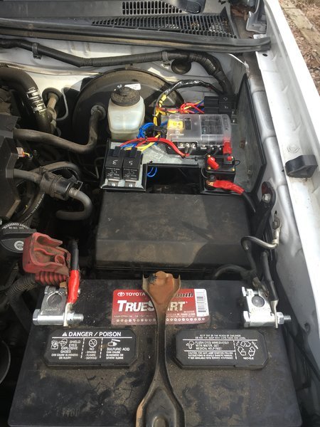

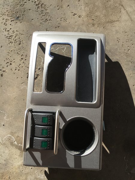

    Started doing electrical wiring for the truck, just wanted to get this done once, so I went a little overboard
    So far we have:
    Abs disable
    Winch arm
    Winch in/out
    Front lights
    Rear lights
    And ?

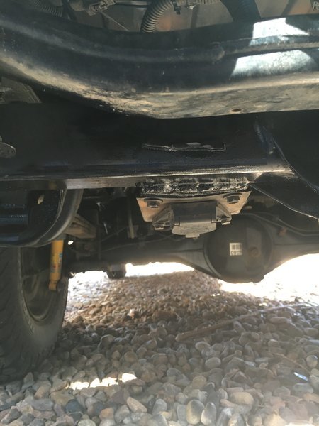

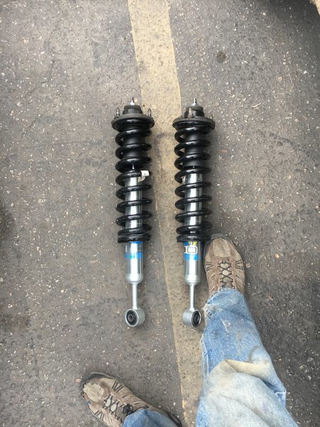

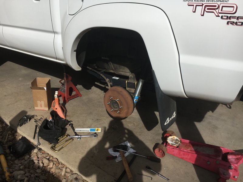

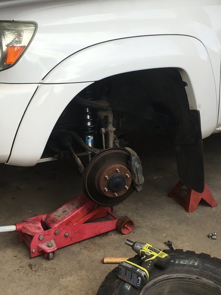

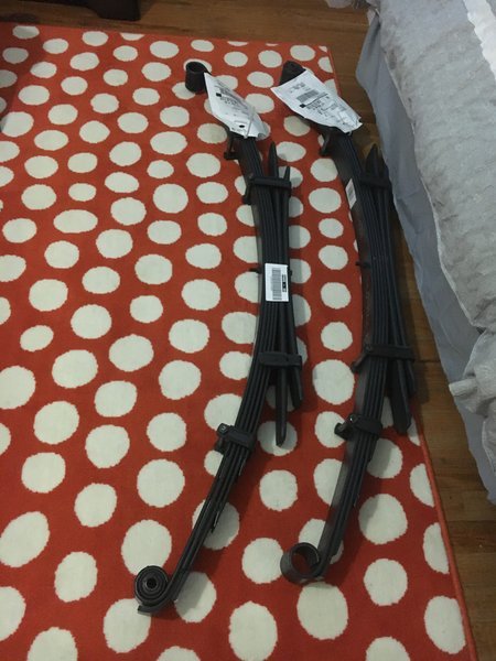

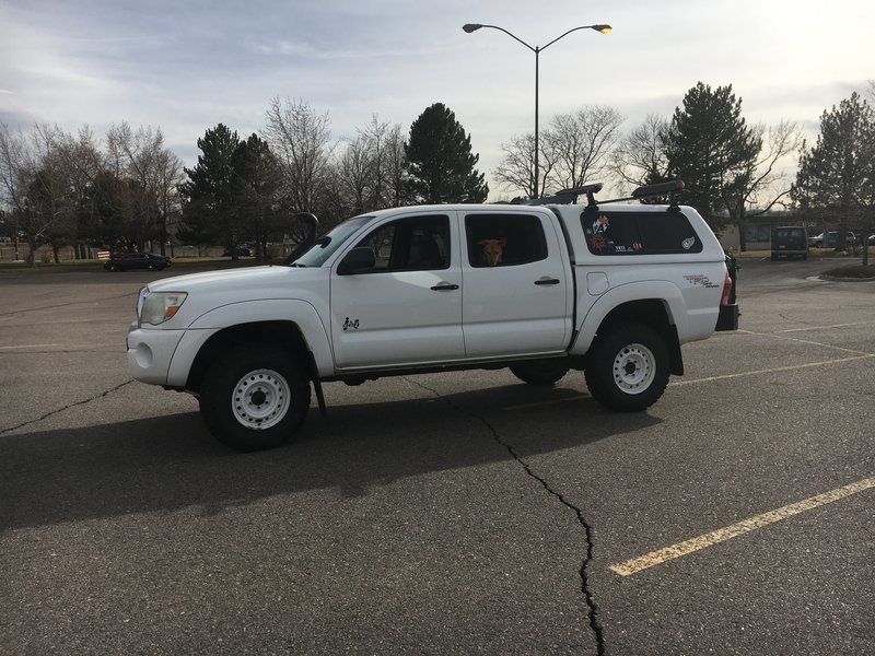

    Lifted her today:
    Ome Dakar springs, one 885, and bilstein 5100 all around. Bad news is after lifting found a 30-40 mph vibration that goes away with putting it in 4wd. So looks like I'll be replacing the drivers side axle bearing soon.

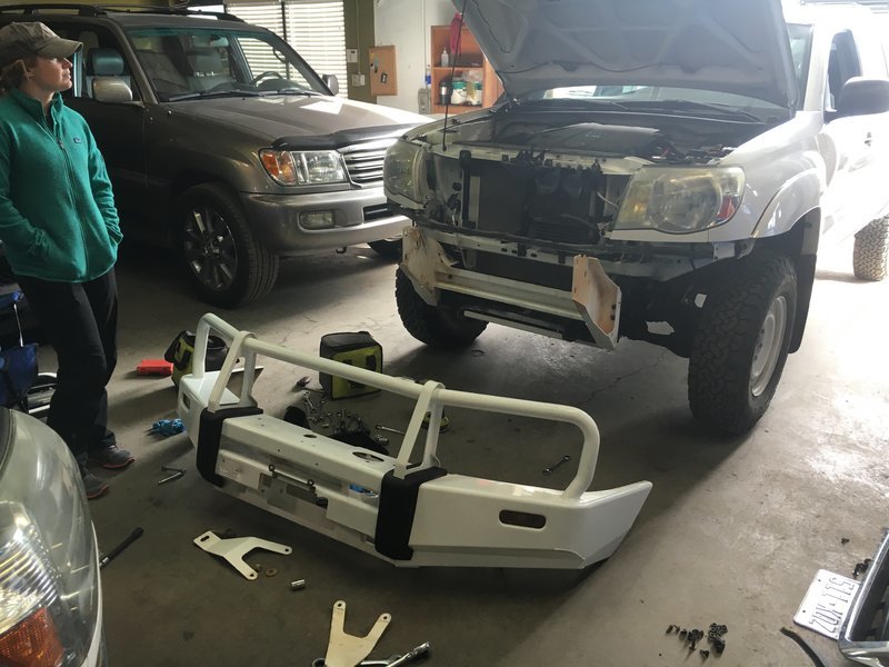

    Unsuspecting craigslist find
    Leppz, DrFunker and FIRE74 like this.
