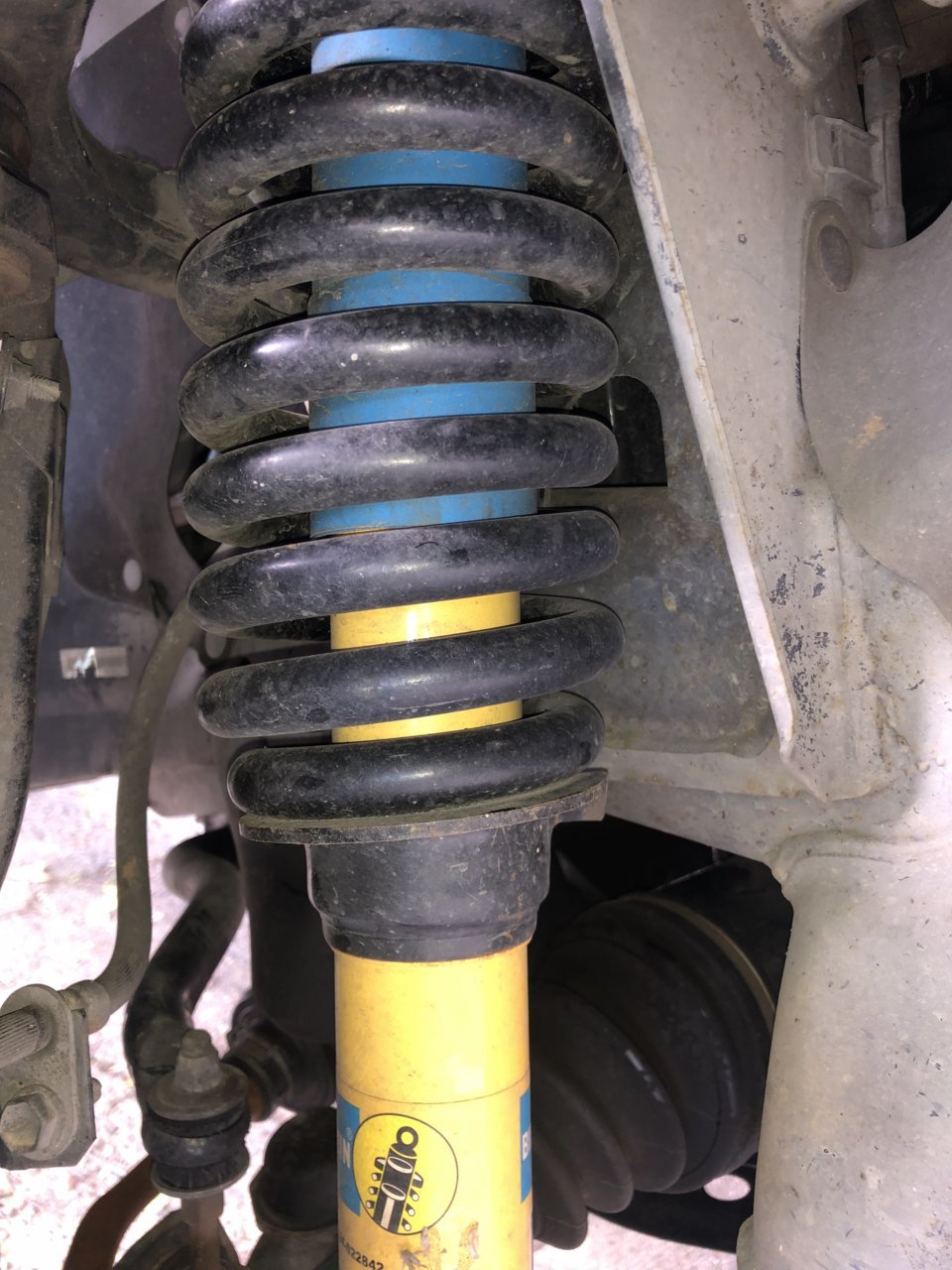

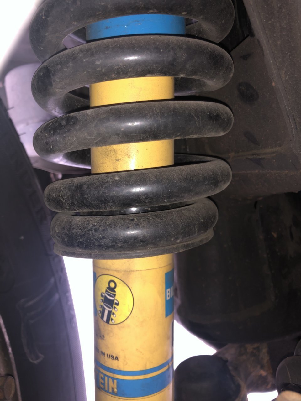

    Here’s a link to pics. Sorry they kind of suck. I was crawling around taking them on my way out the door to work.

    The only thing that sticks out at a quick glance, is the top hat in picture looks like it is not seated properly with the spring.

    2000 Tacoma SR5 TRD V6 3.4 5MT
    Yeah I noticed that too.

    Your seat is upside down

    This one looks good

    That wouldnt affect the top hat like that though. I am not saying it's a problem. Just saying it looks odd and to watch it for extra wear and tear.
    Edit..... problem located. Gotta flip that spring seat on the one side.

    Yup, it sure as hell is. Good eye... I was trying to look in between stop lights .lol

    Yep, and that's on the passenger side, too. That'll do it.

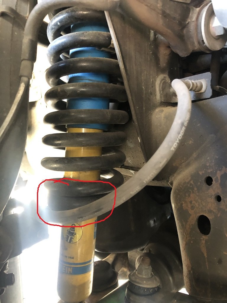

    @pontoon, on the driver side coil, what is that at the bottom of the coil? That looks like a spacer stuffed between the bottom of the coil and the spring perch (the thing that is up-side-down on the other side).

    I think that’s just two coils compressed against each other. I’ll check when I get home. That’s the side that’s downhill.

    Yeah, the coils shouldn't be touching each other, especially at ride height, and that looks fatter than the thickness of a coil. But, hard to tell in that pic.

    Omg I finally see it now that I went back to take another look!!! Thank you!
