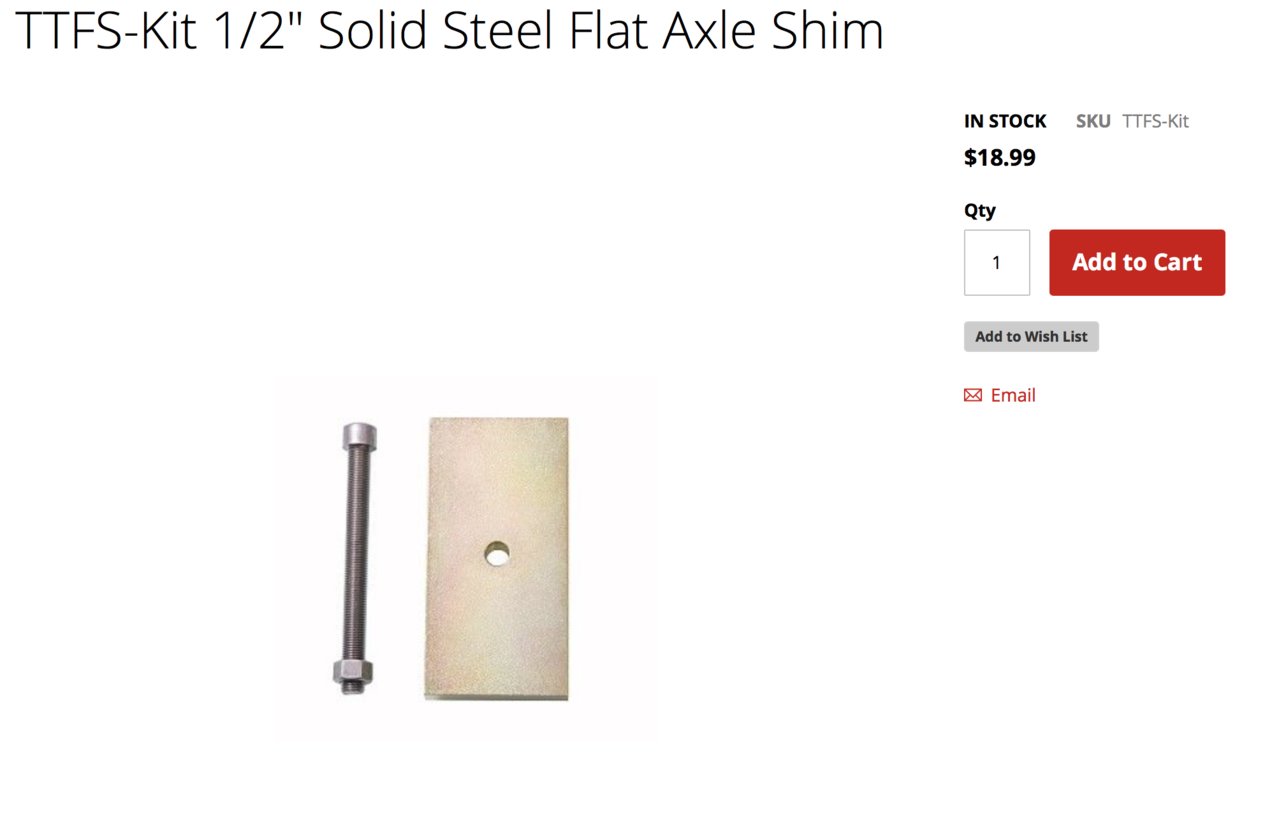

    Some people say it does but in my experience, even though the front is level the rear sags to the driver's side especially when my gas tank is full, so I've got a small 1/2" spacer for the rear as well.

    This is what I got to correct the rear lean... Screen Shot 2019-03-22 at 12.21.23 PM.jpg
    It's just a small steel block, enough to help with the lean but not enough to notice any real difference in ride quality.

    Definitely confirm they're on the right side first but if they are and they still sag, I'd look into that spacer. Or maybe even an AAL if the sag is bad enough

    If you are to the point of needing an AAL on one side to counteract lean, take that crap back to Alcan and demand the correct springs.
