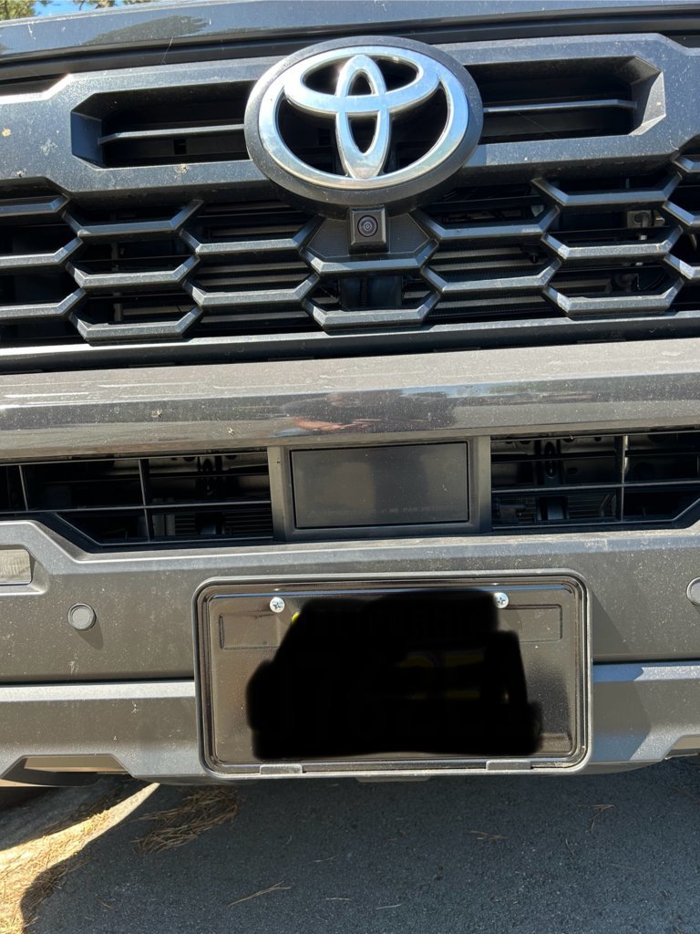

    This bugs the crap out of me…either the factory, or the port, or the dealer attached my license plate holder crooked. Anyone got any good ideas on how to remedy it? The screws are self-tapped into the plastic, and the holder cannot move up or down.

    Move the whole plate up until it's flush with the top edge of the bumper?
    That way you know it's "level".

    I would remove it and oblong one of the holes in the bracket itself with a file, bur bit, or drill bit. Reinstall and use the slotted hole to level it before tightening it down. The license plate will hide the fact the mounting screws are still crooked but the plate will be straight

    The back of the plate holder is profiled to sit in that seam behind it. If moved up it doesn’t sit flush.

    Thanks - that might be the trick :thumbsup:

    Pretty sure it's the dealer who does that, at least mine was done by the dealer. That really sucks, but I couldn't trust them to fix it.

    Your correct that’s a dealer thing , dealership did that to the rear of mine when they were putting their dealership tag holder on. :annoyed:

    Id make them buy me a whole new whatever that piece is with the crooked holes in it. All new and start over.

    Or get some of these and make sure you cut the square holes level. Should be able to cut with an exacto knife.
