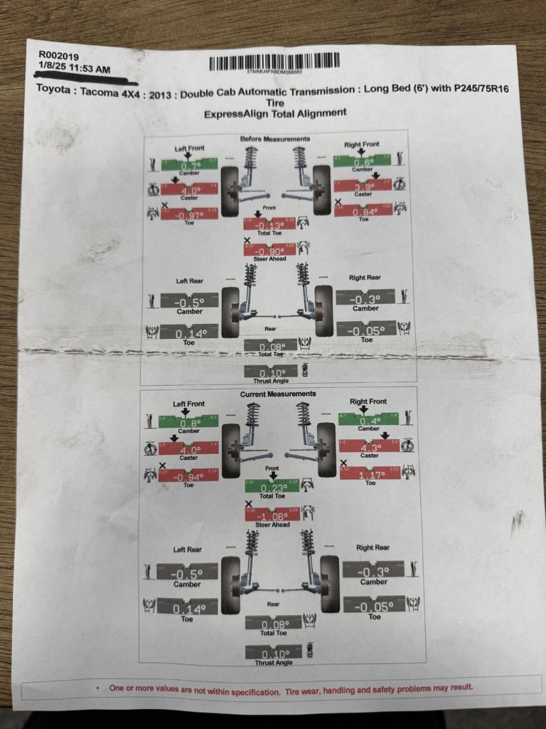

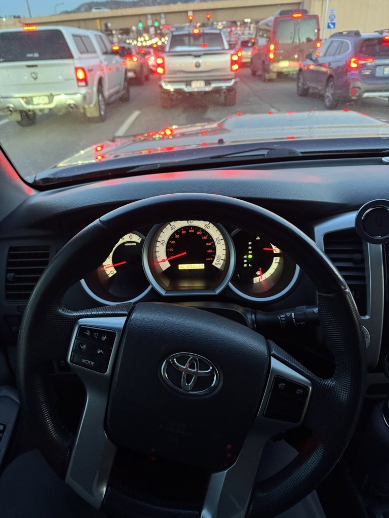

    Hey guys!
    I recently smoked a curb after turning a corner on ice and now my steering wheel is crooked:) I hit the curb almost parallel to the rim at 10mph or less.
    The truck drives mostly straight still with the tilted wheel surprisingly. I mistakenly took it to discount tire for an alignment and the ramrod could not get the jam nut free on the tie-rod then gave up and somehow made the toe worse. I jacked it up when I got home and found the drivers side tie rod has some new play in it while shaking the tire at 3 and 9 positions but found nothing to be obviously bent.
    From the initial alignment reading, it looks like I shifted the whole steering off ~1 degree on both sides to one direction (which makes sense as to why it drives semi-straight still). Can anyone explain how this happened? Did the steering gear slip a few teeth or is something I'm not seeing internally damaged possibly? I'm not entirely keen on the inner working of the steering assembly so any insight would be greatly appreciated!
    I'm trying another shop tonight to see if they're more competent than discount tire as to what needs done but will soon replace the outer tie-rods myself as it seems simple enough (maybe inners too?).

    I would guess your steering rack shifted over a bit.
