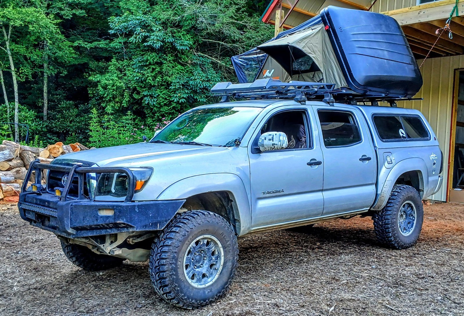

    Anyway im about to drive across the country from north Carolina to California. I've been building up my taco for the journey and wondering what basic maintenance I should do before embarking.
    2007 tacoma with 220k miles.
