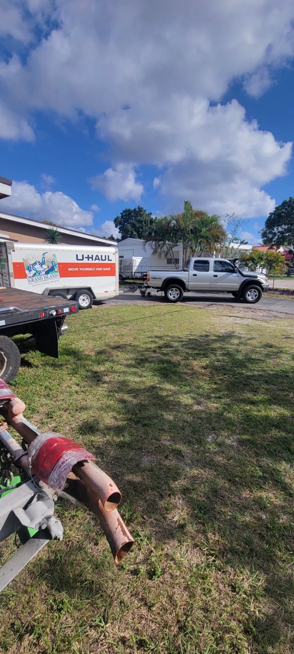

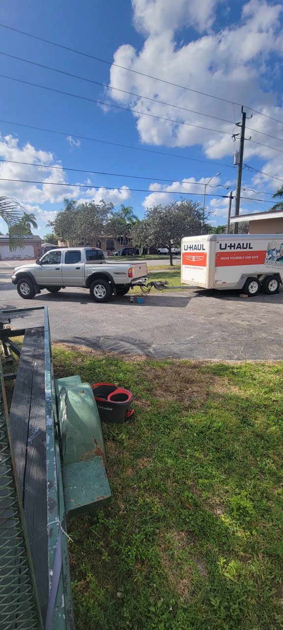

    So I figured I'd document as much as I can from this cross country trip I'm doing from Miami, Florida to Tucson, Arizona.
    Truck: 2003 Tacoma PreRunner 3.4 RWD.
    Mods:
    Complete OME Heavy Duty Suspension.
    Hitch and hitch lights installed.
    Max Tow Rating 5000 lbs.
    Green HD Clutch fan installed.
    External cooler installed "Hayden 678".
    Replaced old Radiator with new Denso radiator.
    Coolant flush
    Timing belt, water pump changed. (Along with everything else you can do while replacing timing belt.)
    Safari SS135R installed.
    Air filter changed.
    Airaid AIR-510-934.
    New spark plugs
    New spark plug coils
    Oil changed
    Oil filter changed
    Fuel filter changed
    Transmission fluid changed
    Rear differential oil changed
    Cargo approximate weight (this includes trailer, food, water, myself, and other miscellaneous stuff.
    Approximately 3,500 lbs worth of stuff. 1500 lbs below maximum tow weight. (Probably less than that. This includes the trailer empty.)
    Trailer used: Uhaul 6x12
    So I pretty much followed the Tacoma Towing Bible. About 90% of the things that post mentioned I did.
    Here's a view of my truck from drive and passenger side.
    I will be departing after sunset so I can avoid the insane south Florida traffic and the hottest part of the day.
    I am open to questions and advice.

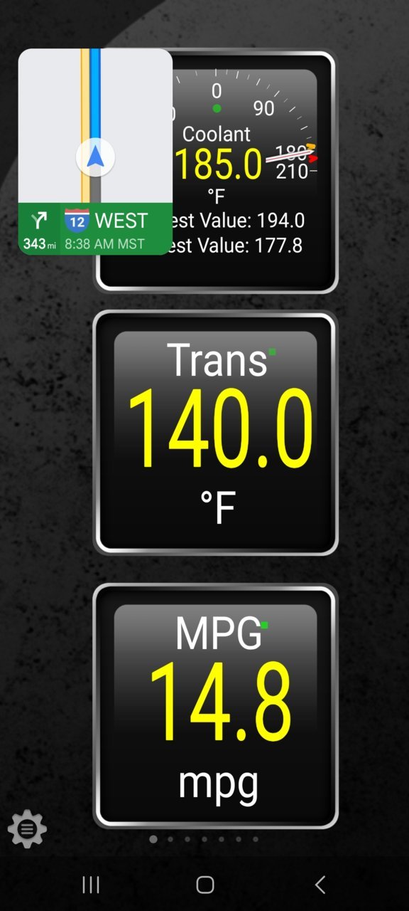

    The only other thing I would have added (maybe you did, and I missed it) is a scan gauge, so you can actually get the coolant and ATF temps.
    Good luck on your journey!

    It will be interesting to read about this when you are done. Good luck! Those trailers with double axles like that really pull nice and don't put a huge amount of tongue weight on the pickup. I bet you'll be getting 13-14mpg. Maybe a little better if there are not a lot of hills but it should do just fine.

    Update:
    My truck is doing very well running dependently MPG is ok.
    I had to switch trailers from a 6x12 to a 5x8.
    The 6x12 trailer's braking system was faulty and I was burning up my own brakes. The only thing where I was that they had in stock was a 5x8.
    MPG with 5x8 improved significantly as well as drivability.
    Coasting with OD off at 55-60 mph.
