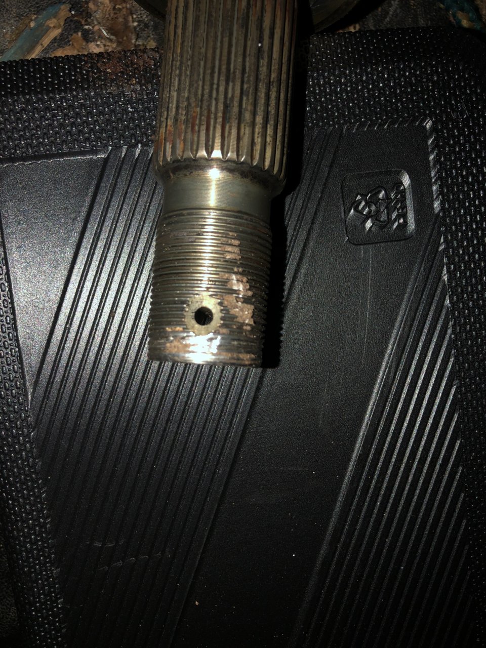

    85E5CA3E-EA3A-4314-98DE-02EE0850666D.jpg Can you see it it’s dark outside haha but it’s right up to it

    That's repairable and safe to do. It has not gone past the cotter pin which means that when you get the new bolt in all the thread will catch which is what you want.

    You need to find out the size and thread pitch of the axle then you should be able to get it. An easier way would be a thread file set it should come with a set of thread pitch guages and then several files to fix the threads those don't look too bad. Third and final option make your own rethread tool out of a nut. If you have a triangle file you can make the rethread tool it doesn't always work but you essentially turn a nut into a die by cutting angled vertical grooves in the threads

    No triangle file to cut grooves in an axle nut to create a die to fix your axle. Thread files to file the threads and fix the threads 2 different processes. I should of put them in list form to be more clear.

    I was able to very slowly and carefully use the still good, old axle nut from the other side as a die. The threads weren't too badly screwed up, so I was able to thread it on a little, back it off, clean the threads with a file, and keep going until it finally went on without binding. Took about 30 minutes. I was lucky.
