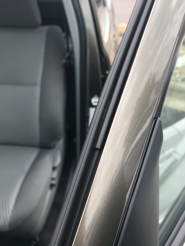

    I had the new door seals installed yesterday. I don't yet know if this will fix the crosswind noise, but I hope so. They're nearly identical to the originals in appearance and feel, but they have a ~1/8" rubber bead glued into the leading edge. It runs about halfway down the A pillar and about 1/3 of the way back on the upper edge of the door.

    L O FREAKING L..... toyota found my fix and made a new seal with the fix.

    Does the door require more force to shut now?

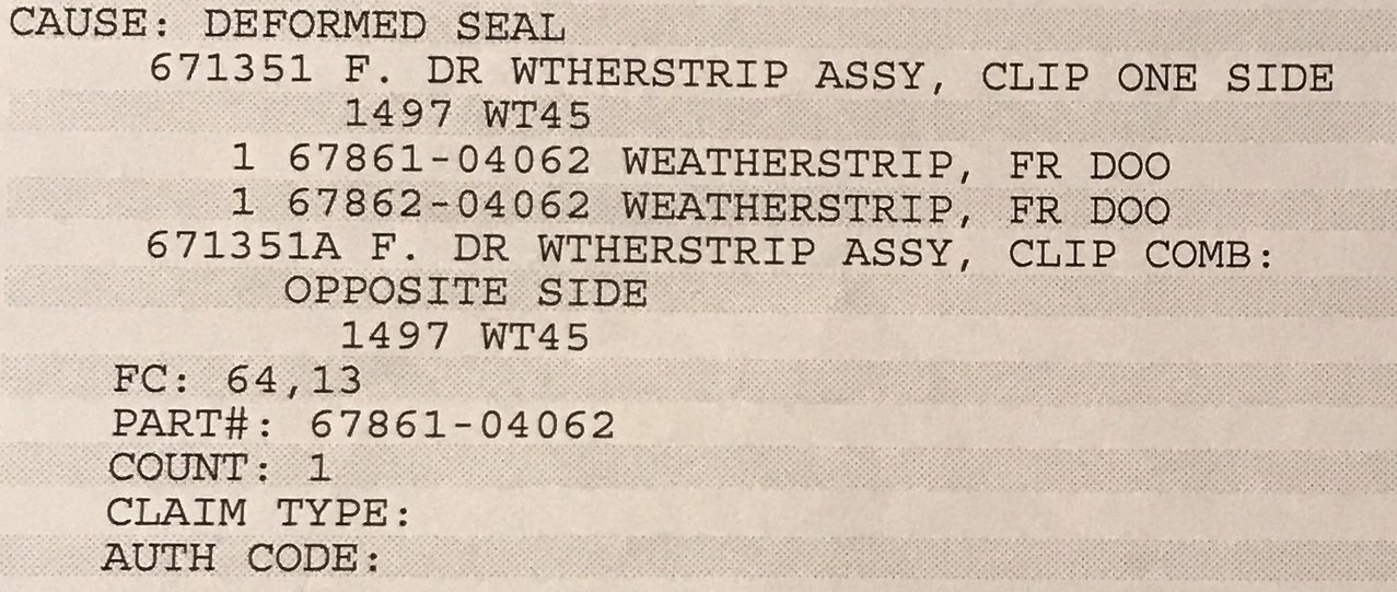

    Also, can you tell us the part numbers noted on your warranty repair sheet? This way members can buy their own parts to install.

    No, it takes no additional force to close the doors. Everythjng feels and looks the same as it did before, aside from the rubber bead on the leading and top edges. It might be slightly more quiet while driving, but I might attribute that to seals being new and not 3 years old. The difference is not remarkable.
    I'll update with comments when I get myself into a crosswind on the interstate.

    That's effing hilarious. It is completely nd4spdbh's fix! Well I'll stick with my EPDM foam strip and save myself a trip to the dealer for the official version of the fix.
    Thanks for sharing the photos and detail on the fix. Good they got around to the TSB and a fix. Also good to know for those out of warranty that $10 and 10 min with a trip to Home Depot will do the job as well!

    OP here. Just to update-- the new seals fixed the problem. I've probably driven 2000+ miles on the windy SD/ND/MN interstates since the new seals were installed. I haven't heard the cross-wind kazoo a single time. Success.
    Go get yer new seals, fellas.

    Update: the new seals have totally eliminated the kazoo crosswind noise.

    I like this part on the document:
    Cause: DEFORMED seal. Like the owner or daily opening and closing the door caused it to he damaged.
    Shouldn't it be: SHITTY DESIGN AND MATERIAL.
    The other fix that has had great success and is in one of the other related threads is 1/8 drip irrigation tube. I have at least 100 ft in the shed, but I always forget about this problem until the odd occasion when it happens.
