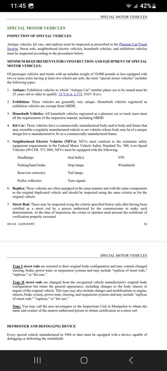

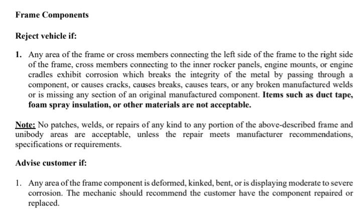

    This appears to be how they are rejecting it. You might argue it's not a, "patch, weld or repair".
    Maybe getting it reclassified as a Type-2 street rod will allow it to pass.
