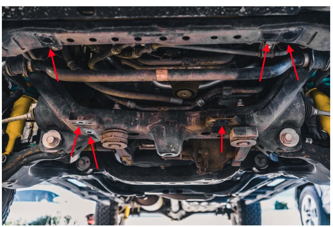

    Previous owner had installed a non OEM skidplate that fastens to the crossmembers near the front of the truck. It was extremely rusty, so I had it sandblasted and linexed. When they removed it the bolts were toast and were discarded.
    M8s are evidently too small, looking at pics, it seems the stock skidplate mounts to brackets that fasten into where my skidplate attached.
    I bought some toyota M12 bolts (90119-12369), which I was able to thread in a few turns before they bind up. I'm unsure if its right pitch, or if it's just really rusty still in which case I'd like to chase the threads with the correct size tap.
    Does anyone know the thread of these holes (see annotated random internet photo)?TacomaBoltHoles.png

    Just went through this a few weeks back. The smaller bolt holes are m8x1.25 and the larger holes are m12x1.25 both are considered “fine” thread and i had to buy from a specialty hardware store because I couldn’t find the correct thread & length together at a big box hardware store.
    I used m12 70mm & 65mm lengths for the front and middle bolts, the backs were m8 25mm.
    A few of the holes in my frame had a lot of buildup so I chased the threads with a tap before bolting my skid on.

    M12 x 1.25 tap worked great to chase the threads, 4 bolts go in easy now. Unfortunately the 2 bolt holts (just past lower control arms) thread to the third crossmember with smaller holes, and I found a broken bolt in one of them :mad:. It's a stud at this point... guessing it's not coming out easy if the shop just left it like that
