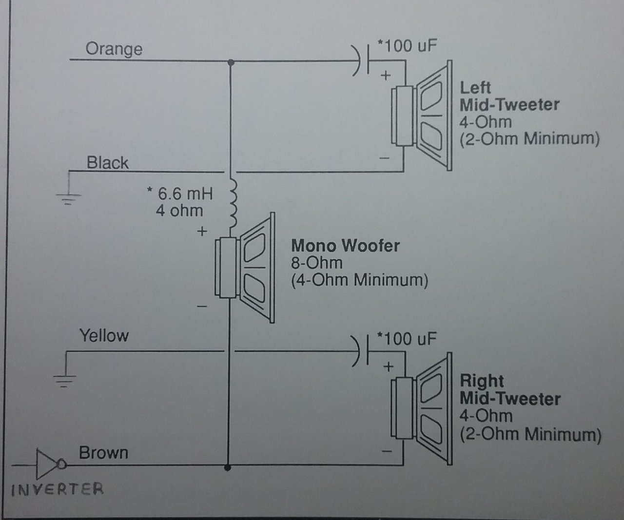

    1) Just a WAG, but maybe "Stereo And Mono Simultaneously".
    Here's an old Rockford Fosgate example.

    He is correct in “stereo and mono simultaneously”
    the wiring would be different than the Rockford diagram, but that’s a cool throwback to some old school tech!
    for most amps, you would do front left and right amp channels driving front left and right speakers, then bridge the rear channels to power a small sub.
