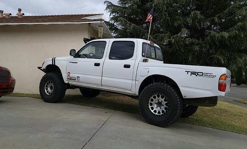

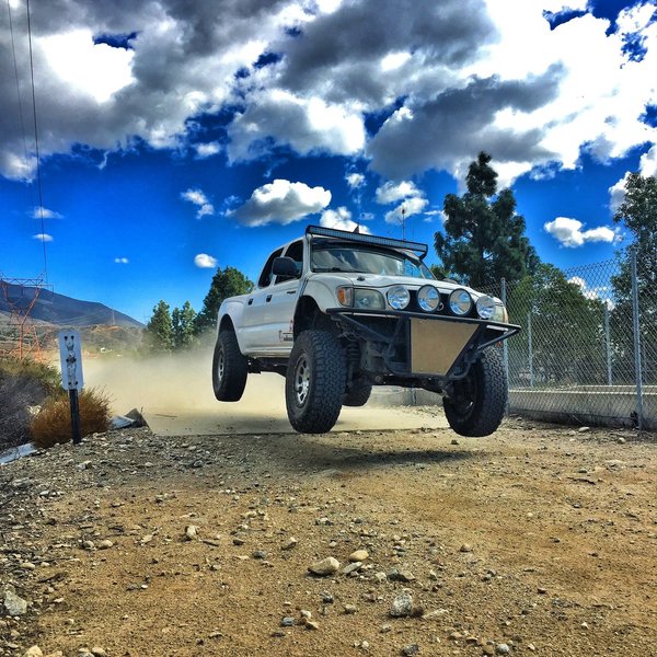

    How the truck currently sits:IMG_20171208_160643_154.jpg 0816171937c_HDR.jpg 1031171245_HDR.jpg 1202171055_HDR.jpg
    Old pics:[​IMG]
    [​IMG] [​IMG]
